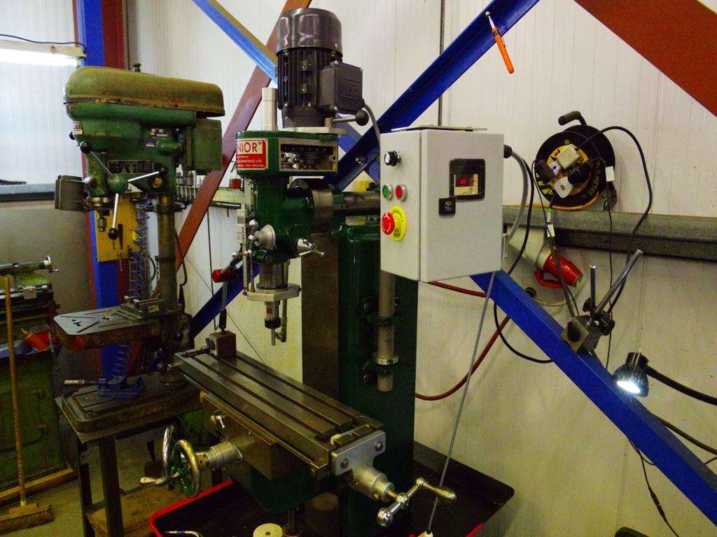

                  What I meant to say was that I bought a VFD with EMC compliance of C2 rating. This allows for up to 5 metre long cables. The domestic C1 is ment for up to 1 metre long cables. All of the cables were screened, the VFD to motor and the remote cables. The metal box for the VFD was fully earthed, including the door. Many domestic users buy the cheaper VFD’s without the EMC (electromagnetic compatability).
                  If you are going to carry out your own wiring, then remember to write down the motor speed and amps used, they may be required when programming.

                    I have had to resize this photo and hopefully it will show the VFD fitted to the Tom Senior mill. Since Itook the picture some years ago, we have proper mains sockets behind the mills. The drill is 3 phase.
                    IMGP0938-1024x768 ts mill
                    #779815
                    Robert Atkinson 2
                      @robertatkinson2
                      Very nice Old Mart. Good to see it done properly.

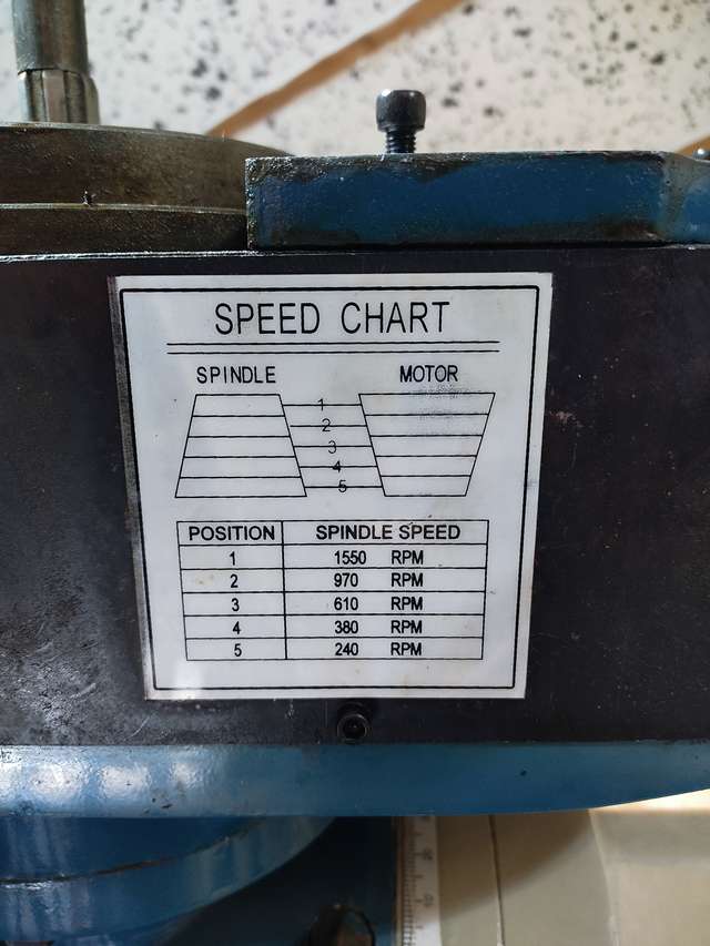

                        Well I have bitten the bullet and ordered the Mitusbishi VFD and pendant from Newton Tesla, with the intention of using my existing 4 pole motor. According to Newton the D700 range of VFD’s are rated to C3 EMC with “a degree of filtering built in”. They did offer a RFI filter to go with it for £22.50 which for the money I thought why not. No idea if it’s needed or not but it’s done now.
                        Here is the speed range and belt set-up as displayed on the side of my machine:
                        15
                        So if I use position 1 as the belt arrangement and increase the frequency of the drive to 90Hz, I should be in the region of 2600 rpm I think. Does that sound right? How does one determine the max frequency that can or should be used?

                          As that series of motors includes a 2 pole version that does 2800 RPM I think you are probably safe at 90Hz for the motor. It is difficult to get exact details of the motor as it seems to be a generic type sold by many companies.
                          The spindle is another matter you might want to check the ratings of the bearings.

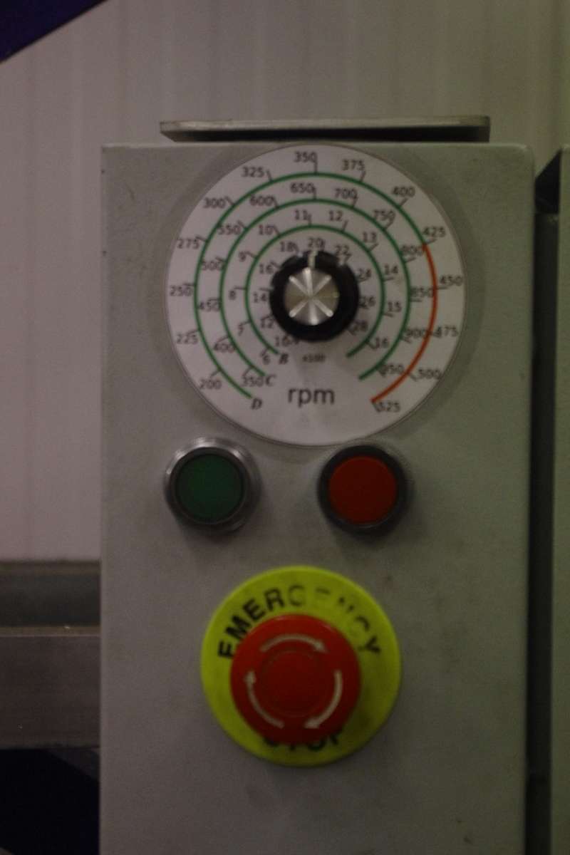

                            Starting with 50Hz being standard in the UK, then 90/50 X 1550 = 2790rpm and the same with the lowest speed assuming you chose 20Hz, then 20/50 X 240= 96rpm.
                            I chose 25 to 75Hz for the Tom Senior and haven’t bothered to change it so far.

                              Where did 1550 come from. There is always some slip, 4 pole motor on 50hz is normally quoted as 1475 rpm

                                  I was calculating from the spindle speeds chart on the side of Mark’s mill.

                                      I’m sure I must have missed some thing – but the spindle and motor chart seems strange. Its a 5 step pulley so step 3 should be about 1:1 ? If so then a 4 pole 50 Hz motor will be 1450ish RPM  and step 3 would be 1450ish . Where has the 2.4 reduction come from ? Is it a geared head ? Noel.

                                        Now you mention it, Noel, it does seem odd, an eight pole three phase motor would work the closest in that case.

                                                The most likely reason for wanting to use a slow speed would be if drilling a large hole. We have R8 to MT2 and 3 sockets which can hold up to 1 1/2″ drills, which need slow speed and power. Power tapping can have similar requirements. A large fly cutter, likewise.
                                                90% of our milling uses the top belt speed and 50-75Hz, but having all of the belt speeds is well worth retaining.
