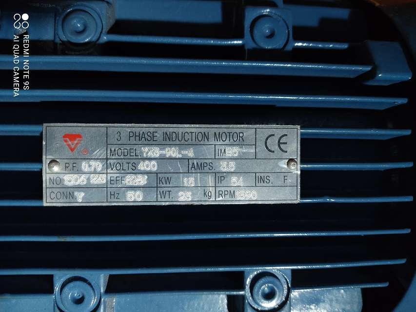

      Hello everyone,
      I have a 3 phase Baileigh turret style milling machine that I’d like to convert to use with a VFD via the single phase in my workshop. The spindle speed is currently determined by belts and pulleys, which I would like to get rid of…or at least not need and rather control the speed via a potentiometer. I was hoping for a max rpm of around 2500 if possible. Similarly it would be useful to have a jog function that operates in forward and reverse for use when tapping, therefore low rpm’s. The VFD I had in mind was the ubiquitous AT1.
      I was wondering if someone might be able to tell me if the existing motor on the mill would be suitable? I have tried to do some research on forums and YouTube etc but have come away mostly confused!
      9
      #778931
      DC31k
        @dc31k
        The motor data plate indicates 400v three phase, connected in Y (wye/star).
        To attach a VFD directly to that motor with no modifcation would require a VFD that outputs 380v three phase from a 230v single phase input. These are available as AT4 (not AT1).
        A second option is to locate the star point of the motor and reconfigure it to delta connected. This can be a more or less easy job depending on how the motor is manufactured. Then an AT1 VFD would work.

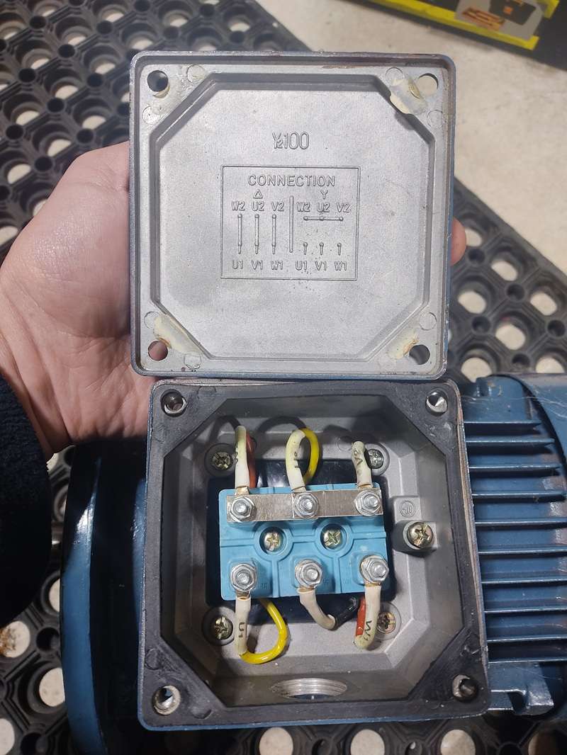

                  Take the lid off the junction box. If there are 6 connections with jumpers it can probably be reconnected as delta

                  Clive Foster
                    @clivefoster55965
                    If you simply connect a common 220 V nominal output VFD intended for use with a 220 v delta connection to a Y (star) 440 V motor maximum power will be approximately 60% of the nameplate rating.
                    Basically the VFD bus runs out of volts so it switches to constant power mode at about 29 hz,  just over 800 rpm.
                    Which may well be enough. Thats a 2 hp motor so maximum power will be reduced to 1.2 hp. I presume the mill is a Bridgeport clone, my Bridgeport has a 1.5 hp motor and has, so far as I can see, never run at anything approaching full power in my hands.

                      It looks like a new ish motor, so as Duncan says take the lid off the box and see if there’s 6 terminals – the ends of the 3 windings . If so change from star to delta. Good luck. Noel.

                        Whip the terminal box cover off and if there is 6 terminals its a 5 minute job to convert the motor from star to delta. But if you have only 3 then all is not lost, don’t concern yourself with over heating etc, that will come later. Locate an excellent article published on this site several years, describing with pictures how to locate the STAR point (connection) of your motor. Generally not a difficult job. Let us know how you get on . John

                              Mark Slatter
                                @markslatter13251
                                Many thanks again for all your help everyone, all your comments have been most helpful!
                                I had a look inside the motor junction box and found the 6 terminals as mentioned…that’s a win! it seems as though it’ll be a simple enough job to bridge the opposing pins to reconfigure as delta and use a 240V VFD. Although I could use an AT4 400V VFD, It seems as though there is more information available for setting parameters and trouble shooting with the AT1 version. I have emailed Newton Tesla and Transwave for a quote on a kit out of interest, but frankly I think I’d like to give it a go myself.
                                12

                                  Clive Foster
                                    @clivefoster55965
                                    Looks good. Nice and easy to re-configure to delta.

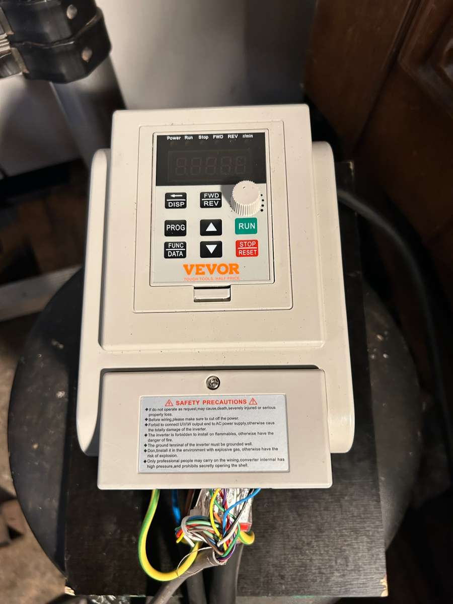

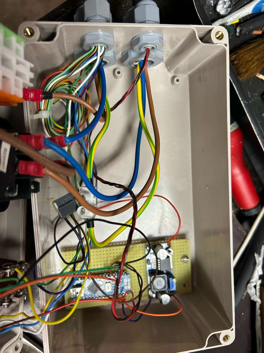

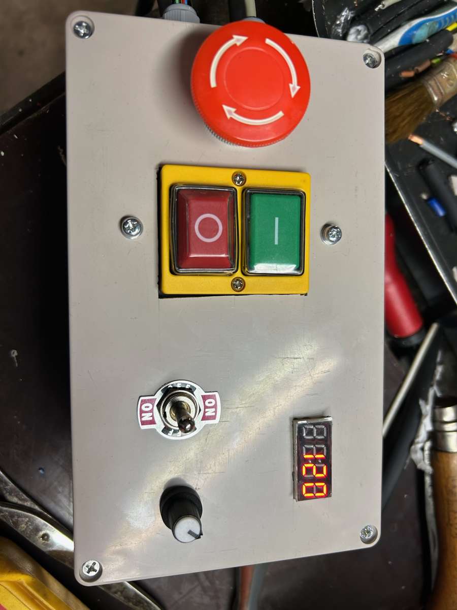

                                                    b2
                                                      @b2
                                                      Hello,
                                                      I’ve used the AT1 on my lathe. The Newton-Tesla solution is also very nice, but I couldn’t just justify the extra cost-up. My motor was a 1HP 230V (also 400V possible, as is yours). The VFD I’ve used is the AT1-2200X and I’ve added a separate box with safety switches, speed control and an Arduino based optical tachometer (which still needs further fine-tuning) to avoid swirls getting into the VFD. All works very well, but I’ve also kept the belt for torque reasons (in my case, I’ll keep the motor speed running at at least 800 rpm for cooling reasons, nominal speed = 1450 rpm). If you’ll need more information, feel free to ask.
                                                      br.
                                                      Wim
                                                      IMG_8002IMG_7999IMG_8003
