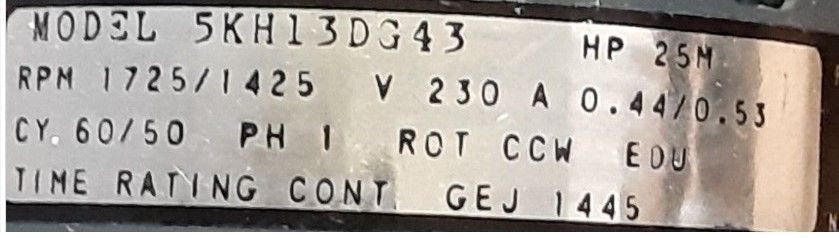

      I've been looking at an electric motor. In the HP section of the motor plate it says "25M" (yes, it is "M" and not "W&quot.
      Any idea what that really means?
      Andy

            This is the label. Not sure it really helps – there's no manufacturer and the model no does not yield anything on Google.
            I'm wondering if it's an odd decimal notation that signifies 0.025 HP – which would be ~18W

              50Hz 1425 rpm 230v ccw rotation, continous duty cycle.. 0.53a is odd and does not tally with .25Hp ? 180watt would be .25 Hp. Could it be ex military ? Noel.

                Posted by noel shelley on 05/09/2023 12:44:20:
                I agree.
                And my thought about being notation for 0.025HP doesn't stack up either!
                Andy
                #659216
                  Posted by Andy_H on 05/09/2023 16:02:15:
                  I agree.
                  But it's about right for .125 HP (Metric)
                  My guess is a stamping mistake – the plate is missing a decimal point and a 1
                  I expect an apprentice did it!

                    Just multiplying volts by amps gives 122W. O. 125hp is 95W.this implies 80%efficiency, which is on the high side for a fhp motor. BUT we've forgotten the power factor, real power isn't volts * amps for a reactive load.
                    I've no idea what 25M means.

                      I think I've worked it out.
                      I believe the "M" denotes metric horsepower.
                      That's the units sussed. As for the value I conclude it must be 0.25 but with the decimal point missing.
                      The quoted voltage and current product is 122W which implies about 66% efficiency.
                      Andy

                        metric Hp is Ps I think ? And a horse is a horse imperial or foreign ! I would fall for 0.125 Hp then the rest is about right. Noel.
