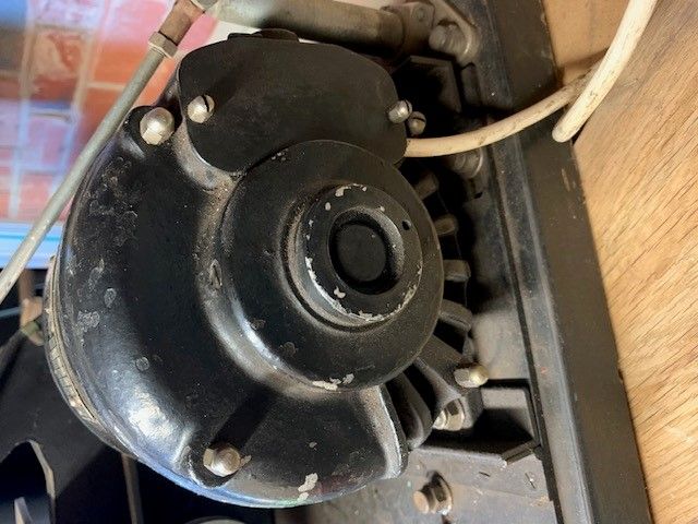

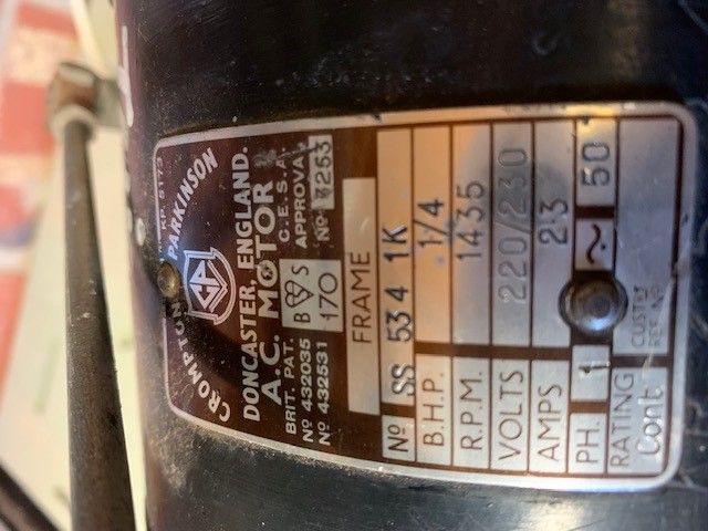

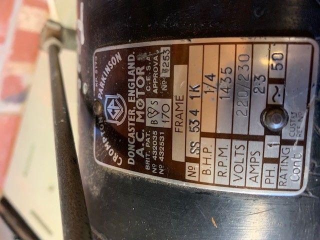

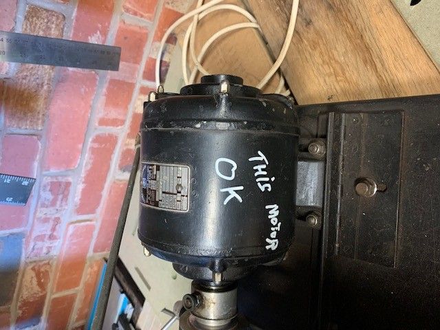

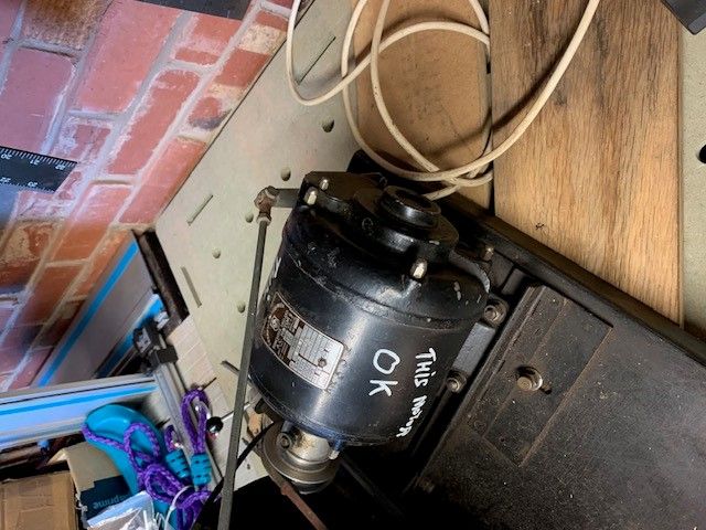

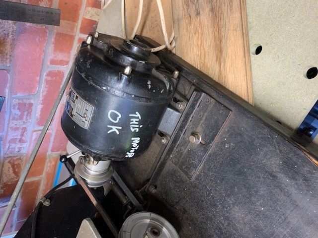

                        rating plate.jpgrating plate 2.jpgmotor 3.jpgmotor 2.jpgmotor 1.jpgburgess motor.jpg
                        Hi guys, I have attached some photos of the motor. Don't know why they are not the correct way up. Maybe one of the moderators can correct and possibly advise me where I went wrong. The photos were the correct way on my PC.

                          BK3 is a bandsaw model. Nothing to worry about ! From the pictures it doesn't use a start capacitor.! The motor is oldish so when working on it be mindful that old/rubber insulation on wires may disintegrate. A first step would be to check IF you have continuity on both sets of windings. For this remove the cover of the terminal block, NOTE WHERE the mains wires go. At this point you will need a multi meter or a friend with one to check that there is continuity on both the start and run windings. It looks as though there is a fault in the start circuit. A good picture of the terminal block will be needed if we are to guide you ! The centrifugal switch will be in the end cover where the terminal block is – Non Drive End. Noel.
