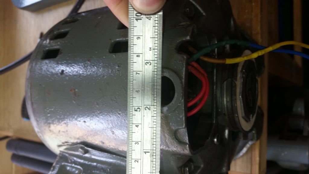

      Hi, I'm trying to locate a Gland that fits this hole and thread, rather than just jam a plastic one in there. Anyone got any idea's as to if they are available from anywhere? I'm having no luck locating one at all.

                                    Looking closely at the lower photo, the thread appears to be Ø16mm. A vernier or digital caliper could confirm this allowing for the thread size minus the thread depths and as Simon suggested, measuring the thread with a thread gauge would help.
                                    There are plenty of cable glands on the RS Components web site of 16mm …and other sizes of course.

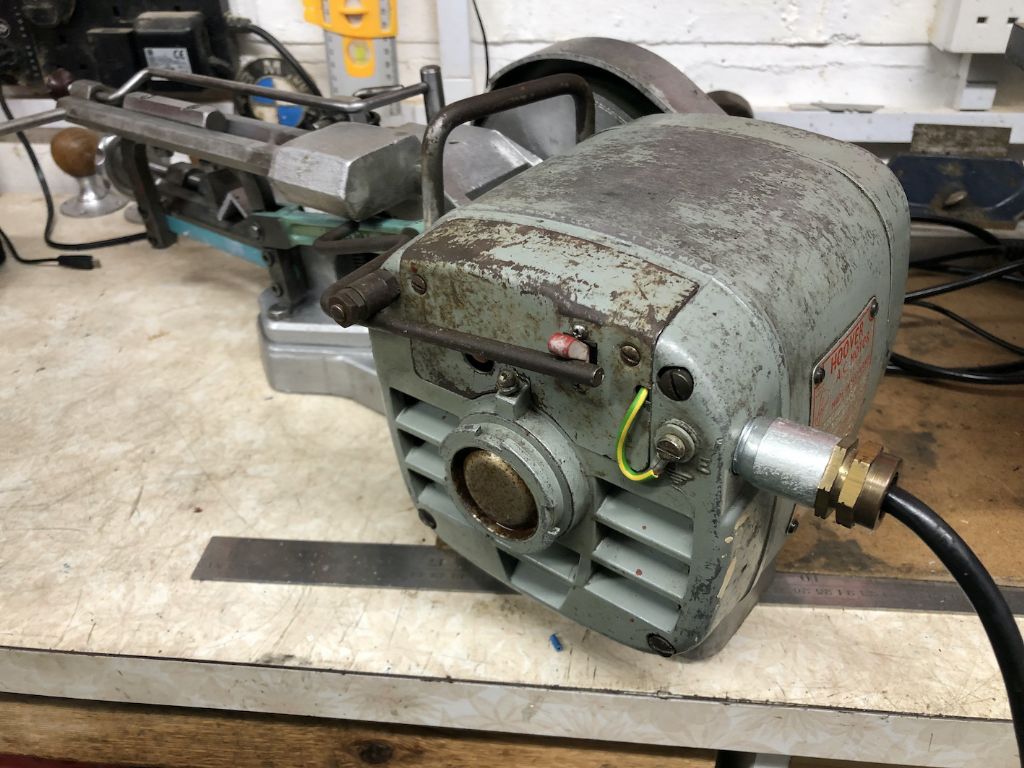

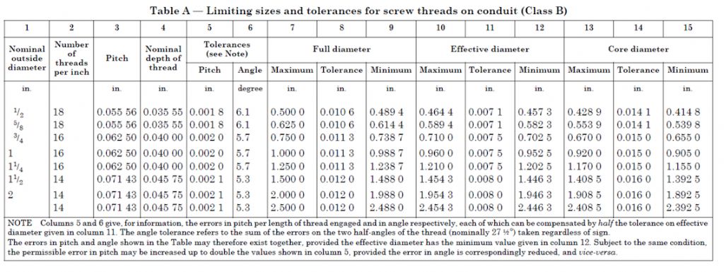

                                        I've managed to identify the gland thread size on my Kennedy Hexacut, Hoover motor, it's 3/4" conduit. I believe this thread is unique to the electrical trade and not a BSP or NPT thread.
                                        I obtained a 3/4" male to 20mm female adaptor and used a 20mm gland I had in stock to get the saw running. I would in the future like to make a gland to fit 3/4" conduit thread but until then this setup will suffice.

                                            Hope you shortened the male thread by a good bit or will be very close to terminals.
