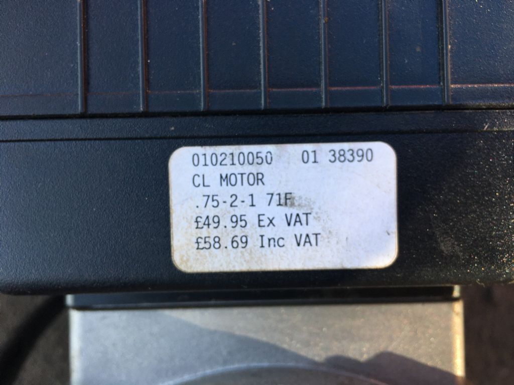

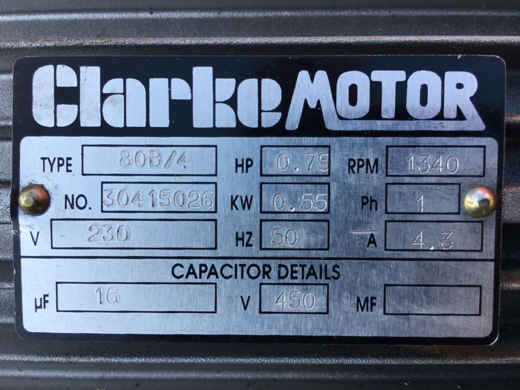

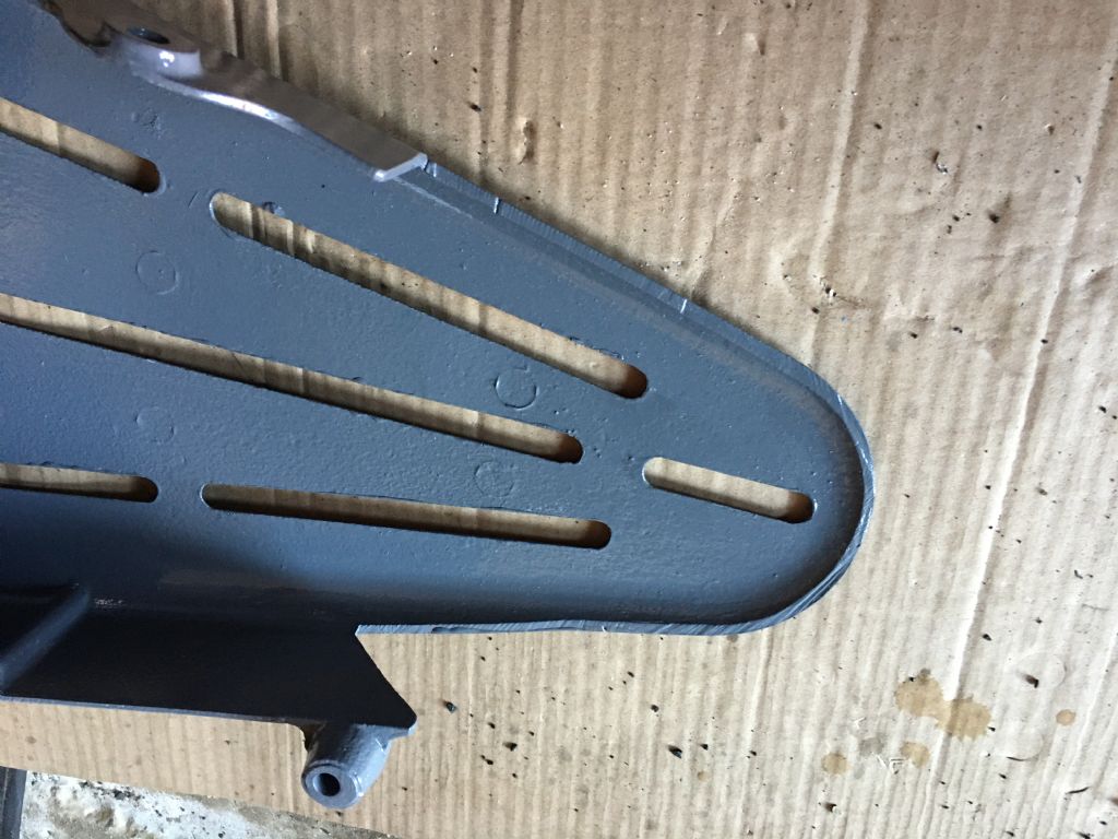

            I have a ML7 that has had a Machine Mart motor fitted. I'll just go and see what model, it still has the sticker on it. Guard had been modified to fit it though (but not a major job and it still covers the rotating bits unless you go and stick your hand somewhere silly) and extra holes were drilled in the mounting plate, although I think it could have been made to fit the existing holes if whoever did it had tried a bit harder

                Well that was reminiscent of another thread – having taken the motor off the lathe a couple of months ago so I could strip and repaint the lathe, it took me twenty minutes to find it again! Anyway, here are some photos of the modified guard and the Clarke motor.
                Looking at the price, not sure how long ago that motor was fitted!
