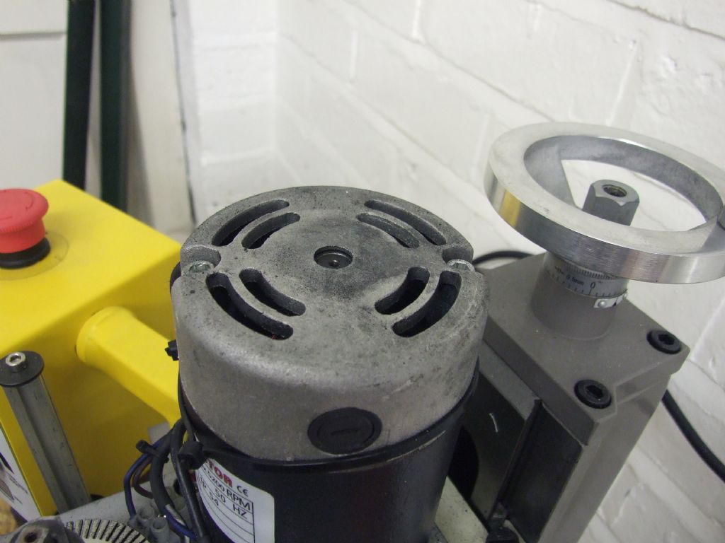

                          Brushless motors were not an option at the time I bought my mill regardless of how deep my pockets, I don’t have to justify anything to you least of all what I spend.
                          Hi Silly old duffer, my mill is used a few times per month; it’s used mainly for alloy and occasionally a bit of brass I build 1/6 scale RC tanks mainly from kit and either modify parts or scratch build them, I never mill steel or stainless the largest tool I use is a 13mm end mill but mainly 6,8 and 10mm with a .5mm cut.
                          If I’m going to be spending £300 on replacement motor and board then I’m going to be buying brushless as opposed to these motors.

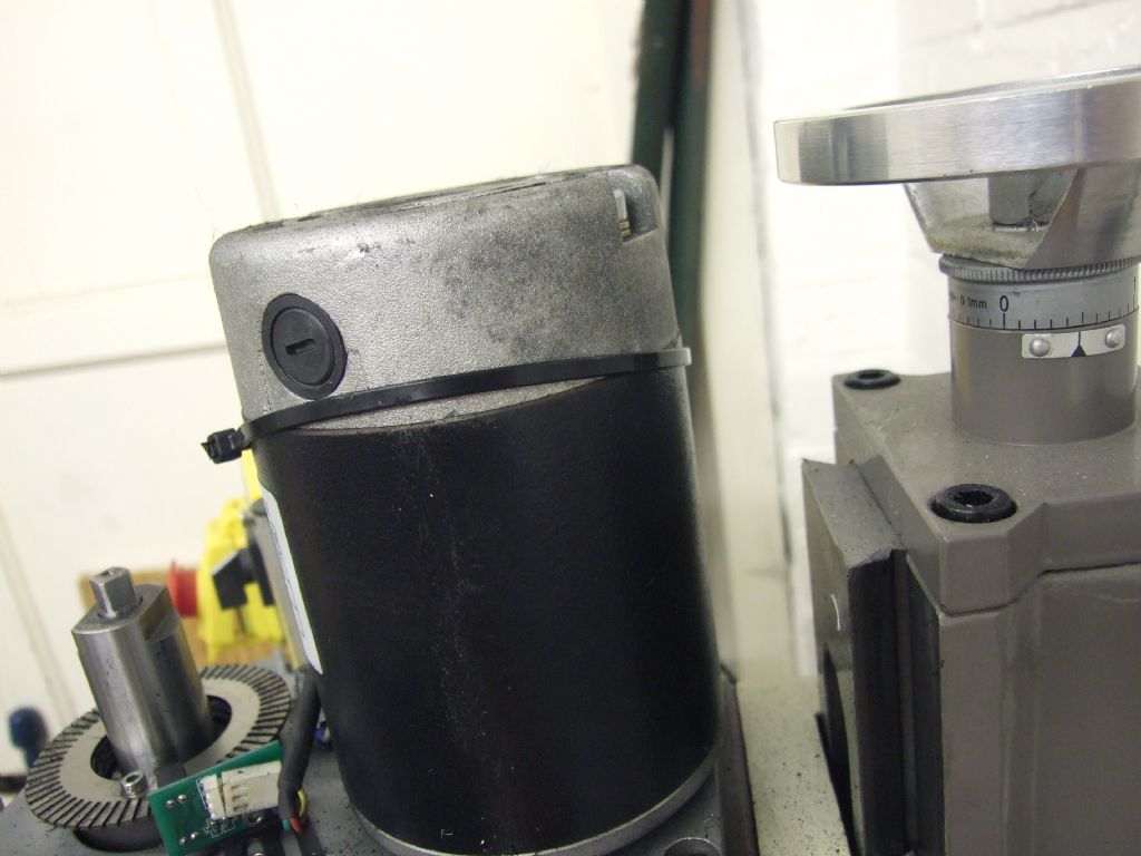

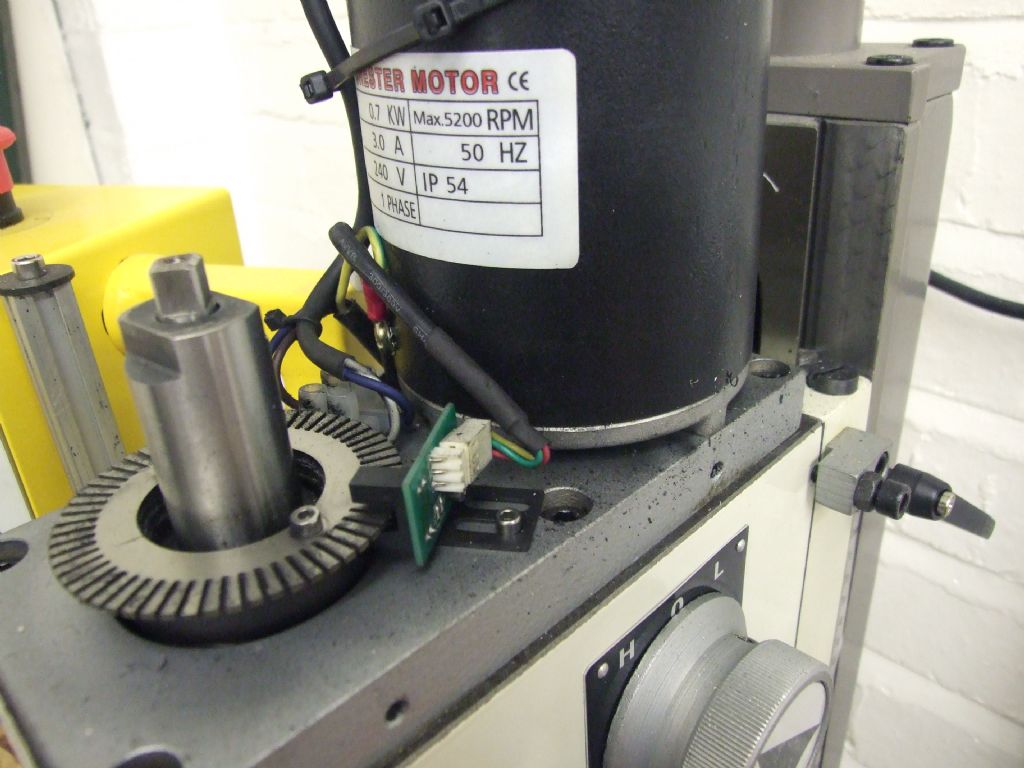

                            dscf0001.jpgdscf0019.jpgdscf8779.jpgdscf8780.jpgPictures of the original motor the latest is the same type

                              That is a DC motor with brushes. At 5200 rpm its no induction motor on 50 HZ.
                              A web site that I had a look at said that Chester removed the Chinese control board , and replaced them with boards made in USA.
                              Tony Durkin, Sales engineer at Chester Machine Tools has a forum on line where you can ask questions, and forward ideas.
