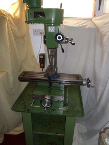

                                John Coates
                                  @johncoates48577
                                  Andrew
                                  Mine is a Chester Champion from the 90's with the round column, tilting head and reverse switch with a 1/2 HP motor like this one – is yours the same?
                                  I converted mine to 3-phase and have been very happy. When I get home after work I will check to see if I have the original single phase motor as I am pretty sure I put it away in a box.
                                  My first 3-phase conversion used the original cone pulley but I cross threaded the 5mm allen bolt in the end under power and buggered it up. So my next conversion used the keyway slot to secure a single pulley and discarded the cone pulley.
                                  Edited By John Coates on 28/03/2013 12:31:12

                                  ANDREW PARKER
                                    @andrewparker54292
                                    Hi John, yours looks very similar to mine other than the colour. Mine is white, the switch looks identical. If my motor proves costly to repair, assuming it is repairable, would you consider selling your original motor. If so let me know how much you would want for it including the cost of postage.
                                    Regards
                                    Andrew

                                      #115550
                                      John Coates
                                        @johncoates48577
                                        Andrew: mine is a white one as well. I didn't have a photo so used one I saved from an ebay ad to see if yours was the 90's version
                                        Happy to sell mine once I find and check it works

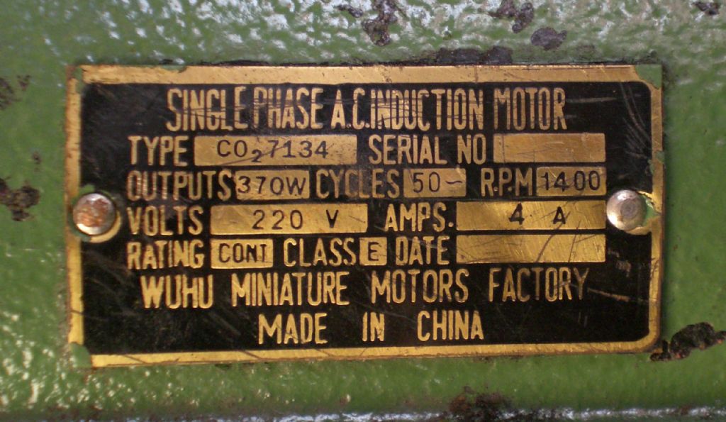

                                            Nicholas Farr
                                              @nicholasfarr14254
                                              Hi Andrew, the white ones have the same spec as the green one shown in john's photo. The scan below is from thier 2003 catalogue.
                                              Like Eddie I've had one for 15 years and it still has the oridginal motor on it. Below is a photo of the motor spec plate on mine.
                                              Are you sure you are not putting too much tension on the drive belt adjusutment, it should not be drum tight, you should be able to flex it a little with finger pressure between the pulleys. A tight belt can make the motor work harder and over heat as well as putting undue pressure on the bearings.
                                              Regards Nick.
                                              Edited By Nicholas Farr on 29/03/2013 12:16:04

                                                  @61962
                                                  Nicholas,
                                                  My motor spec plate is identical, no serial number, no date!!
                                                  I agree with the belt tension possibility, although it might be difficult to get one of these too tight given the tensioning arrangements. I'd been thinking about a new belt for mine since the tensioner is up to its limit and as been for some time, but at least it's easy to change speed now because I can just lift the belt over the pulleys without the need to slack the tensioner off. And no, the belt doesn't slip. I was taking the first cut with a milling cutter after changing over from drill chuck to milling collet the other night and the I thought the belt was slipping as the cutter almost stopped, but I then realised I'd forgotten to tighten the draw bolt. Doh! The slack belt takes everything I am prepared to throw at it – for the time being.
                                                  Eddie

                                                  Ian P
                                                    @ianp
                                                    Posted by John Coates on 28/03/2013 12:25:31:
                                                    Andrew
                                                    Sorry to resurrect an old thread but I have the white version of this Champion mill and I am filling up some time by putting it to first use. I bought it incomplete ex showroom at a Chester Engineering open day about ten years ago and it still has its coating of Chinese grease. The motor and some of the handwheels are missing so getting it operational should be fairly straightforward.
                                                    What I am curious about though is the 'CE' marking in Johns machine (mine has no such label) but the characters in the picture are mirror imaged, but the machine itself isn't!
                                                    Maybe this was a dodge to circumvent copyright (before 'China Export' became the explanation for CE)
                                                    Ian P
