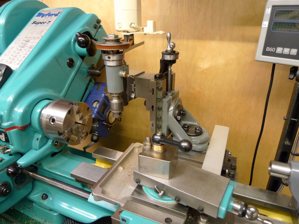

        Halfway through my latest tooling project, my thoughts are naturally turning to the next one. I fancy making a self-powered toolpost spindle setup to replace the one I currently use. I have in mind using a model aircraft brushless motor as a power source together with some form of speed control. The spindle itself is no problem – I will probably utilise my existing one attached to a mounting plate. As I know the square root of diddly squat about these motors, my questions are these:
        1) can I run one from a 12V car battery, for example? (I happen to have one lying around.)
        2) how would I control the speed?
        Alternatively, can anyone suggest a compact mains powered motor?

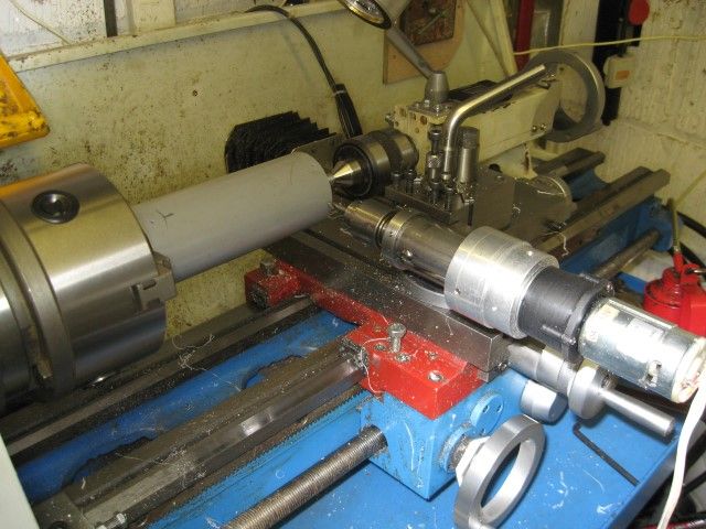

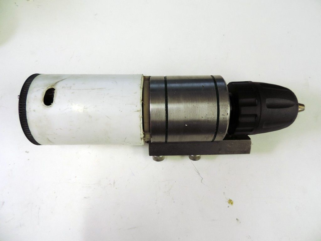

              Here's an idea for a basic toolpost drill/'light milling' spindle.
              The two-stage planetary gearbox from a battery drill installed inside the steel housing, new smaller chuck and a curry powder pot for a motor housing…
              Care was needed to fit the drill bearing into the housing without end play. Extended fixing bar reduces overhang. Bar is below the C/L of the housing so that the drill axis is on the lathe C/L.

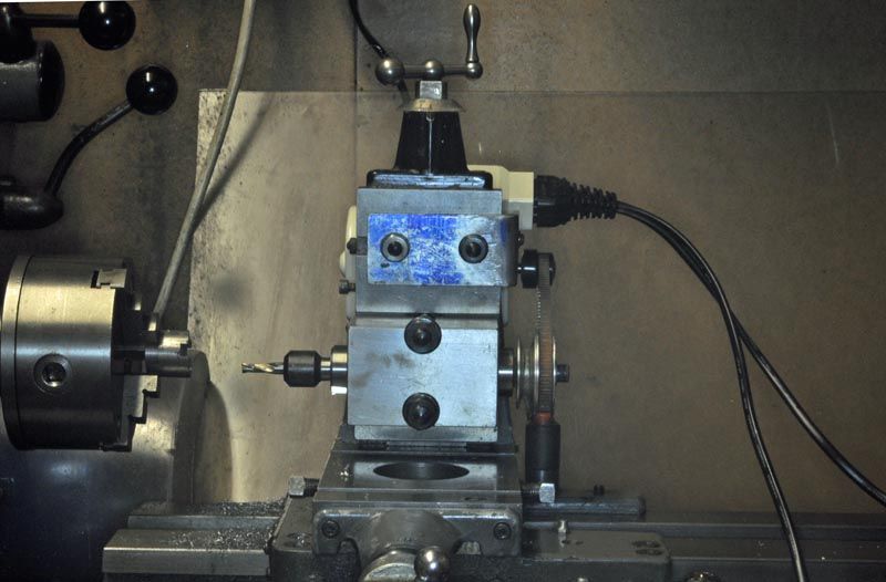

                  Les Jones 1
                    @lesjones1
                    My version using the same idea as Neil.
                    Les

                            These spindles are very similar to the one that already use – see my album – I just want to mount a motor on it, or alongside, to reduce flexing to a minimum, the mount the whole lot in place of the topslide. I have a number of mains motors of the pillar drill powering sort and one that was supposed to replace a knackered one in our central heating boiler. The latter is two speed, or at least I can wire it to run at two speeds, but physically, it's still a mite on the large side. I thought that a compact 12V motor might just fit the bill at minimal expense.

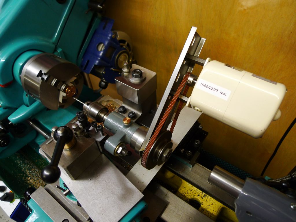

                              This is my current set up using a 120W sewing machine motor from here. No load speed of the motor is 20,000rpm, no load speed of the Arrand spindle is 4000. It will happily mill or drill up to 1/4" diameter in steel, when the speed drops to about 2500rpm, although this can be lessened using the foot control – which I didn't think I needed but turns out to be quite useful as a hands free on/off switch.
                              HTH
                              Rod

                                A sewing machine! Brilliant! And just the job. I'll see if I can find one when I get back – there's no time to get one posted to a UK address before we go home.
                                #154629
                                Roderick Jenkins
                                  @roderickjenkins93242
                                  John,
                                  Just watch out for the power rating – standard motors are only 90W.
                                  Cheers,
                                  Rod

                                      As the original poster, I can report that the 90W motor that I used is perfectly adequate for the intended purpose. OK, it's never going to let you rip great chucks of stainless steel off in one pass, but for the sort of work for which I use it, it's just the job! In fact, I was so pleased with it that I bought another one and made a mark two version, just for the hell of it! (Pictures in an album, if you're interested.)
                                      The first one turned out to be a little on the bulky side so I'm considering simplifying it and slimming it down to use just two interchangeable pulleys and fixed length belt to give two speeds. That'll have to wait until I've finished fitting the DRO scales to the mill.
