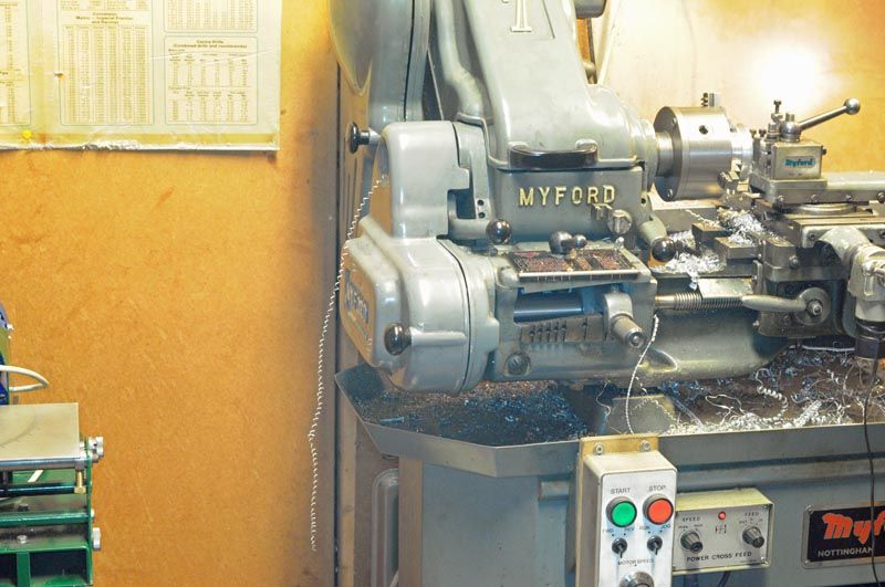

                            This is my favourite piece of swarf . While boring out a pulley it decided to feed itself through the lathe spindle and down into the swarf bucket which was on the floor next to the lathe.
                            Rod

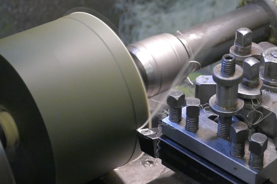

                                Lee, what I now do with plastic is mill as much of it off as possible before turning it to final size and shape. You can waste so much time repeatedly stopping and clearing the tangle then restarting otherwise. I can switch my A axis on my mill from stepping through to a position to continuous rotation and it comes in handy for this. Vacuuming up small chips is much easier than clearing a tangle of plastic. A recent job I did included this step and the final profiling had a step where a short stop after I was past the edge broke the tangle then the rest of the cut sent the ribbon flying in an arc like water from a hose and fell on the floor in an easy to collect heap. I took videos of this flow off the cutting tip but have not posted them anywhere yet.
                                For anyone who is wondering, I did not do the whole job on the A axis as, from past experience, the surface gets ripples that look like chatter if you do not get the RPM of the workpiece, the RPM of the cutting tool and the feed rate in the sweet spot. Leaving a machining allowance of 0.5mm – 1mm leaves enough for cleaning up to a smooth finish.
                                Here is picture of flying ribbon of swarf when cutting Oilon, this was just cleaning up the outside diameter and in the background you can see the tangle from facing the workpiece and boring the centre.
                                Martin C
