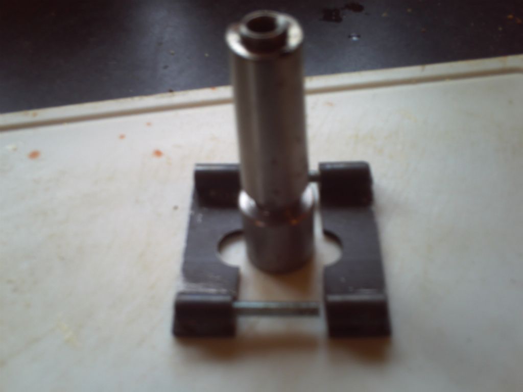

      Have any of you ever had difficulty removing open ended sleeves from Morse taper blank arbors ?

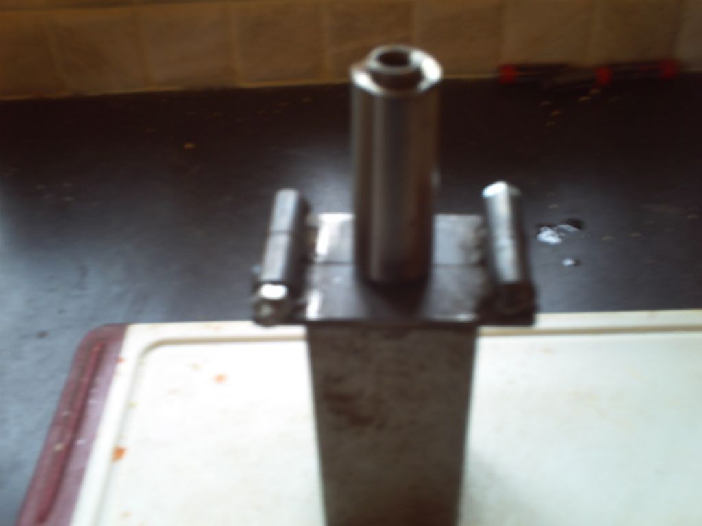

      Many times I have found it very difficult to remove them,without doing damage to the threaded end. I have come up with this idea,for what it,s worth. All I can say about it is that it works. I have posted a picture of it in my album [took me ages to do it ] All you need is a strip of flat steel about 60x4mm or 76x4mm or whatever you have to hand. All that matters is that it fits the gap between the sleeve and the arbor. Drill a hole to suit the dia at that point,then weld on two pieces of 12mm,long enough to cover the with of the strip you are using,having been drilled through 6mm. The whole unit can now be split to give two sections and a short piece of 6mm studding welded into one side of the unit.The studs pass through the other 12mm guide and are held there by two nuts.
      In use,the device is simply clamped around the sleeve/arbor,the whole assy positioned over the end of a length of box tube and a brass drift and hammer applied. The parts will be only too happy to part company,with no damage to either part.
      I found that for the two sizes of interest to us, hole sizes of 18mm and 23mm were OK.
      Sorry if this is Old Hat,but I found it to be like seeing "Light-at-the-end-of-the-tunnel"
      Over the years I found it almost impossible to separate some of these items and not having enough open ended sleeves,it became a total P-I-T-A
      Feel free to comment,good or bad,no offence intended,or taken !

          Hi Larry,
          All that matters is that it fits the gap between the sleeve and the arbor. ????
          Don't quite follow the above Larry. I can vaguely see what your doing, the split collar forms a rigid face which you drive wedge against but not how it's actually used.
          Now you have hang of posting pictures how about some more showing the clamp in use, I'd be interested

              Hi Geoff,
              Will try posting a picture but I,m not very good at it [like many things ]
              Think of it like this ; The whole idea is to prevent the outer sleeve moving when you strike the inner blank arbor with the drift.. There needs to be some means to prevent it from moving away with the arbor,and this is what the clamp does. It,s the same as putting two strips under the sleeve,trying to hold them there while you try to hold a drift and a hammer,all at the same time ! Not easy ! how do I know ? Been there,done that,too often !
              In use it is very simple; Take the clamp apart,bring it together again with the sleeve on topside and arbor on bottom side. Do up nuts hand tight
              Place entire assy either on top of vise jaws or better still on top of a piece of tube,round or box,makes no difference.
              I use box because I happened to have a piece to hand. With the tube sitting upright on the bench,there is no danger of the arbor dropping to the floor,and as they say "The rest is history"
              It,s so simple it,s silly but it works !cheeky

                Hi Geoff,
                I,m back again. I have posted some photos in my album [more by luck than anything else ] which should help to explain how this thing works.
                I want it mainly to deal with open end sleeves and to avoid causing damage to the threaded end of the arbor.
                By the way,,,, USE A BRASS DRIFT NEVER A STEEL ONE !.
                Hope this helps.cool
