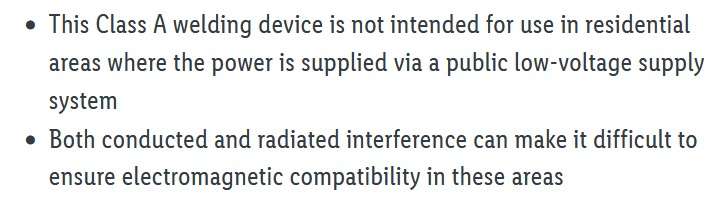

        Perhaps I’m naive, but I find it hard to believe that a large, respectable, EU-based retailer is really selling gear that will blow up your consumer unit, let alone bring down aircraft. Even if (and it’s a big if) their disclaimer protected them from liability, the reputational damage would surely outweigh the relatively small contribution to their profits from selling low-cost welders and plasma cutters.
        The bit about Class A would seem to refer to EN 60974-10 which you can download (without paying enormous fees) here:
        https://www.china-gauges.com/download/BS-EN-60974-10-2014-A1-2015.html
        The relevant bit starts at page 16. I have no idea whether it really has much relevance to such small machines – they mention input currents for testing of 25A for instance. Perhaps someone who understands the technicalities might like to take a look.

              Out of interest I asked Lidl customer service about this yesterday. Today I got a response saying that they comply with all GB nd EU regulations allowing them to sell in the domestic market. When I went to respond with a snip from the welder description saying otherwise I found that the web page had disappeared…..
              But I have a copy
              Welder limits
              I sent them a copy of that and await a response. I won’t hold my breath though.
              Robert.

                                              Well I actually bought the Parkside gasless MIG welder a month ago and from my practice pieces it seems to work ok, as has been said the operators skill is important and there are plenty of videos around to assist your learning.
                                              Never thought about interference from it, why would I as there are pages of bumf on the regulations it complies with? If I ever use it in anger I will report back.
                                              Tony
                                              The manual does say ‘not for commercial use’ and that the welder is a class A device that can be used in all areas except living areas and areas which are directly connected to a low voltage supply that (also) supplies residential buildings. It also does mention in detail about radiated interference. Also it is intended for use in an ‘industrial environment’. so confusing at best?
