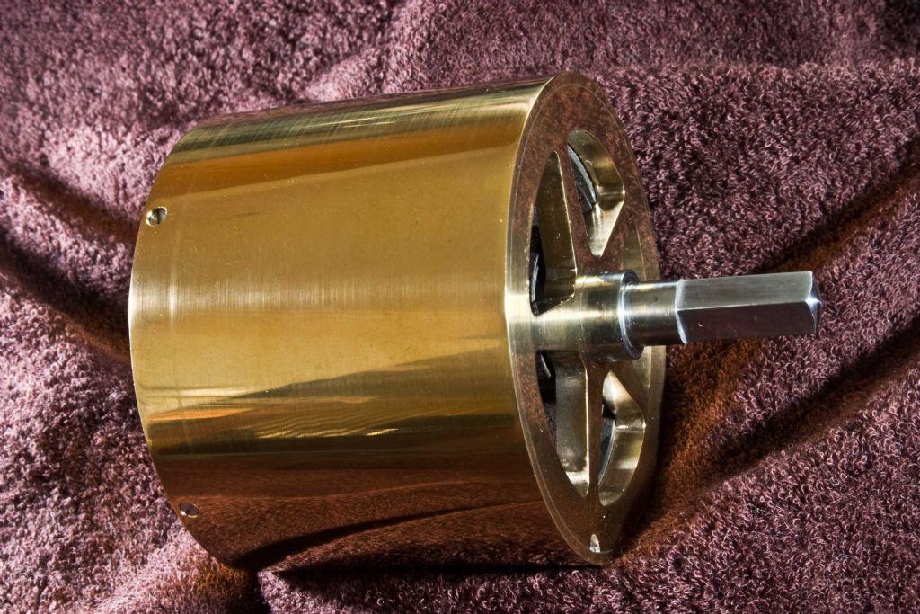

      Gentlemen,
      Although my skeleton clock has been running for many hours, there have been one or two occasions when it has stopped for no obvious reason. There have also been occasions when there is an abrupt rumble coming from the main spring. Although not clearly visible in this picture, for an idea of spring size, this barrel is about 60mm diameter, and 50mm wide.
      There is ample sideways clearance for the spring inside the barrel.
      I conclude that the main spring is sticking to itself thus holding back the necessary driving torque. A sort of stick-friction, or perhaps capillary action.
      In the initial `start-up’ a couple of weeks ago, I ran some sewing-machine oil onto the edges of the spring, and now wonder if the spring should be lubricated or washed in petrol and left relatively dry.
      There is also the possibility that over the 30 or so years the clock stood around, parts of the spring rusted.
      What are your thoughts?
      Sam

          Well on my first home made clock I had made all the pivots too precise a fit and I had to open up all the holes the old adage “if it rattles it will go” proved true in my case. Although you may of adopted the modern trend of using mini ball bearings in which case disregard all I have said.

            Sam Caution if you are using ball races it is all too easy get the gears ‘lumping’ by getting the gears too close together.
            It might be a good idea to ‘let the spring down’, take it out and examine it having a good look for rust and rough surfaces. As you wind the spring up the surfaces can gripe instead of sliding over each other.

              I believe it is usual to apply some oil to the edges of the spring as you say you have.
              A 2″ wide spring  – that is a big beastie – if you are going to remove it do you have a spring winder for  when you come to replace it?

                      Sam – I fear the griping is caused by the dreaded ‘Tin Worm’ (Rust). Let the ‘spring down’ by removing the escapement, but watch it as it can run fast.
                      Remove the spring from the casing and inspect it. If the spring is very bad try to get a new one. You can try to remove the rust with a rust remover (or WD40 and a wire brush) clean up with 350 grit paper (the stuff car bodgers use on body work) and finish with the finest paper (and oil) you can get. Remember the final polish is done with the oil & spent grit on the spring using the back of the paper. I would then re-blue it.

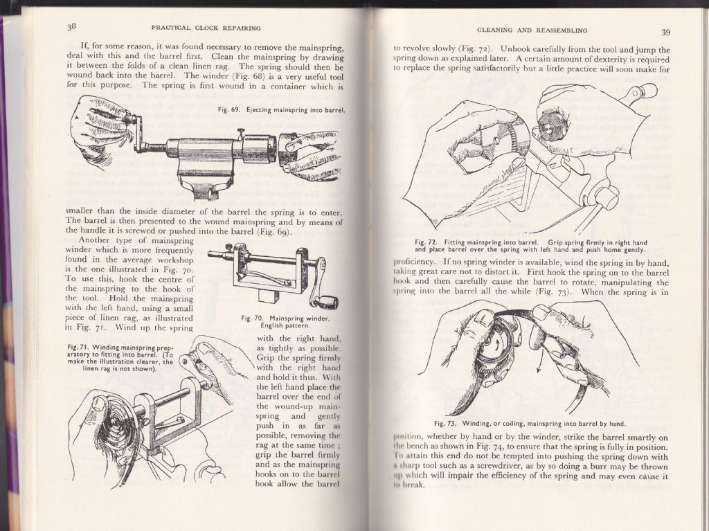

                      The Gizmo for £600 is the professional unit for using all day every day. I have attached two pages from ‘Practical Clock Repairing Donald de Carle FBHI’. He shows you how to reload a spring. The last time I did one I used the Myford, a mole wrench (self locking tongs) onto the jaw to stop ‘run back’ and a small pate tin -smaller than the spring’s drum with a slot cut down one side (A good thick rag is just as good.)

                        I have made my own spring winder it is to John Wildings design modified so that I can use European style cylinder spring retainers, the best of both designs I think
                        You can see it in action on my website
                        But if you have a lathe you can also use that with a bit of fiddlerling
