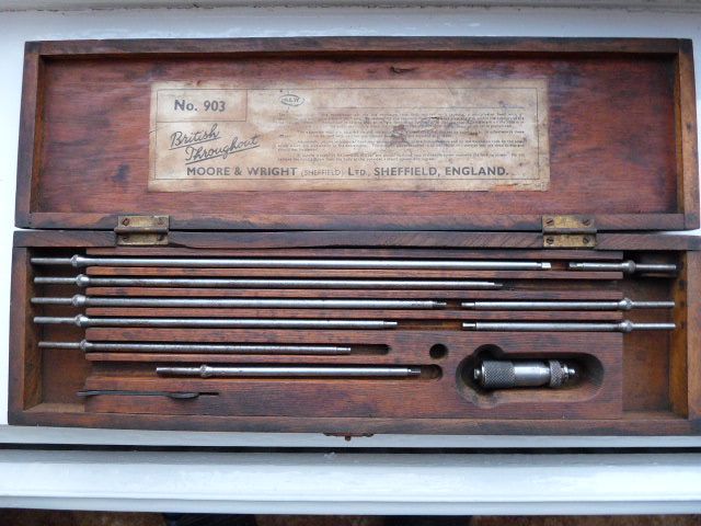

      I recently bought a M&W 903 inside micrometer at a market / boot sale.
      I think there are at least three parts missing: The handle, a collar that holds the measuring rods in/on the micrometer part and a screw that goes in the side of the micrometer barrel. They are shown on model 903s for sale.
      Can anyone show me how to assemble the micrometer for use? The instructions are not clear. Does anyone know how I should make the missing collar(?)

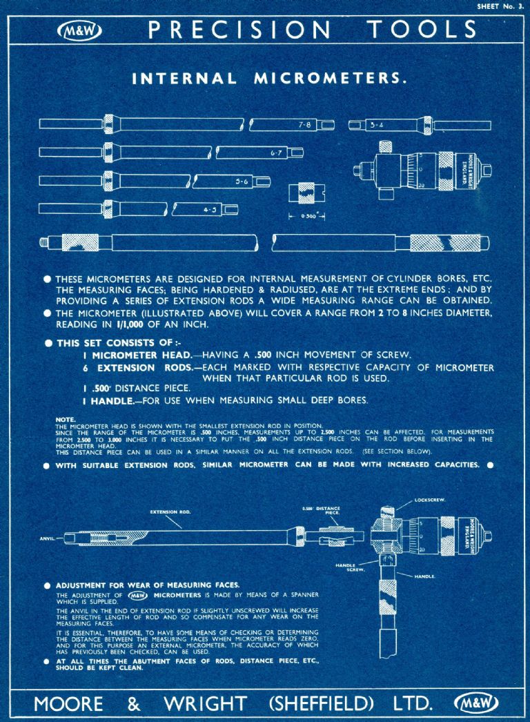

            Hi Peter, as George says the collar is hardened and ground and it is called a "distance piece" and should be exactly 1/2" long, all the rods are full inch's long and the barrel moves 1/2" therefore you use the distance piece to make up the different lengths when needed, i.e. the smallest measurement is 2" to 2-1/2" put in the distance piece and you get 2-1/2" to 3" etc. The scan below should help.

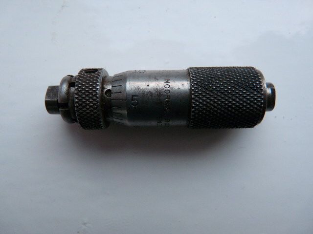

                  This is what I have got. I don't see how to connect the rods with the micrometer part.
                  I know one rod is missing and I have two the same.

                        If you look at my latest album, there is a picture of my M & W 903.
                        The previously posted picture of the instruction sheet (blue ) should make it's operation pretty clear.
                        Suggest that you print it off and keep it with your 903.
                        Slackening the small knurled knob on the micrometer barrel allows the anvil to be withdrawn, so that another can be put into it's place, before retightening the knurled knob.
                        The small knurled sleeve is 1/2 inch long, and can be slipped over the stem of an anvil to extend the range of measurement by 1/2 inch (The micrometer barrel only covers 1/2 inch, so it is needed )
                        The Handle screws into the tapping opposite the small knurled knob.
                        The smallest internal dimension that it can be used to measure is 2 inches.

                            I think I see the problem looking at your setup.
                            1) I don't have a knurled screw on my micrometer body just the hole for the handle. Also my micrometer body is not plated.
                            2) The removable Anvil for 2 inch measurements screws into the main body so when I unsrew it the hole is too large for the extension bars and is threaded internally.

                                Hi Peter, I don't think you have the correct mic for those rods, it should like like the one in Howard Lewis's album that he referred too. The instruction sheet refers to the 902 set, which only has the six rods, the 903 has 12 rods, but the mic is the same for both of them.
