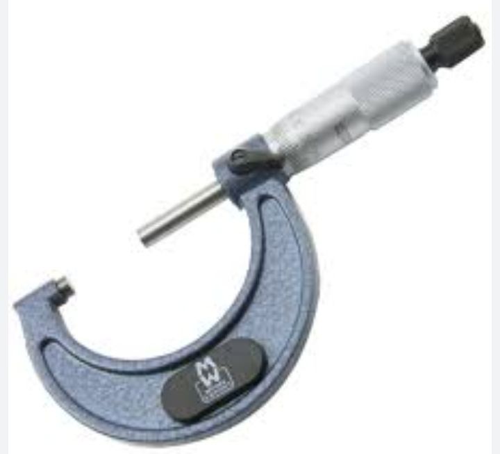

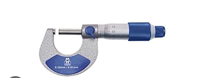

                            moore and wright still make most of their mechanical micrometers in Sheffield, the top picture is their top of the line model made in Sheffield, the second down is their middle range model which is made in Sheffield and the bottom picture is their budget model made in the far east.
                            It's unfair to say they don't make good quality tools anymore because you cheap out and choose their budget models.
                            Edited By Pete. on 21/02/2023 00:36:13
