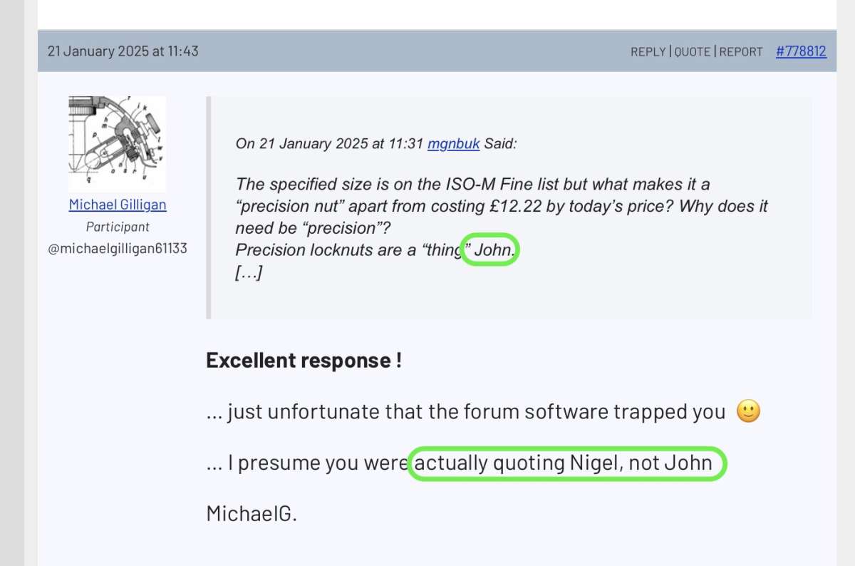

                  #778812
                    On Ex contributor Said:
                    The specified size is on the ISO-M Fine list but what makes it a “precision nut” apart from costing £12.22 by today’s price? Why does it need be “precision”?
                    Precision locknuts are a “thing” John.
                    Excellent response !
                    … just unfortunate that the forum software trapped you  🙂
                    … I presume you were actually quoting Nigel, not John

                          #778827
                          Ex contributor
                            @mgnbuk
                            Not quite sure what you are getting at here Michael ?
                            Your quote from my reply is not what I am seeing here – I quoted from John’s comment & italicised it to show that was what my response was to. My reply as written (and displayed on my pc) has a clear seperating line between it and the quote and is not in italics, not as shown in your quote ? Maybe I should have put an apostrophy after “thing” and before John ?
                            Whatever – I am Nigel and I was quoting John, if that makes things clearer ?
                            Nigel B.

                                #778833
                                  Your quote from my reply is not what I am seeing here – I quoted from John’s comment & italicised it to show that was what my response was to. […]
                                  No you didn’t Nigel
                                  That was my point
                                  You were actually quoting from post #778777 by NigelGraham2
                                  Edit: __ Hang the expense … let’s have a clarifying screenshot
