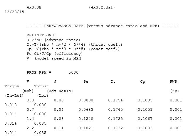

        @turbineguy
        Hi Robert,
        I followed your link and read the report. This is similar to the way I find the power using propellers with performance given for various speeds. The following is a portion of the performance sheets given by APC for the 4×3.3EP propeller I use for testing with steam. The performance is given for several speeds and, as I noted in my test sheets, the power coefficient is the same for speeds ranging from 5,000 rpm to 10,000 rpm. With the assumed air density, propeller diameter, and power coefficient remaining constant, the power is proportional to the cube of the speed. Since the static power given by the table is approximately 0.77 watts at 5,000 rpm, the power at speeds up to 10,000 rpm can be found by the following equation.
        P=0.77(N/5,000)3
        Where: P = Power required to turn the propeller at the speed N, watts
        N= Propeller speed, rpm.
        APC 4x3.3E

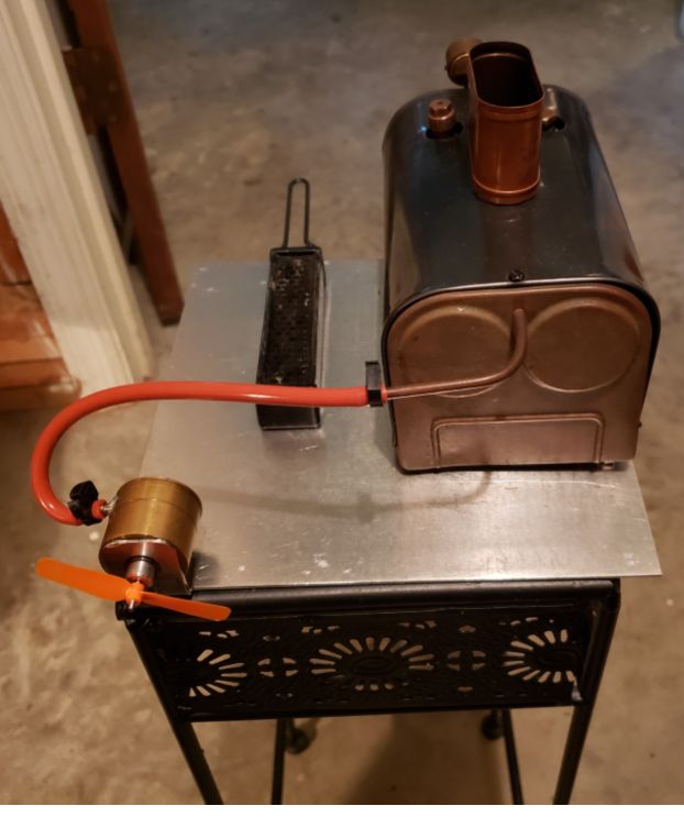

        #475882
        Turbine Guy
          @turbineguy
          I decided to try to fix the relief valve on my smallest boiler. I used the methods I discussed in the post of 25/03/2020 in this thread shown in this link https://www.model-engineer.co.uk/forums/postings.asp?th=140195&p=8. The repair of the relief valve was a complete success using these guidelines. The boiler does not leak any steam until the relief valve starts to open at about 32 psig. Before repairing the relief valve it was starting to leak before the boiler reached 20 psig. The following picture shows my Turbine 2 connected to this boiler and the wick type burner I use. As you can see in the photo, there is no stop valve used, so the turbine inlet gets almost the full pressure of the boiler. For the test I ran after fixing the relief valve, I did the following. I put a carefully measured ½ cup of water in the empty boiler. I added the ball bearings I’ve been running with Krytox GPL 105 oil in my turbine after adding a slight amount of this oil to each bearing. I then filled the wick burner with denatured alcohol, lit it, and set it in the boiler. It took a few minutes for the steam to start coming out but then reached the maximum pressure of 25 psig in a short time. The pressure remained constant until the boiler ran out of water in approximately 12 minutes. The turbine speed took several minutes to reach it’s maximum speed of 17,000 rpm but held approximately that speed for the rest of the test. The mass flow is 1.30 lb/hr and the power required for the GWS EP 2508 propeller I used in the test is approximately 0.9 watts at 17,000 rpm. The mass flow was about what I was getting running my turbines on the small boiler before the relief valve started leaking. The power was less running on steam from my small boiler than what I have obtained running on air with Turbine 2 (0.9 watts vs 1.4 watts). I’ll see if I can explain the lower performance in my next post.
          Turbine 2 Steam

                Turbine Guy
                  @turbineguy
                  I ran a test with my smallest boiler and the cast axial rotor to see if the steam output of the small boiler was part of the problem. I used this rotor since the position can be adjusted to allow space for the steam to go supersonic before contacting the rotor. The ability to do this has made this rotor perform better than my tangential flow rotors with steam even though the open pocket rotors have done better on air. I added a carefully measured ½ cup of water to the empty boiler and placed the lighted wick burner in the boiler. I started my stopwatch after the steam started flowing from the turbine and noticed it took approximately a minute to reach the maximum pressure of 25 psig. The pressure stayed at 25 psig for the total time of the run. The boiler went dry after approximately 9 ½ minutes. There was a large drop in speed for a few seconds that indicated a slug of water got into the steam line. The resultant mass flow is 1.64 lb/hr but the carried over water invalidates this result. The maximum speed obtained was approximately 18,000 rpm and the vibration was fairly high even though this is my best balanced rotor. This indicates that the bearings may be the problem. I will change the ball bearings and see if I can get a run without water getting into the steam line.

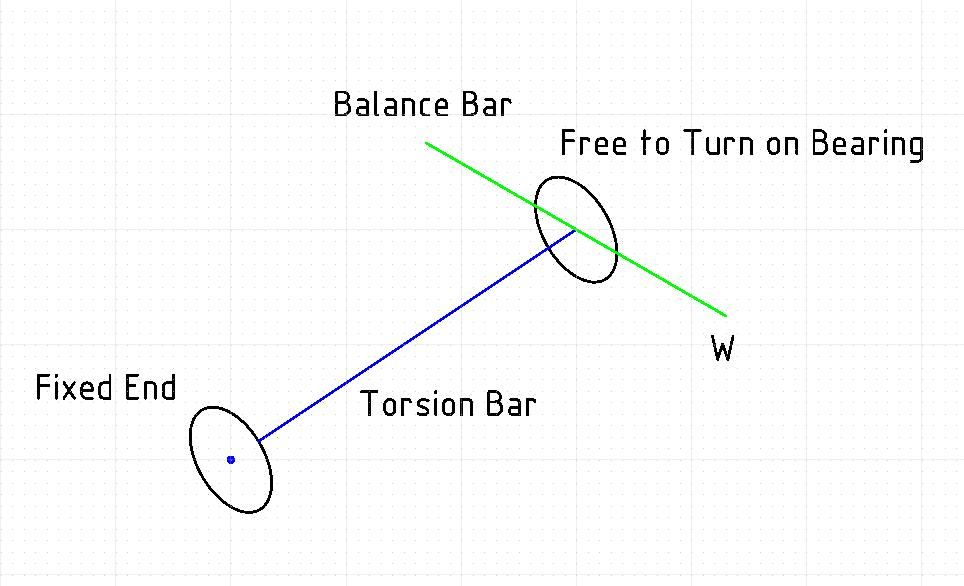

                                                #494914
                                                  Posted by Mike Tilby on 09/09/2020 13:45:08:
                                                  Posted by SillyOldDuffer on 07/09/2020 21:05:33:
                                                  On thinking about the torsion type dyno I am not sure how I would easily measure the angular twist accurately when the shaft is stationary – while keeping the loaded lever dead horizontal. …. Nevertheless I'd still be very interested to read your article. I looked for an index to MEW but the only one I can find does not cover anything more recent than 2016.
                                                  I'd be interested to hear if you find that book. Parsons designed his dynamometer very soon after the first trials of Turbinia had been carried out in 1894.
                                                  Regards
                                                  Mike
                                                  Can't find the magazine or the book, which I'm sure is much later than 1894 so Parsons is the man. Talented chap!
                                                  Anyway this diagram shows how I measured the elasticity of the torsion bar (a length of piano wire):
                                                  One end of the bar is clamped while the other terminates in a free to rotate disc. A balance bar is glued to the disc and adjusted so the torsion bar is unstressed, ie the two ends of the balance bar are at equal height. Then weights are added at point W causing the torsion bar to twist and the balance bar to dip. The angle can be measured directly with a home-made protractor, but I calculated it with trigonometry.
                                                  It gives the elasticity of the spring, from which the force needed to deflect through a measured angle can be calculated. From unreliable memory I think the torsion bar must be at least 40 times longer than its diameter.
                                                  Still looking for the magazine. As I can't find any mags containing my articles, I must have put them in a safe place and forgotten where it is.

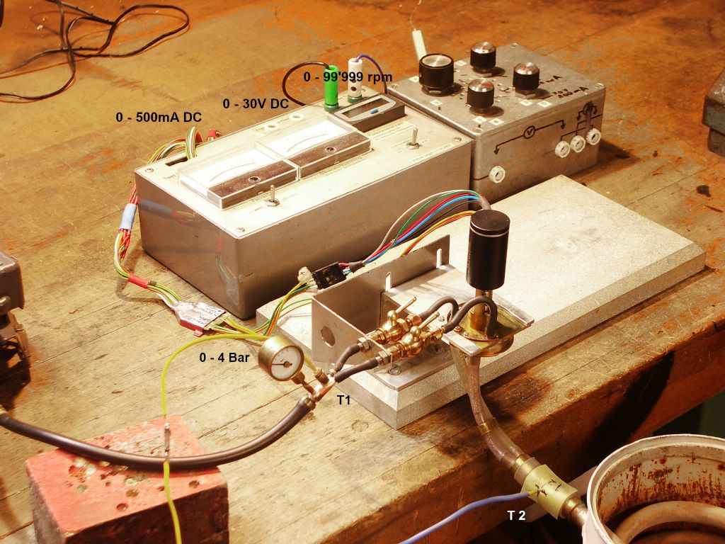

                                                    Turbine Guy
                                                      @turbineguy
                                                      Posted by Werner Jeggli on 18/06/2019 16:59:16:
                                                      Werner Jeggli shows in the post of 18/06/2019 the picture of the system he uses to measure the power of his steam turbines. He uses the brushless DC servomotor as a generator and can change the resistance to alter the load on the turbine. This allows him to run the turbine at any speed and measure the maximum power at that speed. This is the biggest short coming of using propellers for a load. The torque of the turbine determines the speed it can spin the propeller. What makes this even worse, is the very small number of propellers available with test data showing their performance at low powers and high speeds. Because of this and his distrust of extrapolating results, Werner has described my method of testing as “woefully inadequate”. I believe that if you are primarily interested in finding the maximum performance at a particulate speed or range of speeds, you do need a much more sophisticated test method. Either Werner’s method or the use of a torsion type of dynamometer would substantially improve the testing. I do believe that using the performance of a propeller given at a speed within a tested speed range is valid and if it meets your needs, is far simpler and less costly.
