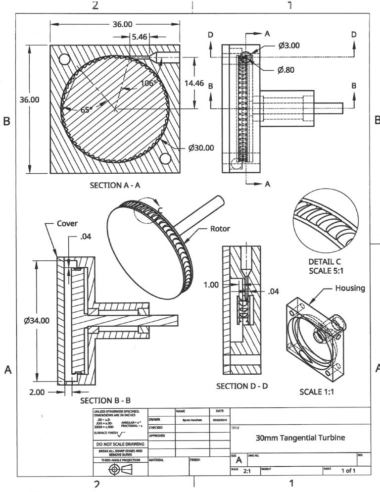

              Hi Werner,
              Thanks for trying to defend my design. Your link worked find for me and your test sheet showed you were able to get the 10 watt power you thought you could obtain. Your existing rotor design with the wider opening relative to the edge thickness might be one of the major reasons for its success. My design would require razor sharp edges and very smooth surfaces to obtain maximum performance. In one of my earlier posts I wondered why Jim Bamford changed from axial to tangential flow. I made the following solid model to illustrate how easy it is to get unobstructed flow in a tangential turbine. I think this might be one of biggest advantages for the overlapping pocket design of my tangential turbines.
              30mm Tangential Turbine
              #424914
              Turbine Guy
                @turbineguy
                The following drawing shows the dimensions that I consider important for the design described in the previous post. The 5.46mm dimension shown in section A-A should be kept as short as possible to limit the friction losses of the supersonic flow. The 106 degree dimension shows about the practical minimum for the flow to not blow over the overlapping pockets. Since the flow deflects about 6 degrees with nozzles of this type the effective nozzle angle is about 22 degrees. The angle of 65 degrees yields a 25 degree pocket angle which is about right for the 22 degree nozzle angle and speeds around 30,000 rpm. The 0.04mm dimension in section B-B, and the 0.04 and 1.00 dimensions in section D-D are approximately what I had in my last turbine. The rest of the dimensions show the size of the parts and recommended clearances. The nozzles and rotors machined out of aluminum or brass have resulted in very smooth surfaces using common drills, mills and turning tools.

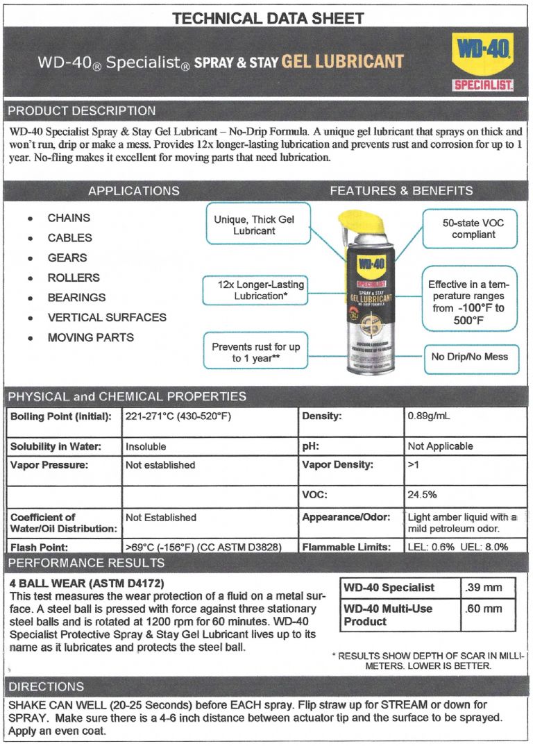

                  A few days ago, I sprayed WD-40 into the ball bearings that had been gummed up by running my turbine on steam. I flipped the propeller with my finger and it spun fairly freely but there was some noise that wasn’t there before I ran on steam. I connected the air line from my airbrush compressor and ran the turbine with the same 1.65 bar air pressure I have used for all my tests with air. The maximum continuous speed obtained was 17,800 rpm with an estimated power of 2.2 watts. This was quite a bit less speed and power from the 3.9 watts at 21,500 rpm I got from this same air pressure before running the turbine on steam. The reduction in torque was approximately 5.6 g-cm. The torque at 21,500 with this pressure was 18.7 g-cm so the loss was very substantial.

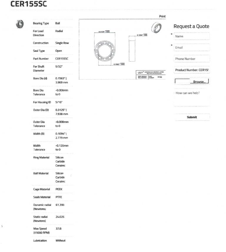

                    I started to look at options for replacing the ball bearings I have been using for ones that would work running with steam. I would love to find a flanged extended inner race ball bearing with lubrication not effected by steam or water. I have found stainless steel ball bearings that have methods of lubrication that are water resistant but cannot tolerate the combination of high speed and temperatures around 100 C. The following print shows a full ceramic Lily ball bearing that is rated for the temperature and speed I need and they claim a flanged version is available. I requested a quote with and without the flange for a quantity of 4. If this bearing is available in this quantity and has a price I can afford, I’ll purchase some and test them on air and steam. It will be interesting to see if the full ceramic ball bearing with only condensate for lubrication has the same negligible friction that the lubricated ball bearings I have been using have. I would also like to see if they work with air.
                    Lily Ceramic BB
                    #427123
                    Turbine Guy
                      @turbineguy
                      I got the quote from Lily for the full ceramic ball bearings. The cost was US$95 per item for a quantity of 4 parts. This is approximately 10 times the amount I am paying for my existing bearings buying one at a time. I want to stay with ball bearings primarily due to the precise placement they allow. My best run has been with a clearance of approximately 0.04mm between the rotor OD and the housing ID. I don’t know if that tight of a clearance is necessary, but I don’t want to add more clearance unless absolutely necessary. Graphite bushings would work for the temperatures and speeds I require without adding too much friction when operating dry using my airbrush compressor. They would work even better with wet steam. The biggest problem for my existing turbine would be the extra clearance required for wear. I thought my existing bearings were lubricated with grease, but found that they used oil. I tried spraying both of the bearings in my turbine with WD-40 until they were soaked. I thought this might wash out the existing oil that had gummed up. After soaking the bearings with WD-40, I ran the turbine with my airbrush compressor. I got a speed of 21,200 rpm that was almost the same speed of 21,500 rpm I reached before running with steam. I went to the WD-40 website to see if they had anything better for my situation. Their Specialist Spray and Stay gel lubricant looked like it would meet my needs. The following is their technical data sheet. I ordered a can and will try it for both air and steam.

                              I tried spraying the special WD-40 on the shielded ball bearings hoping the spray would get by the shields and form the gel inside the bearings. I ran the turbine with the airbrush compressor after allowing time for the lubricant to thicken. When I started the turbine, the maximum speed was only about 10,000 rpm and after running for several minutes reached a speed of approximately 20,000 rpm. This was what I assumed would happen since the gel has to spread around enough to let the ball bearings run freely. I ran the turbine with the airbrush compressor for another 12 minutes to see if the turbine would maintain a constant speed. The turbine would run for several minutes at approximately 20,000 rpm and then slow down and go back to the maximum speed. It slowed down several times but always went back up to the maximum speed. When the turbine slowed down it was fairly abrupt and it would pick up speed very quickly afterward. There were also some strange sounds that I hadn’t heard before. I think I will try getting a new set of bearings and running them for an extended time with the airbrush compressor and see how they perform.

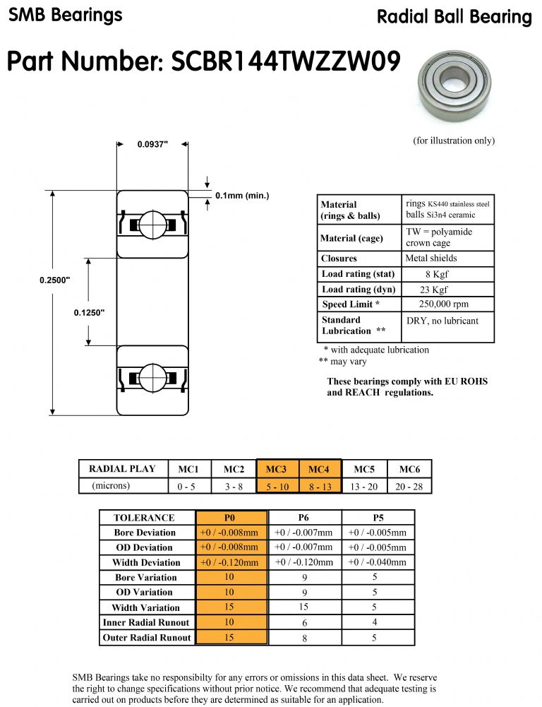

                                #427824
                                Mike Tilby
                                  @miketilby23489
                                  Hi Turbine Guy
                                  This is the company: http://www.smbbearings.com
                                  They are in Oxfordshire, UK
                                  They have been very helpful and had no minimum order size. This is the advice they sent me (it was a few years ago, so the price info will be out of date):
                                  "My manager has recommended that you consider a dental bearing that we have available, with a high speed cage & ceramic balls – the SCBR144TWZW09 SMB – which can operate at 250000rpm without the need for lubrication (dimensions are 0.125×0.25×0.1094&rdquo. We currently have 14pcs available from stock at £9.48 each plus VAT."
                                  Below is the data sheet for those bearings.
                                  Regards
                                  Mike
                                  #427833
                                  Turbine Guy
                                    @turbineguy
                                    Hi Mike,
                                    Thanks for sharing this information. If SMB recommended these for a speed of 50,0000 rpm, they should work fine for my turbines. Their price, even with increases, is still very reasonable. This would be a better alternative for my turbines than graphite since precise positioning is very important with my design. After I get my reversing chamber made and tested or I have problems with my existing bearings at the higher speeds, I might try using these in turbine 3.

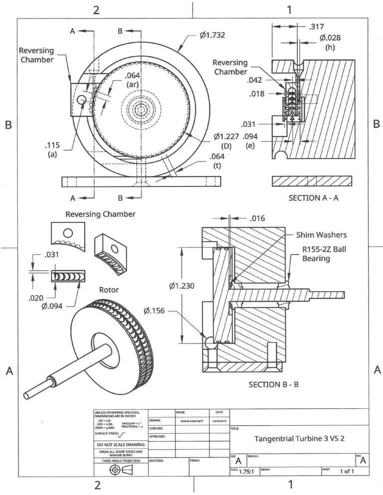

                                        #431093
                                        Turbine Guy
                                          @turbineguy

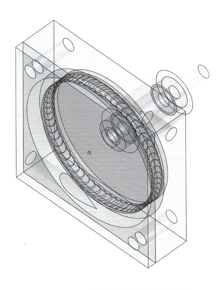

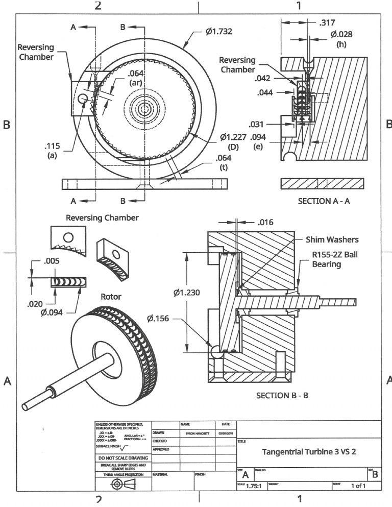

                                          The following drawing is the first revision for turbine 3 with the velocity staging. As you can see there are quite a few changes from the drawing shown in the post of 10/04/2019. Some changes were made to improve the design while others were to repair errors in machining. The letter A was added to drawing file name to show this is revision A. This drawing shows the dimensions important for setup and analysis and shows the actual part dimensions at the time of this revision. I ran the turbine with and without the reversing chamber and will describe the performance in the next posts.
                                          Tangential Turbine 3 VS A

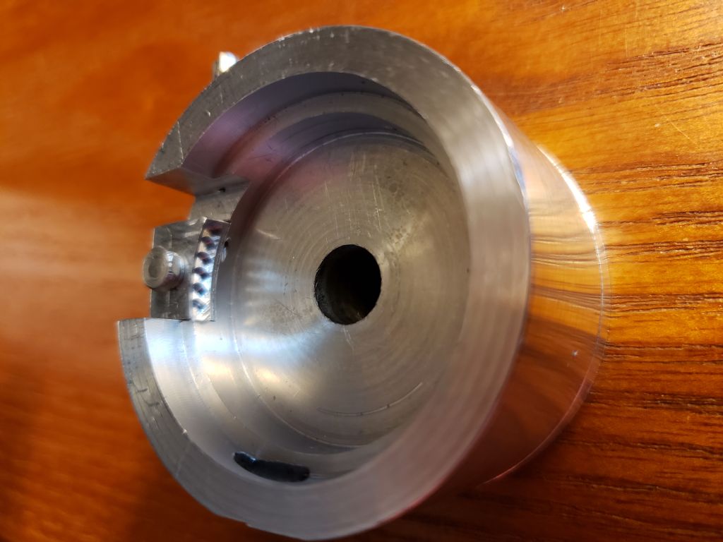

                                            The following is a picture of the reversing chamber mounted on the turbine housing. The reflection of the aluminum makes it hard to see the pockets clearly. You can also see the position of the nozzle's closest edge is not very far from the edge of the reversing chamber (measures 0.003 in..

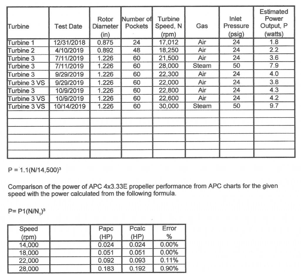

                                            #431256
                                            Turbine Guy
                                              @turbineguy

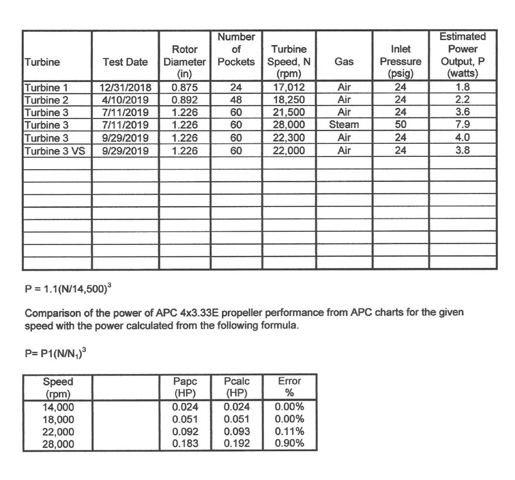

                                              I made the following chart to summarize the testing of my turbines and a chart at the bottom to check the validity of my equation for estimating the power required by the EP2508 propeller. I had only one speed of the EP2508 propeller that I could verify the required power. I wanted to see if my use of increasing the propeller power by the cube of the turbine speed was valid for the range of speeds of my tests. Since APC has performance charts for all its propellers, I checked the performance of their propeller closest in size to my EP2508 propeller at the speeds nearest to the speeds obtained in testing. As shown in the chart, increasing the power by the cube of the speed for the range from 14,000 to 28,000 rpm was accurate to within 1%. Since the first test was with Rulon bushings and run with a smaller boiler, I did not include its performance in this chart. This way all the tests on air or steam will be with the same airbrush compressor or boiler and all the turbines have the same ball bearings. I had mentioned earlier that I thought my estimates for power appeared it be optimistic. I lowered the estimated powers in this chart slightly from what I have previously given to be more conservative. These values of power are approximately the power I calculate using Dr. Balje’s guidelines.  The first test with velocity staging resulted in lower power than with the reversing chamber removed.  This is comparing an optimized single stage with the first try of velocity staging. Hopefully by optimizing the reversing chamber I can improve the performance of the velocity staging.
                                              Turbines Test Results
                                              Edited By Turbine Guy on 30/09/2019 20:38:02
                                              #433357
                                              Turbine Guy
                                                @turbineguy

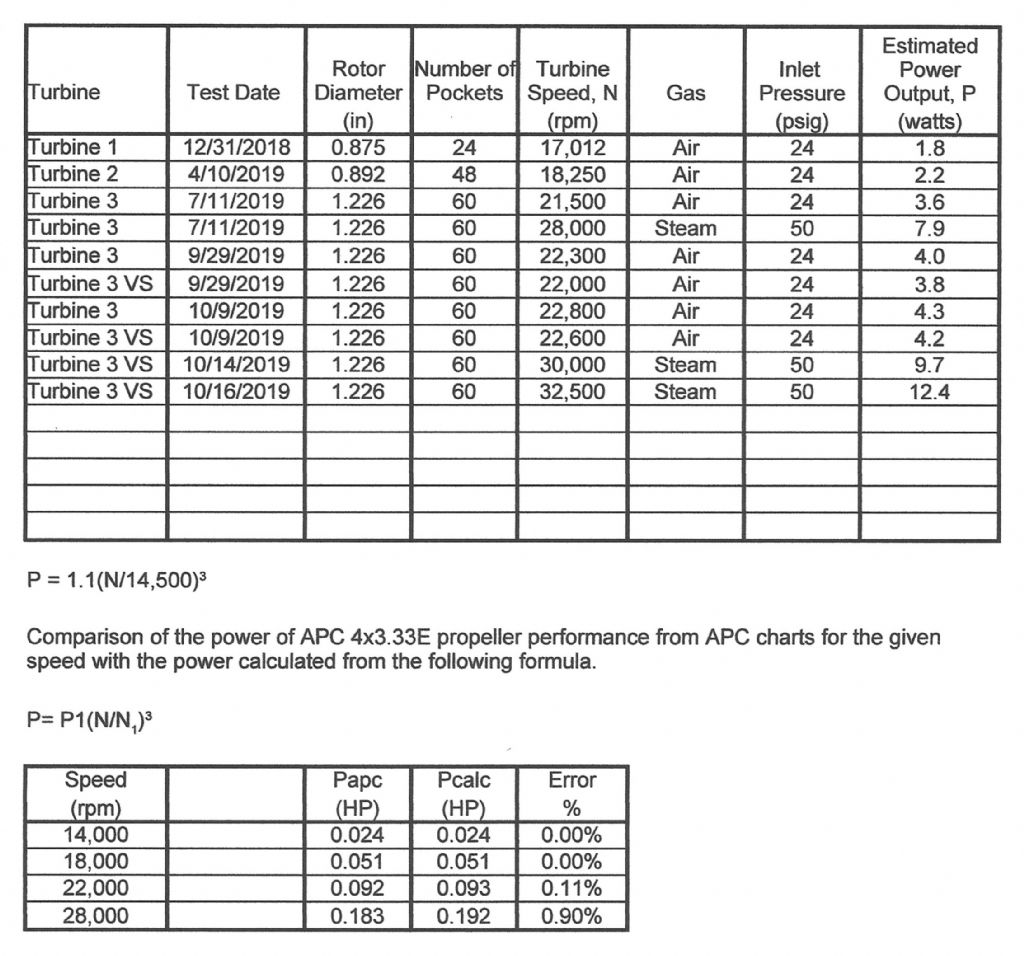

                                                The following chart is updated to give the latest performance of my Turbine 3. The drawing showing the changes that gave me the best results will be added in the next post. I ran several tests with air after I got the maximum performance with all the changes I tried. The results stayed the same for both with and without the reversing chamber. The improvement in performance running on air was very small. The speed increased by 500 rpm without the reversing chamber and 600 rpm with the reversing chamber with the improvements. The turbine still made slightly more power without the velocity staging running on air. Apparently, the back pressure caused by the second stage was enough to keep the performance from getting better than with a single stage.
                                                I ran the velocity staging with steam today and added the performance of this test to the table. The extra energy of the steam allowed the velocity staging to work better. The boiler pressure was the same as the test of 11/7/2019 without velocity staging, so the energy supplied should be approximately the same. The velocity staging with steam got a 1.8 watt increase in power. I planned on running on air immediately after running on steam to see if that would keep the ball bearings from gumming up. Even after releasing the hose clamp, the silicon hose I used for steam would not come off. I pressed the hose from my airbrush compressor against the silicon hose and got enough pressure to spin the turbine and blow the water out. I then tried pulling as hard as I could on the silicon hose. The stainless steel (ss) tube that was Loctited to my turbine housing popped out. I had to cut the silicon hose to remove it from the ss tube. I don’t know what caused the silicon hose to bond to the ss tube. I Loctited the ss tube back on my turbine housing and will run the turbine on air tomorrow after the Loctite cures. Hopefully, the ball bearings will not gum up.
                                                Turbines Test Results 2

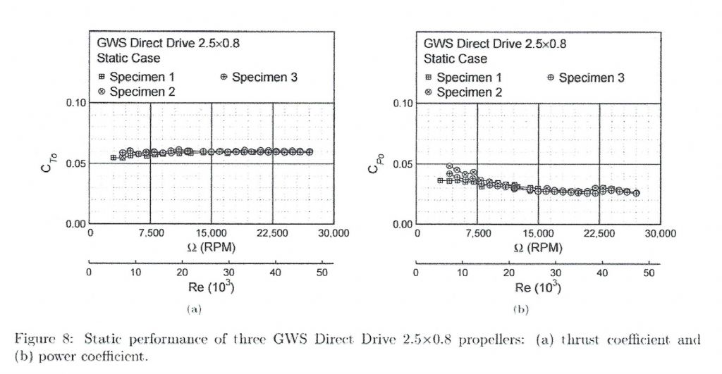

                                                    #440679
                                                    Turbine Guy
                                                      @turbineguy
                                                      I tried running an APC 4×3.3EP propeller on my turbine 3 to see if I could confirm my estimates of power. The speed I obtained both with and without the reducing chamber was 4,250 rpm running on air from my airbrush compressor. The actual power of approximately 0.5 watts I obtained using the performance chart for that propeller was about half or what I estimated. I had to make a lot of assumptions in the estimated power for the GWS EP2508 propeller, so I searched the internet for some actual test results for this propeller. I found a report titled Reynolds Number Effects on the Performance of Small-Scale Propellers. In that report I found the charts shown below for the actual performance of the GWS EP2508 propeller running in the speed range of most of my testing. The static power coefficient Cpo for the speeds ranging from 10,000 to 25,000 rpm was approximately 0.03 from fig. 8 chart (b). With this value of power coefficient, the power at 14,500 rpm is approximately 0.58 watts. This power is about half of what I estimated for this speed. I compared the values for the power coefficient from this report with values from APC for one of the tested propellers and they were almost identical, so I think the APC charts are valid. The report indicates that my estimates for the power using the GWS EP2508 propeller is almost double the actual power. Because my testing indicated that the gains in performance with each change matched what Dr. Balje’s methods estimated for the change, I went back to his Study of High Energy Level, Low Power Output Turbines to see if I missed something. In this report he states that the profile losses and consequently the overall losses, is almost doubled by decreasing the Reynolds number by a factor of 4 from the assumed value of 2 x 10^5. I had assumed that the Reynolds number effects were included in the equation I used for the estimated efficiency. I found this equation doesn’t include the effects of Reynolds number. When I corrected my estimated performance for the effects of the Reynolds number, the estimated power was approximately what the APC chart and the report Reynolds Number Effects on the Performance of Small-Scale Propellers gave. This was true for all the tests except the tests with the GWS EP2508 propeller running on steam. Those tests had speeds above 28,000 rpm which was outside the range the actual power coefficients were given. It takes a combination of a very low power input and very small dimensions to get this low of a Reynolds number but all my testing on air was in that range I will add the updated chart showing the new lower values of power in my next post.
                                                      GWS EP2508 Propeller
