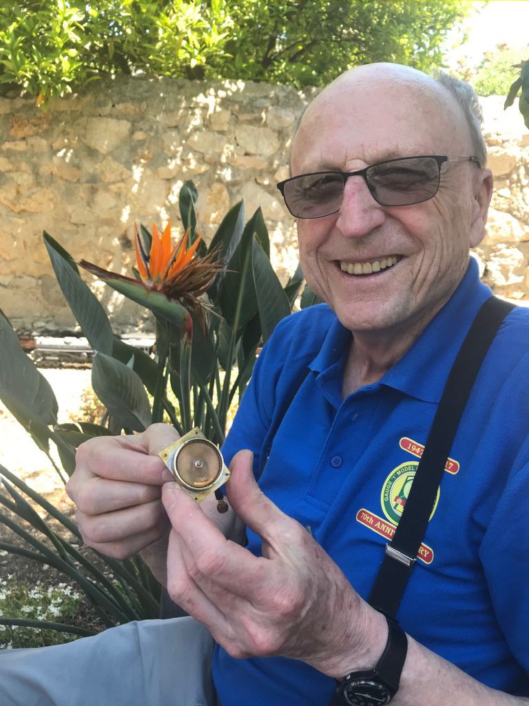

                                  Werner Jeggli
                                    @wernerjeggli14222
                                    Hello Turbine Guy,
                                    Your turbine parts look beautiful, are supported by theory and are also well machined. I really hope it will pan out in the end.
                                    I just returned from a G1MRA event in Toulon/France where I ran the PRR-S2 with 5 coaches for half an hour and everybody clapped their hands. I took along my multipurpose model steam turbine project and discussed it with anybody showing their interest (quite a few).
                                    My ambition is to create versatile steam turbine, which could be used for generating purposes using two 0.8mm nozzles, mounted either at the top or the bottom of the turbine casing for turbo generator application. By using the second slot for a reverse nozzle, working the forward blades from the wrong side (awful engineering – but it works at the price of awful efficiency) it can also be used for a direct mechanical drive.
                                    I'm quite confident that I can reach the peak 10 Watt shaft power target and will run the corresponding tests to prove it.
                                    Below is a bad picture of nozzle inset drawing and a Toulon picture. Behind the flower you see the PRR-S2.
