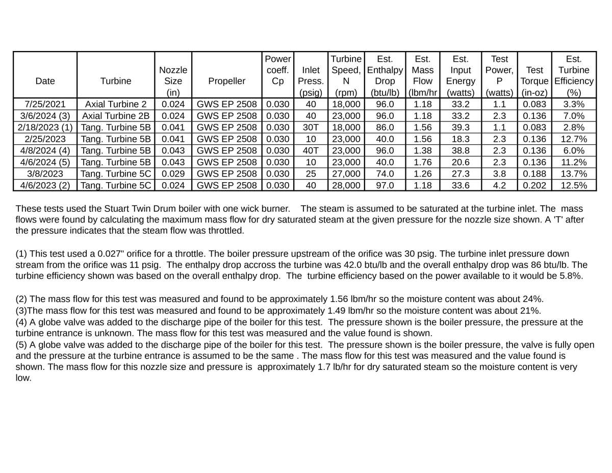

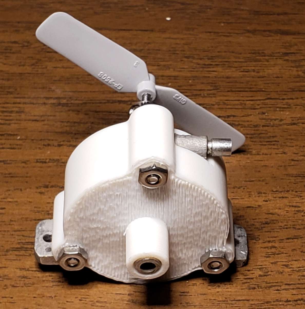

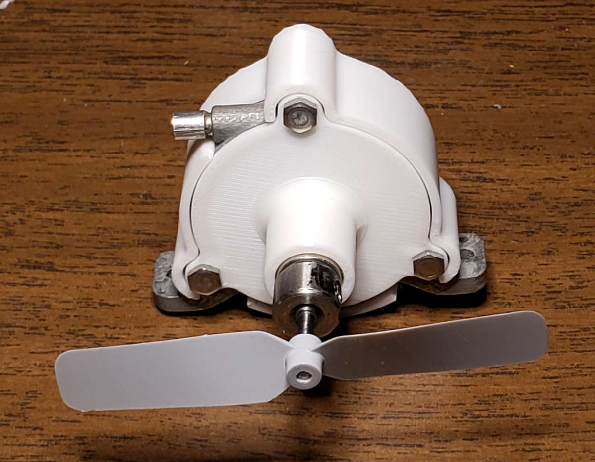

      I decided to try to insulate Tangential Turbine 5B by adding a 1/16” thick layer of Nylon over most of the outside surfaces of the housing and cover as shown in the following drawing. I call the new assembly with the added insulation Tangential Turbine 5D.
      Since the insulators did not have to be very precise or need much strength I asked a friend to print them from Nylon on a home printer. The following photos show the printed insulators installed on Tangential Turbine 5B. As you can see from the photos, the prints came out very good on the first attempt. I thought the insulation would raise the performance significantly by reducing the heat lost to the cold air being blown over the turbine by the propeller. I have not got any improvement in efficiency running on steam regardless of the pressure tried after several tests even though the performance running on air after the test is always as good as before each test. I don’t see any logical reason that I shouldn’t get at least a little better performance by adding the insulation. I haven’t seen any indication of rubbing or binding. I will see if I can find if there is a problem.
      Insulatlors Installed Photo 1
      Insulators Installed Photo 2

        Mike Tilby told me that I might be expecting too much from the insulation I added as described in the last post. He shared with me a very interesting 2 part article that explained how adding insulation with too high conductivity could actually increase the heat loss. The nylon I am using for the insulation is a poor enough insulator that this might be my problem. I decided to see if I could get a good estimate of the actual heat loss. I ran a test of Tangential Turbine 5D and measured the temperature of the housing and outer surface of the insulation using the Stuart Twin Drum boiler, turning the GWS EP 2508 propeller, and keeping the boiler at a output pressure of 40 psig with the globe valve. The housing quickly warmed up to a temperature of 163 F and the outside of the insulation had a temperature of 106 F with the propeller blowing air over the turbine. These temperatures stayed almost the same for the remainder of a 11.5 minute run. When steam ran out and the turbine started to lose speed, the temperature of the outside of the insulation started to rise very quickly since the convective heat transfer changed from forced to natural convection. The outside temperature of the insulation went up so quickly and then started to drop very slowly that I wasn’t ready to get the highest temperature when the propeller stopped turning. I have to remove the wick burner immediately after the water is boiled out since it has almost full flame at the end of the run. I purposely start with ½ cup of water since I know it will run out before the wick burner starts to run out of alcohol. This allows me to have approximately maximum output of the wick burner for the full length of the run. This also allows me to know exactly how much water was used. The turbine speed, housing temperature, and outside temperature of the insulation all stayed about the same after the turbine warmed up with the globe valve at the same opening for the rest of the run. This length of run with very stable conditions should give me the data I need to find a good estimate of the heat lost from the turbine housing and cover with the 1/16” thick nylon insulation. The following equation is what I used to find the heat loss through the insulation. I used the value of 0.144 W/mK given by Shapeways for the thermal conductivity of their printed nylon assuming the printed nylon of my insulation would be about the same. I used the heat flow average area of the insulation since the following reference indicated that if the ratio of the outer radius to the inner radius of the insulation was below 2, the error in using the average area is less than 4%. The largest ratio on any part of the insulators was 1.45 for a very small portion with the remainder being less than 1.2. Since the shape of the insulators was relatively complex I used my 3D Cad program Onshape to find the areas. This program will give the total area of all the surfaces that are highlighted which made getting accurate areas very easy.
        Q=kA(T1-T2)/s = (0.0833)(0.049)(163-106)/(0.0052) = 45 Btu/hr = 13 W
        Where:
        Q= Heat Transfer, Btu/hr
        k= Thermal Conductivity = 0.0833 (Btu Ft)/ (hr degree F Ft^2)
        s= Insulation thickness = 0.0052 Ft
        A= Insulation Average Area = 0.049 Ft^2
        T1= Housing and Cover Temperature = 163 degree F
        T2= Insulation Outside Temperature = 106 degree F
        The run time was about the same as the 4/8/2024 test shown in the following table that was discussed in the 9 April 2024 post on page 21. This test was run the same way so the input power to the turbine of 38.8 watts was approximately the same and is an example of how consistent the power available for the same settings has been. The heat lost through the insulation estimated to be approximately 13 watts is about 34% of the energy input to the turbine but a large part of that probably occurs after the steam has flowed through the rotor.
        I ran another test with everything the same except with the insulators removed. The run time was almost identical with the boiler pressure held at a constant 40 psig, so the energy output of the boiler was approximately the same. The housing temperature stayed at approximately 176 F for the rest of the run after a short warmup. Mike was right, the nylon insulation actually added slightly more heat loss.
        Reference: An Introduction To Heat Transfer by M. Fishenden and O. A Saunders published July 1950.

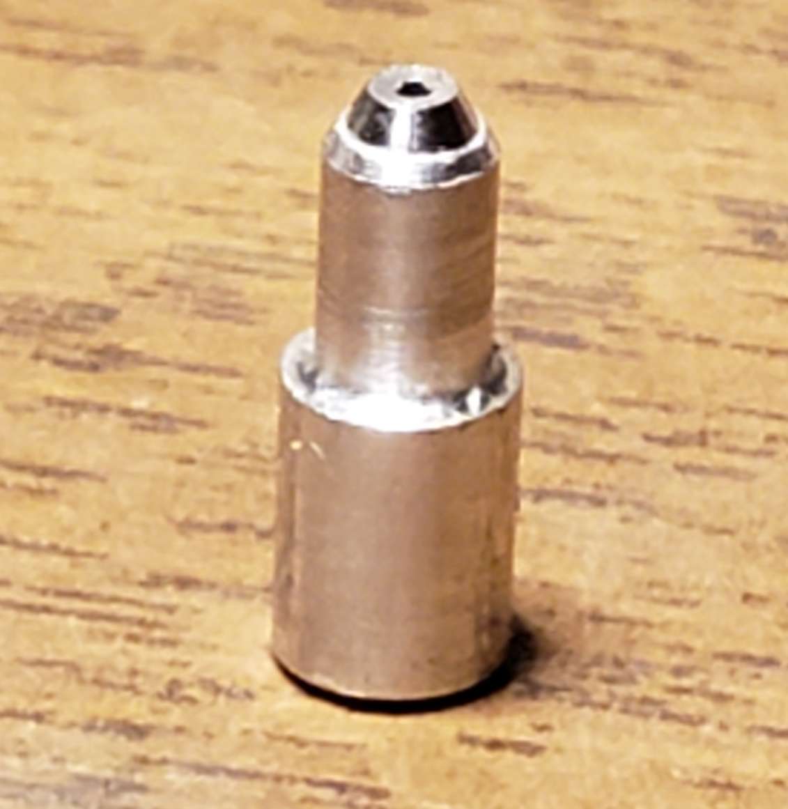

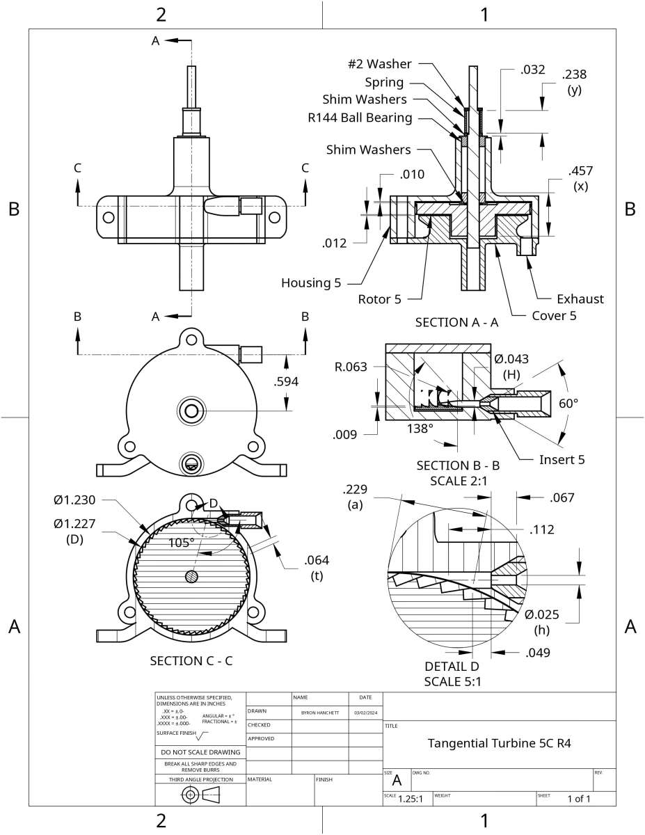

            I ran Tangential Turbine 5C on steam from my Stuart Twin Drum boiler a few times and each time the maximum pressure got lower. I assumed there was leakage around the nozzle insert, so I removed it. The nozzle bore in the insert had increased above the 0.024” (0.61mm) size it had in the first tests. This was probably due to my passing the drill through the insert bore before each test to make sure it was clean. Apparently I opened the insert up a little each time I cleaned the nozzle.
            The insert removed in the quote was made from aluminum. I made an insert out of stainless steel surgical tubing described in the 7 March 2024 post that worked well in Axial Turbine 2B so I decided to make another insert for Tangential Turbine 5C. The following photo shows the stainless steel insert protruding out of the aluminum inlet tube. I got about the same performance with the new stainless steel insert as with the aluminum insert so no update to the tables showing the test results is needed. I updated the following drawing to show the size and placement of the new insert and the new settings of the preload spring described in the last post.
            TT5C Insert Photo 1
            Tangential Turbine 5C R4

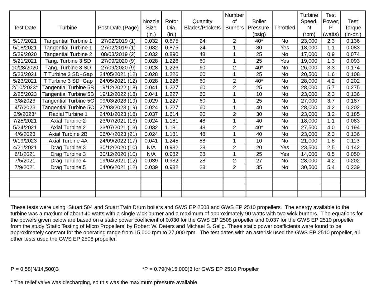

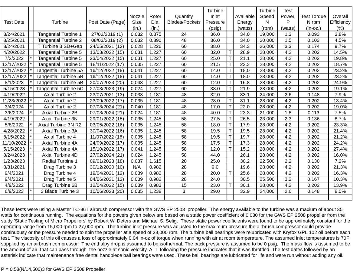

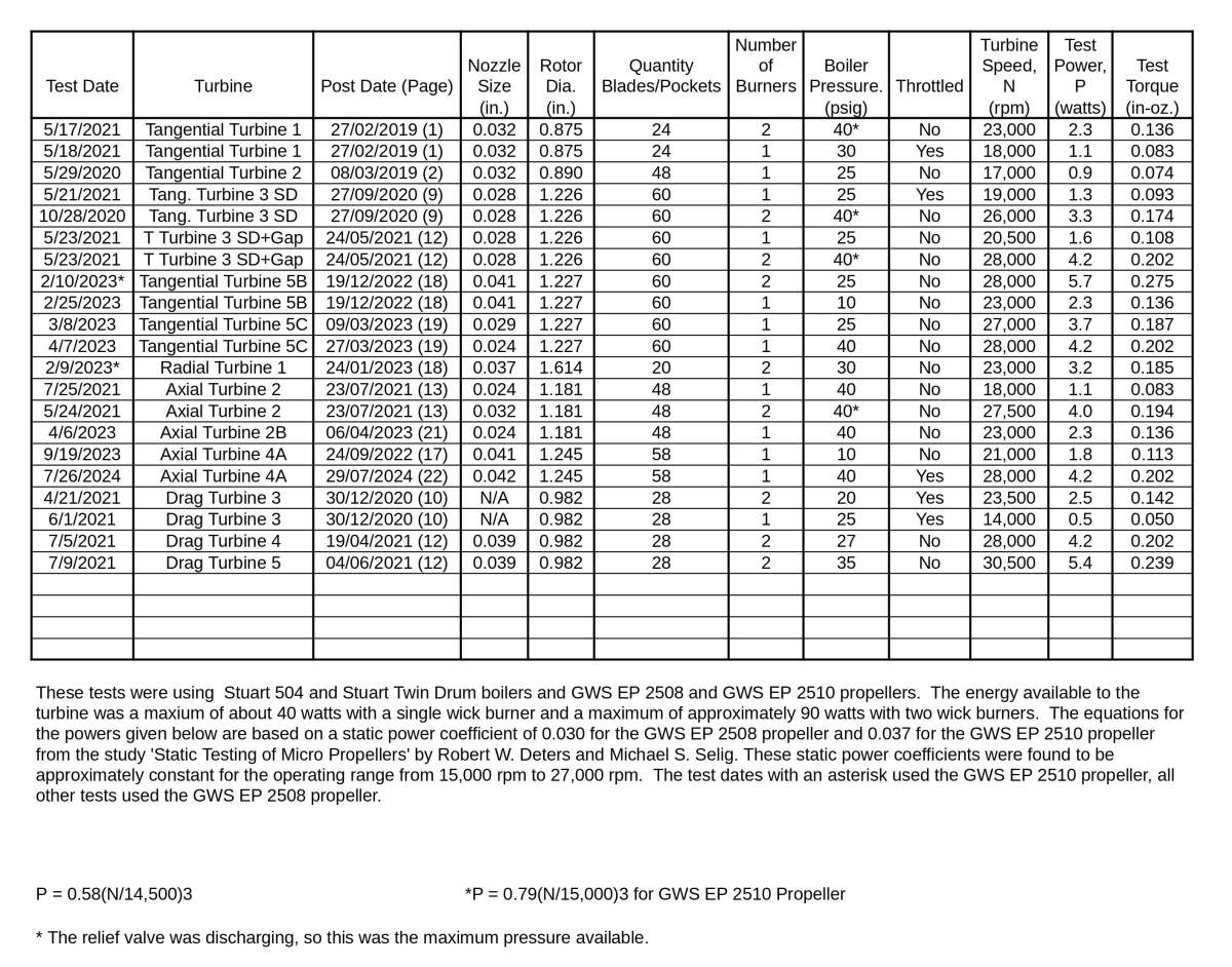

              The following tables are the last updates of the test results for each of the turbines I have tested. Since these tests have occurred over a several year span, the date of the post that best describes the turbine and the page number the post is found on is shown by each test. A new number was given to each turbine when a major change was made. For example Tangential Turbine 1 was called Tangential Turbine 2 after the rotor was changed from one with 24 pockets to one with 48 pockets. Changes that could be made using the same housing and rotor were given a letter after the number to indicate the configuration. For example Tangential Turbine 5A had no cover, Tangential Turbine 5B used a cover, and Tangential Turbine 5C used a cover and an insert in the nozzle. Tangential Turbine 5 can be changed from each configuration back to any other configuration by adding or removing parts. These results show the best performance I was able to get for each configuration for the nozzle size shown. For example, the latest update of Tangential Turbine 5C described in the last post added a preload spring and changed the nozzle insert from aluminum to stainless steel. Both of these changes helped the longevity of the turbine but did not increase the performance, so the test with the closest nozzle size shows the best performance for this configuration. The closest nozzle size shown in the table for tests with air for Tangential Turbine 5C for the existing nozzle size of 0.025”, is the 0.024” of the 5/15/2023 test. That test shows the best performance running on air for Tangential Turbine 5C with a nozzle size close to 0.024”. The 27/03/2023 post on page 19 describes the test and shows details of the turbine. Similarly the 4/7/2023 post gives the best performance for running with steam and the 27/03/2023 post on page 19 shows details of the turbine. Sorry I have to be so long winded in describing how to use the tables. I have made so many tests and configurations, I thought it might be helpful to describe the information I intend to show.
              My Turbines 1A (1)
              My Turbines 2

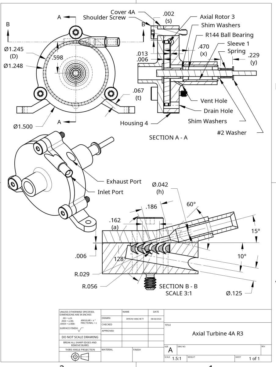

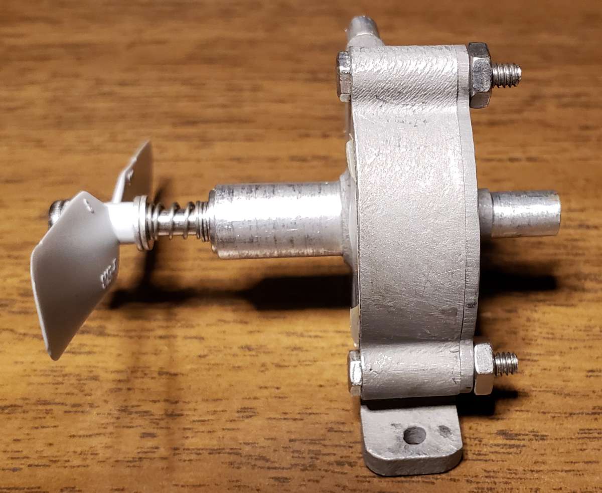

                I replaced the set screw collar with a spring on Axial Turbine 4A similar to what I did to Tangential Turbine 5C as described in the 25 May 2024 post. The following drawing shows the position of the parts and the compressed length of the spring. I ran a test with my Stuart Twin Drum boiler using the throttle valve to hold the boiler pressure at 40 psig and the steam coming out of the exhaust was invisible so the steam stayed superheated all the way through the rotor. After the turbine warmed up the throttle valve stayed in the same position and the turbine speed remained constant for the rest of the 11 minute run. The following spreadsheet has this test added.  This is the first steam test I have made with superheated steam so I ran another test the same way with identical results.
                My Turbines 2
                Axial Turbine 4A R3

                Mike Tilby
                  @miketilby23489
                  Hi Byron
                  Your mentioning of the pre-load spring in a recent post started me thinking about the design of my own very incomplete turbine. I’m sorry if this question has been covered in previous posts. I could not find the information, but there are a lot of posts!
                  If I understand correctly, the spring applies a light pressure that tends to force the inner rings (races) of the bearings together thereby ensuring the balls remain in contact with their grooves. That means the inner ring of at least one of the bearings must be able to slide along the shaft under light pressure whereas the outer rings cannot move together because of their flanges. So I am wondering what sort of fit you have between the inner rings and the shaft.
                  In my turbine the inner rings of the bearings are unable to move because they are lodged against shoulders on each end of the shaft. However, one of the outer rings of the bearings could exert the pre-load if I fitted a suitable spring, providing it was not an interference fit in its housing. Does that sound O.K. to you?
                  Actually I have hit a problem in the design for my own turbine which, as you know, is a long way from reaching a stage where it can rotate. I have been planning to use the dental bearings rated at 250,000rpm with ceramic balls in s/s races. These can operate dry or wet with water (which is certain to make its way into the bearing). But they have nylon cages and that limits their maximum working temperature. This issue has become more serious now that I have modified the design of my boiler. The boiler now allows highly superheated steam (e.g. 50psi, 250 degC) to be supplied to the turbine. This should benefit the operation of the turbine for a number of reasons but it is not feasible to thermally isolate the bearing at the hp end from high temperatures. Ball bearings made of stainless steel balls and cages will have better tolerance to high temperatures but they have lower max. rpm, they will need to be lubricated with oil and oil+water may give a problem. So I am wondering about using a graphite bearing, at least for the hp end. This will be self-lubricating and also compatible with water. Any thoughts will be very welcome.
                  Best wishes, Mike

                    Hi Mike,
                    There are a lot of posts, but the preceding post by Duncan Webster I quoted is the only discussion about pre-load on any other page in this thread.
                    The ball bearing manufacturers recommend that the inner race be a light press fit on the shaft. The precision shafting I use would provide this fit and I would follow their recommendation if I did not need to disassemble the turbines so often to try different settings or options. To ease assembly and disassembly I make the shafts a very close slip fit with the inner race of the ball bearings.
                    The wave washers used by the Star dental drill mentioned in Duncan’s post fit between the ball bearing flange and the housing. This allows the outer race of the ball bearing to move in the housing to absorb the expansion or contraction. This is the method preferred by the bearing manufacturers and should work for you.
                    As I mentioned to you a while back, I have used graphite bearings to overcome the problems you mentioned. These bearings were used in a steam turbine that had superheated steam in the same range of temperatures that you plan to use. The advantage I had with that turbine was its exhaust emptied into a condenser and ran at below atmospheric pressure. This allowed me to use the vacuum to pull condensed water through the graphite bushings to lubricate them and have the water run back into the condenser to be used over again. This worked really well but I don’t know if you would have near enough water if you relied only on the amount condensed by the hot housing. Graphalloy claims that their air lubricated bearings have operated at speeds of 100,000 rpm as shown in the Graphalloy Link. They probably could provide you more information.
                    The test of Axial Turbine 4A I added in the last post uses the excellent rotor you made for me. I felt that this test gets the conditions closer to what it should operate in. I plan on discussing a little more about this test in one of the next posts.
                    Thanks for the update,
                    Byron

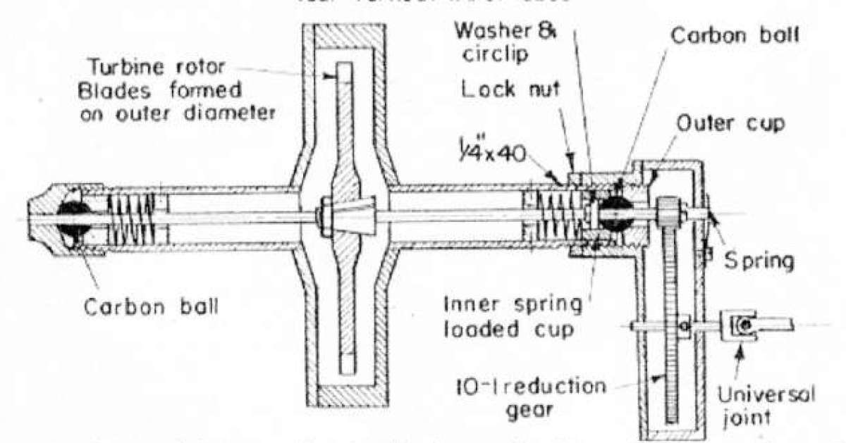

                      Many thanks for those helpful comments. Yes, I had not forgotten that you told me previously you had used graphite bearings in a marine turbine. I have been assuming, although I feel very uncertain about this, that ball bearings would give lower frictional losses than a plain bearing. Is that why you use ball bearings in your miniature turbines?
                      It is the need to withstand high temperature that make me think again about graphite. In 1962 a Mr. Gordon published a description in Model Engineer (10th May 1962) of a very ingenious and very small model turbine-powered boat he had built. That had graphite bearings made from carbon rods he removed from torch batteries. I tried to upload a picture but for some reason I’m told the image is not valid (I’ll send you a copy of the article).
                      I don’t recall you mentioning Graphalloy before and that is a product I knew nothing about. After reading your last post looked into it and understand that it is graphite impregnated with metal, the actual type of metal depending on the application. Apparently it is stronger and more thermally conductive than normal graphite. It sounds specialised and expaensive but I think I’ll contact the company to see if they can supply a small quantity at an affordable price. However, I already have some graphite rods that I bought from the UK compny Erodex. I obtained this to make rotating seals but it is actually a grade of graphite that is recommended for low load bearings (it is grade KC-67 made by Toysanto). I think shall try using that initially. It is nice and easy to machine.
                      I have just seen that Toysanto also make grades of metal-impregnated graphite and that is recommended for highly loaded bearings. This webpage has a useful table of data. https://www.toyotanso.com/Products/Mechanical_carbon/data.html
                      Best wishes, Mike

                        I do use ball bearings in my model turbines to increase the performance. The dental ball bearings I am currently using increased the performance significantly over the shielded oil filled ball bearings and even more for the self lubricating bushing I first tried. This was due to the large reduction in friction that is very important in the miniature turbines.
                        I was able to print the portion of the article you sent that showed Mr. Gordon’s turbine as shown below. I copied this because it illustrates the reasons I believe he was successful using the graphite bearings. His spacing of the bearings a long way apart eliminates the tilting of the rotor and increases leverage to resist the force of the impact of the steam on the rotor. His leaving the rotor open all around except for the nozzle outlet eliminates pressure on the entire face of the rotor. Pressure on the rotor face has ruined the ball bearings in some of my model turbines as I have discussed a few times in this thread. His use of a 0.045” diameter shaft (the only dimension of the turbine I found in the article) keeps the velocity of the shaft OD low. Self lubricating bearings are usually limited by pressure x velocity, so limiting the velocity increases the amount of load allowed. The small diameter reduces the friction torque reducing the power loss. The long length of bearing housings give a large heat transfer area to heat conduction area that helps lower the temperature at the bearings. The use of springs to absorb the expansion is the latest change to my top two turbines and is another thing I liked about his design.
                        I suggested the Graphalloy because it is available from many sources in the USA and has a good reputation but is more expensive than some graphite bushings. I’m sure Europe has just as good sources as you are finding. Graphalloy has a design PV limit (psi x ft/min) of 12,000 and has been used in air at over 100,000 rpm. The upper speed limit and PV limit are what you should try to find.
                        Hope this helps,
                        ByronGordon Turbine

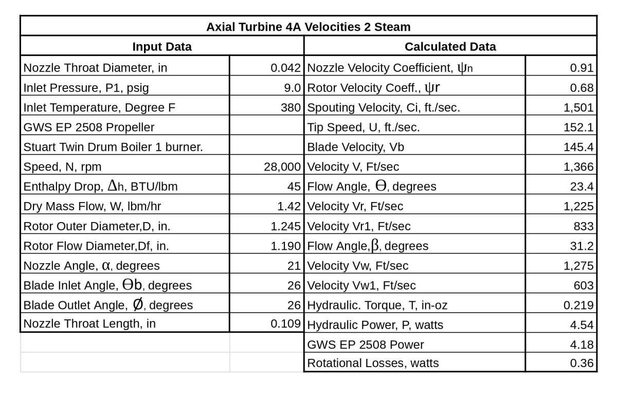

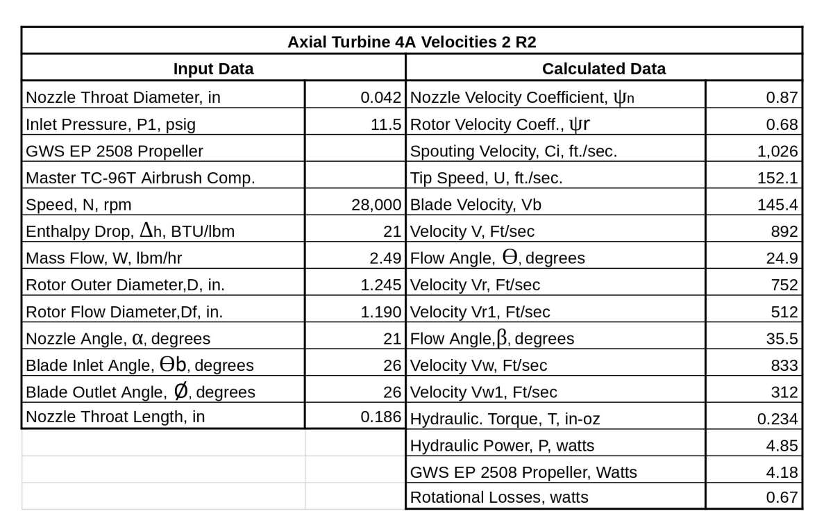

                          I mentioned in the 29 July 2024 post that the steam stayed superheated all the way through the turbine in the test described in that post. I found the mass flow out of the boiler to be 1.4 lb/hr by the 11 minute time required to boil out ½ cup of water. I estimated the temperature of the steam entering the turbine by finding what the temperature and pressure at the throat of the nozzle had to be for this mass flow. This was a process of iteration guessing the temperature and pressure and using the corresponding enthalpy drop to find the throat velocity and specific volume of the steam.  The mass flow for dry steam can be determined with the throat velocity and specific volume. It took several iterations to find the estimated pressure and temperature at the inlet of the turbine that resulted in the mass flow found in the test. The following spreadsheet shows the estimated inlet temperature, pressure, and enthalpy drop for the test described in that post and the performance of the turbine for that test. On the second test I measured the housing temperature and it stayed at 211 degrees F for the entire length of the run after the turbine warmed up to its operating temperature. I also added below the spreadsheet for the test with air for comparison with the test with steam like I did in the 7 April 2023 post on page 20 for Tangential Turbine 5C. This post and the 7 April 2023 post show the performance on air and steam of the two best turbines I have tested.  Axial Turbine 4A discussed in this post is a traditional De Laval type of Axial Turbine and Tangential Turbine 5C discussed in the 7 April 2023 post is similar to the open pocket Stumpf type of Tangential Turbine but with overlapping pockets.
                          AT4A Velocities 2 Steam
                          AT4A Velocities 2 R2

                              #744825
