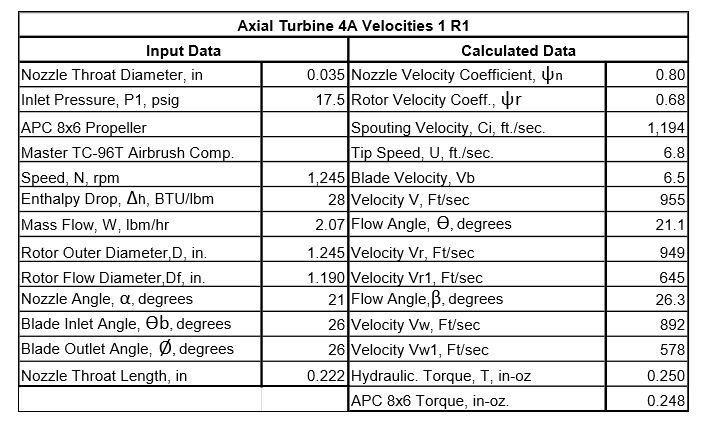

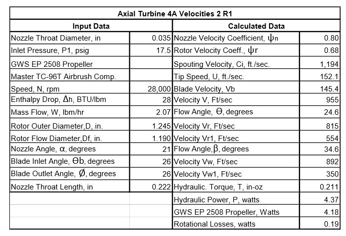

      Mike Tilby pointed out that the angle theta of the flow approaching the blade or pocket inlet shown on my velocities spreadsheets could be different than the rotor inlet angle, so I made the rotor inlet angle theta b. I also added the other flow angles shown on the following velocity diagram. We started the discussion with the spreadsheets shown in the 23/03/2023 post so I updated the following velocities spreadsheets for Axial Turbine 4A that uses the rotor he made for me and sent him copies. Mike checked the angles and after a few corrections we agreed the equations used in these spreadsheets appear to be correct. Hopefully these angles will be helpful in showing the changes in direction of the flow as it approaches, runs through the blades, and exits the rotor. I will use these updated spreadsheets for future tests. I encourage anyone that believes they have found an error in anything I add to this thread to please let me know.

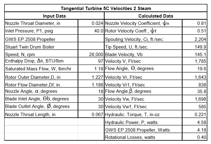

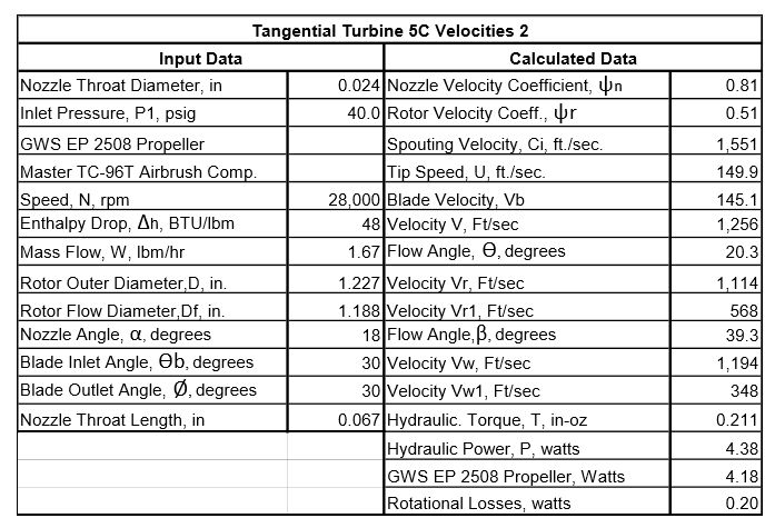

        I ran a test of Tangential Turbine 5C on steam using my Stuart Twin Drum boiler. I was not able to run the test continuously at 40 psig but was able to run it for short periods at this pressure, so the actual mass flow at 40 psig is not known. Since only the dry steam does useful work, I calculated the mass flow and enthalpy drop for dry saturated steam at 40 psig for a 0.024” nozzle and used them in the following spreadsheet. The values of the nozzle velocity coefficient and rotor velocity coefficient were as previously found running on air as discussed in the 31/03/2023 and following posts. Hopefully this will give a reasonable comparison of running on air and saturated steam at the same pressure. I used the updated spreadsheet running on air shown below for comparison. Using the same velocity coefficients for steam as were found for air seems to give reasonable results.

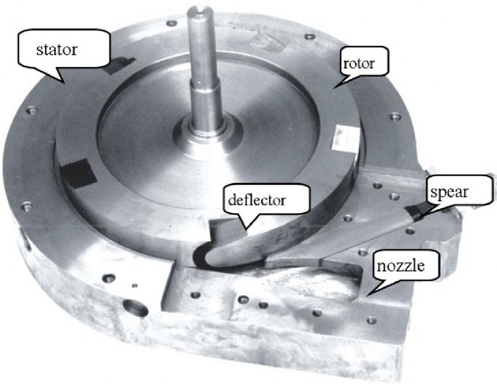

          I was given a copy of the article shown in This Link and found it very interesting. They used a rotor like shown below that was made with the dimensions given in the article. I call it 3 Blade Rotor for its small number of blades. The concept is very unique, since the flow enters the channel like a tangential turbine, then runs down the channel like a drag turbine, and exits the channel like an axial turbine. The article explains the process in much more detail and shows how they estimated the performance and how their estimates compared with test results. I made a housing using the few dimensions they gave in the article and combined it with the 3 Blade rotor to make the following drawing of the 3 Blade Turbine. I will show a velocities spreadsheet for this turbine in the next post.

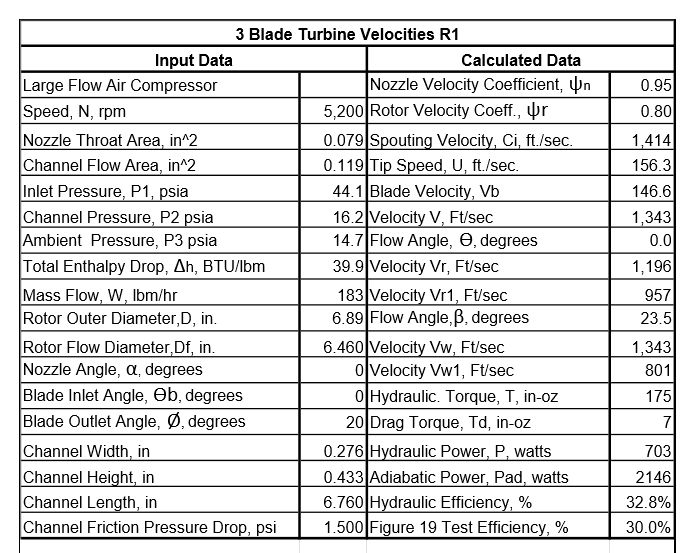

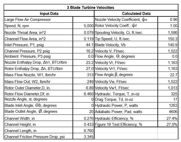

            I decided to use the pressures, areas ratio, and speed shown in Figure 9 of the article in the link given in the last post. This is a 3 Bar inlet pressure, approximately 1.1 Bar channel pressure, Kp = 0.66, and a speed of 5,000 rpm. The rotor channel is 7mm wide and 11mm high, so the channel area is 77 square millimeters. The nozzle throat area is 0.66 x 77 = 51 square millimeters. Since the 1.1 Bar pressure occurs almost the entire filling time this will be considered the channel pressure and the exhaust pressure is assumed to be atmospheric. The mass flow through the nozzle is larger than mass flow out of the channel with these pressures so I am assuming the difference is leakage. With these assumptions I made the following velocities spread sheet. My method of estimating the efficiency came close to the test results of Figure 19 for the approximately 0.1 U/Co of this example. I showed the following velocities spreadsheet for Axial Turbine 4A for comparison since this turbine had an efficiency of 24.2% that is the best of all the turbines I have tested so far. You can see that even with the lower nozzle and rotor velocity coefficients of Axial Turbine 4A  it reached almost as high an efficiency. I am trying to see if I can come up design using the 3 blade rotor that will have efficiencies in this range with the low mass flows and pressures of my airbrush compressor and boilers.
            Edited By Turbine Guy on 18/04/2023 21:06:41

              I studied the analysis in ‘Theoretical and experimental analysis of new compressible flow small power turbine prototype’ by Silvio Barbarelli, Gaetano Florio, and Nino Michele Scornaienchi shown in This Link and although I was not able to follow it completely, I thought this type of turbine would work reasonably well with my airbrush compressor and boilers.I looked at different combinations of using a new 3 Blade Rotor with existing turbine housings and designing a new turbine housing specifically for this type of rotor. Although a housing designed specifically for this application showed the most promise, I think that the rotor shown in the following drawing used in the existing Housing 3 SD Gap has quite a bit of potential. I had to make a few compromises to the design of the rotor to fit in this housing and use the existing nozzle. The design of the rotor makes it possible to be printed or cast. The long channel works like in a drag turbine for the middle of the cycle, so the rougher surface helps get extra drag force to partially offset the loss in exit velocity. Since I only need to make the rotor and shaft, I decided to have the rotor printed in aluminum and will make the shaft out of precision machined stainless steel like in all my other turbines. The following drawings show the dimensions I am going to try to obtain for 3 Blade Turbine 2.

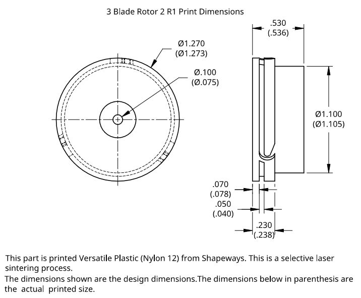

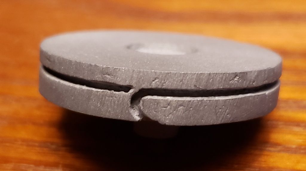

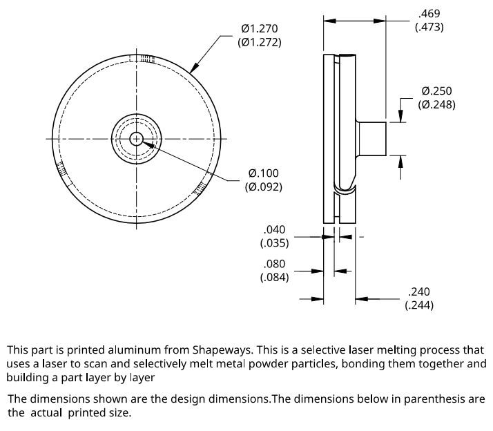

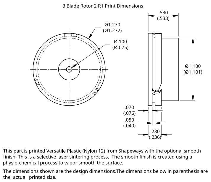

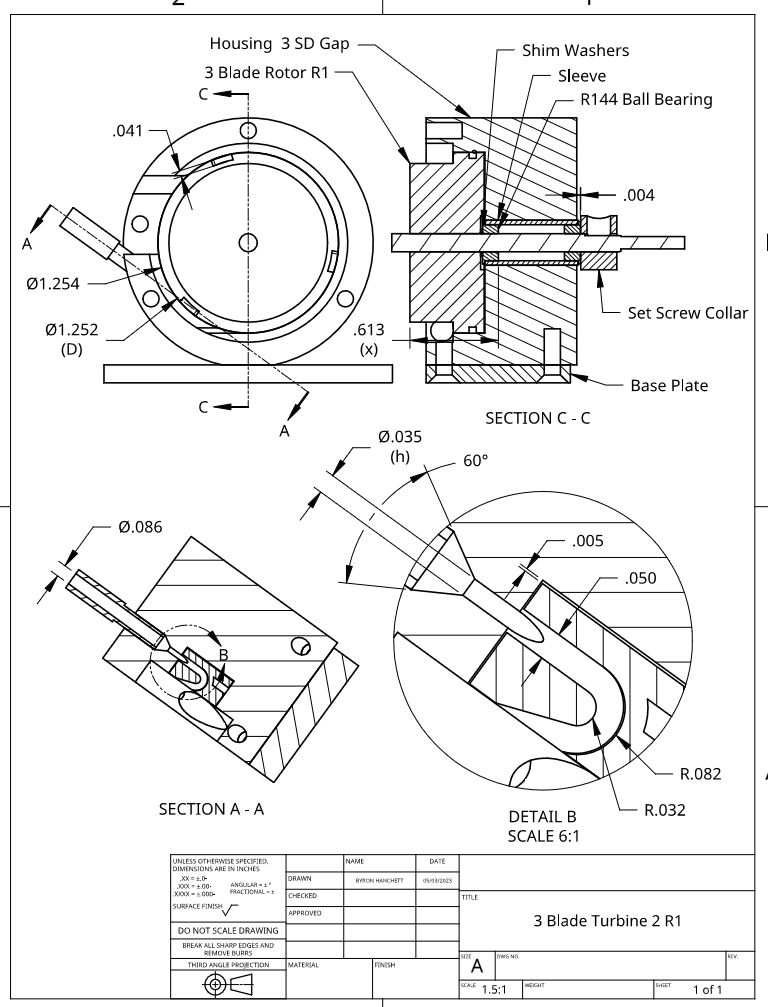

                  I received the printed aluminum 3 Blade Rotor 2 described in the 04/05/2023 post from Shapeways. The following drawing shows the actual dimensions compared with the design dimensions and the following photos show a closeup of the blades. Shapeways tolerance for printed aluminum is +/-0.2mm (+/-0.008" ) for dimensions less than 10mm and +/-1.5% for dimensions over 10mm. The width of the channel varied from a maximum of 0.035" to a minimum of 0.028" so the variation was within tolerance but the minimum width was over 0.008" less than the design width of 0.040". You can see in the second photo the difference in width of the channel each side of the blade. The third photo shows the biggest problem where parts of one of the blades don't line up. Since this print does not meet Shapeways tolerance and has the error in one of the blades, I could have them make another print. I decided not to try another print of 3 Blade Rotor 2 since the variation in width of the channel would be too large even if it is within tolerance. The precision required for the channel of this type of rotor would probably require CNC machining.
                  Edited By Turbine Guy on 22/05/2023 12:55:41

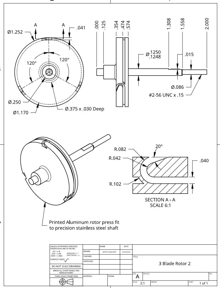

                    I looked through Shapeways guidelines for printed aluminum and found that the minimum thickness should be 1mm. The thinnest part of the blades shown in the photos of the last post had a design thickness of 0.5mm. This is probably what caused the problems. I got some quotes for CNC machining that were over $200 and had tolerances of +/- 0.1mm to +/-0.13mm. I have used printed nylon parts for housings and covers that have worked well if they were made thick enough to withstand the loads and limit the deflections. I decided to try printing a nylon version of 3 Blade Rotor 2 since the propellers I am using are made of this material and designed to spin at speeds up to 28,000 rpm. I realize that the tight clearance on the OD of the rotor required for 3 Blade Turbine 2 will need to allow for the radial growth from running at high speed. Shapeways give the following guidelines for prints of their Versatile Plastic (Nylon 12). The minimum thickness is 0.7mm. The accuracy is +/- 0.15mm +0.15% of the longest axis. The longest axis for the Nylon version of 3 Blade Rotor 2 will be the 1.252” (31.8mm) OD. The tolerance is +/- 0.15 + .0015 x 31.8 = +/- 0.2mm (0.008” ). Since the channel needs to be at least as wide as the nozzle diameter of 0.035” it will need 0.008” added to account for possibly being at the minimum of the tolerance. I decided to make the channel design width 0.050” to allow for being at the minimum of the tolerance and movement required for thermal expansion or contraction. I also provided a large diameter to grip while turning the OD of the rotor. The following drawings show the design dimensions.
                    Edited By Turbine Guy on 26/05/2023 16:56:38

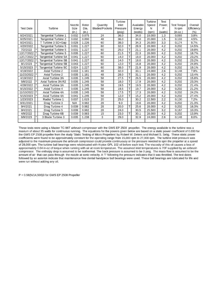

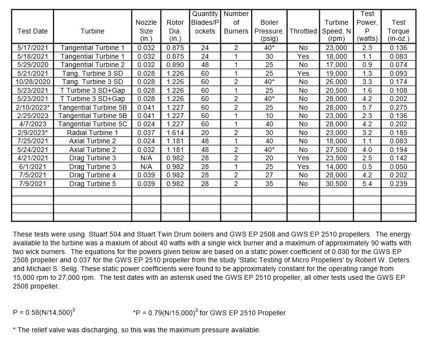

                    #647221
                    Turbine Guy
                      @turbineguy

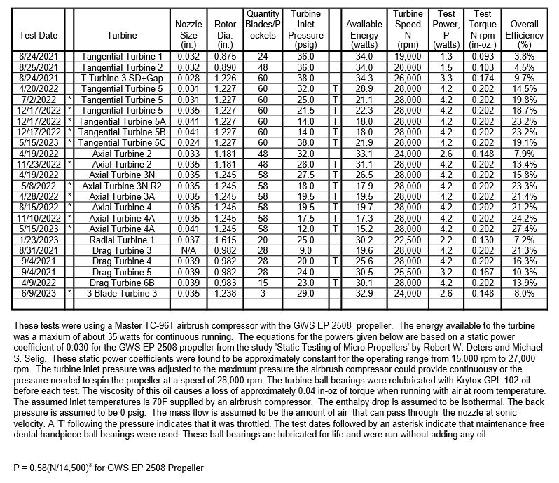

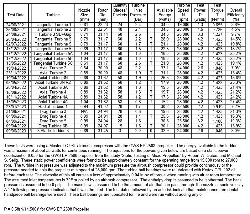

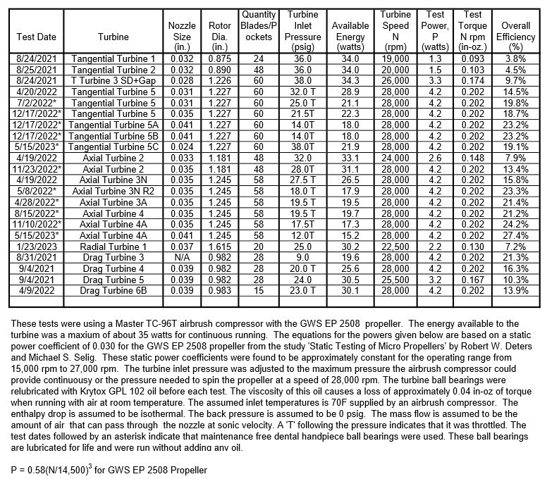

                      I decided to add recent steam tests to the test sheet shown in the 29/05/2021 post and the latest air tests to the test sheet shown in the 22/03/2023 post. The following updated test sheets compare the performance of the various turbines when running on air or steam. There is an album in my photos for each of the turbines shown in these tables with photos, drawings, and additional information. The test dates indicate when the tests were performed and posts made near these dates have discussions on the intent and results of the test.
                      Edited By Turbine Guy on 01/06/2023 15:59:02

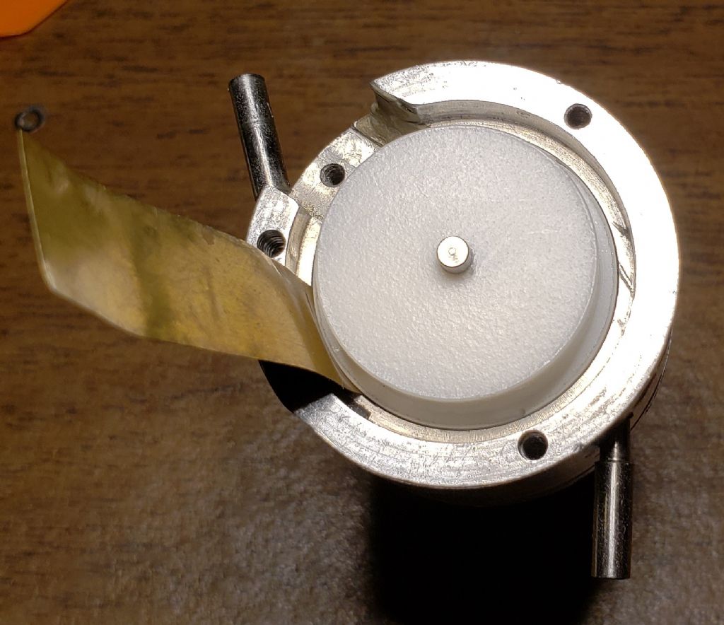

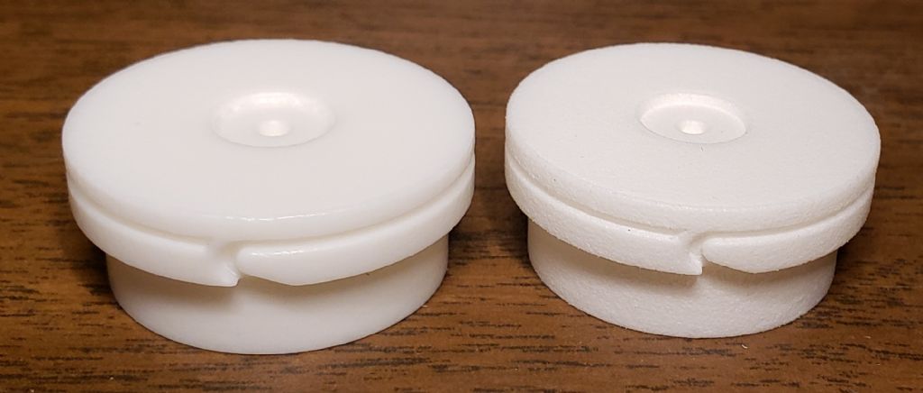

                        I received the Nylon prints for the revised 3 Blade Rotor 2 described in the 26/05/2023 post from Shapeways. I ordered one print with the standard finish and another print with the optional smooth finish. The following drawings show the actual dimensions compared with the design dimensions and the following photo shows a closeup of one of the blades of each print. All three blades of each print appeared to be done correctly. The print on the left side of the photo had the smooth finish. The regular finish was slightly rougher but still much smoother than printed aluminum. A 0.040” diameter pin would slide down the entire length of each channel of both prints with a low pull force. The channel width was approximately at the minimum of the tolerance and the smallest hole through the center of the rotor was quite a bit under the minimum tolerance. In most cases a smaller than tolerance dimension is better than a larger than tolerance dimension since material can be removed.

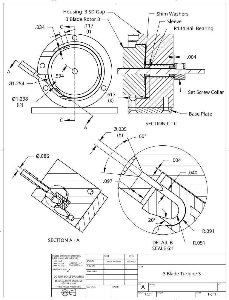

                        #648092
                        Turbine Guy
                          @turbineguy

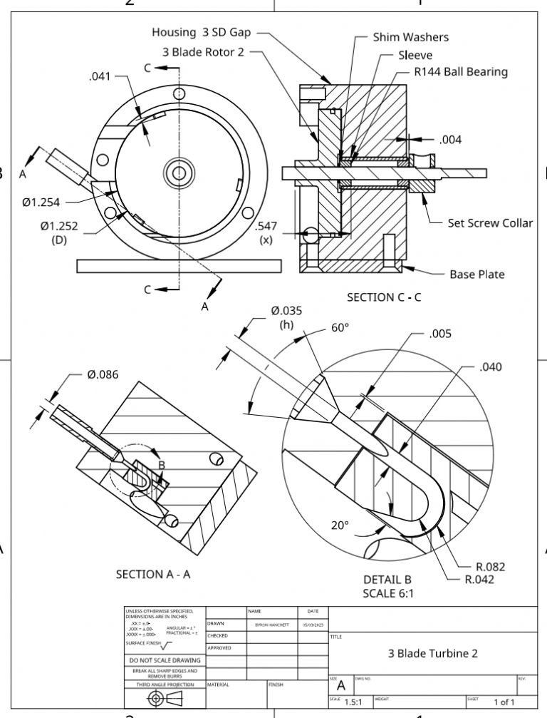

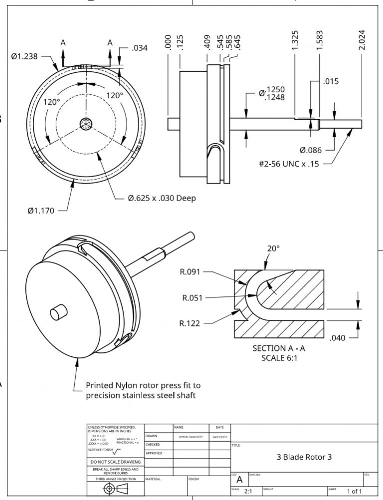

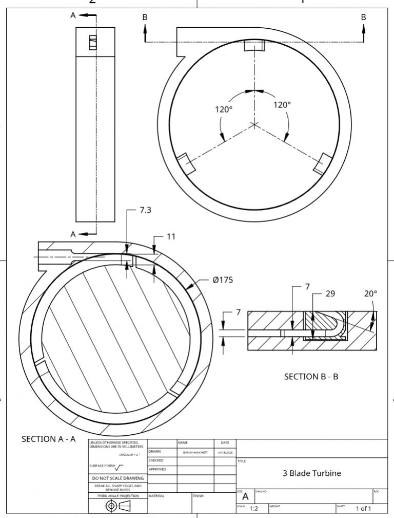

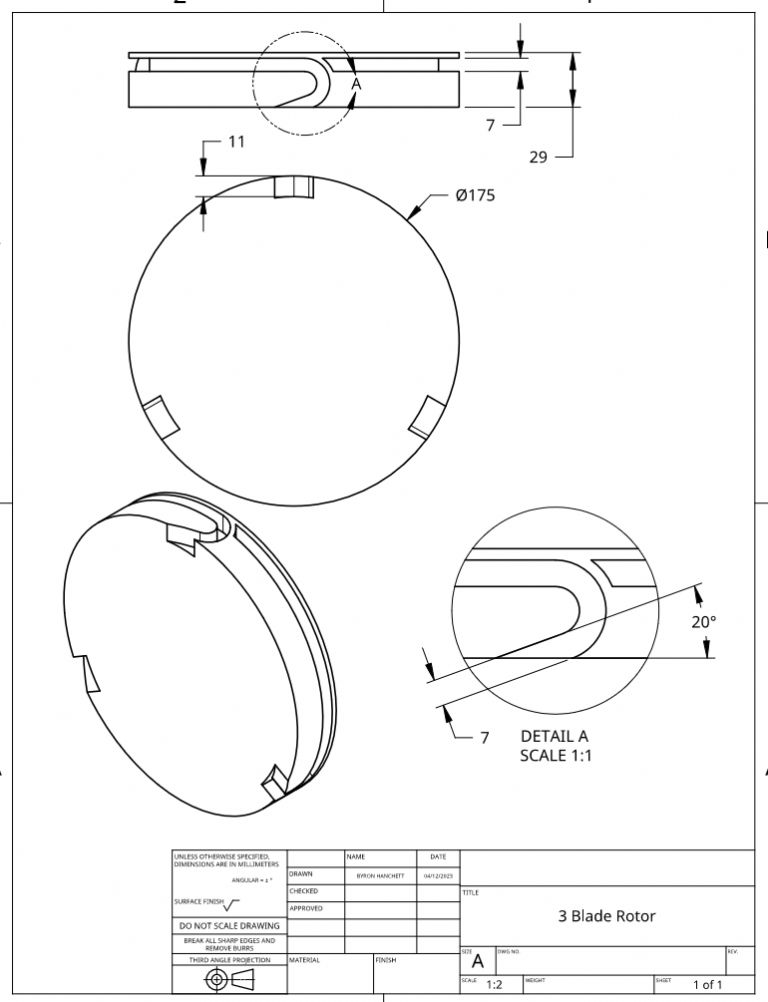

                          I decided to give the drawings shown in the 26/05/2023 post new names since changing the rotor from printed aluminum to printed nylon was more of a change in rotor than a revision. The following drawings show the new names and the dimensions shown are the actual dimensions and position of the rotor in the housing after all the machining. I had to make several compromises in making this turbine that will be explained in the next posts.

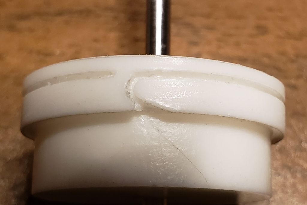

                          #648100
                          Turbine Guy
                            @turbineguy

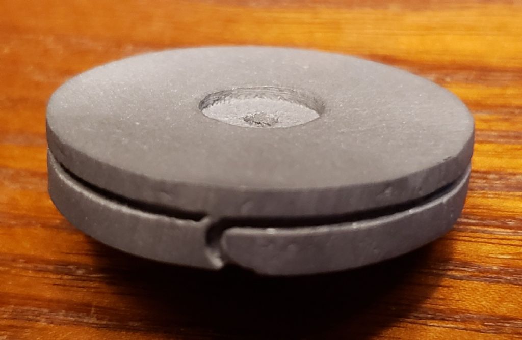

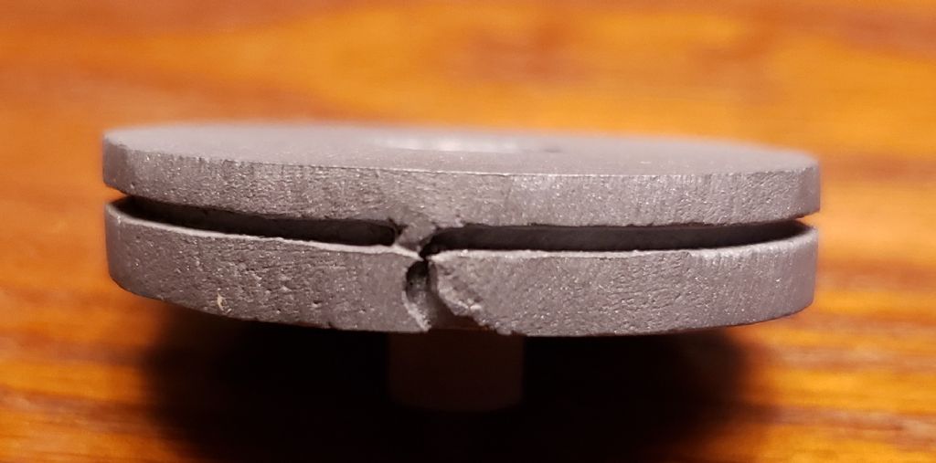

                            I had a few problems making 3 Blade Rotor 3 and 3 Blade Turbine 3 shown on the drawings in the last post. When I machined the OD of the rotor, the cutting tool that was very sharp did not scrape all the nylon off but caused some of the material to wipe over the edges of the channels. When I tried to clean up the edges with a razor some of the wiped over material still would slide under the razor. The first photo given below shows an example of the best I could get the edges. The second photo shown below is a picture of a 5 blade rotor used in one of the reports I read discussing this type of turbine. You can see in the second photo how sharp and smooth the surfaces of the channel need to be to get the maximum performance. I will describe another problem found in the next post.
                            #648105
                            Turbine Guy
                              @turbineguy
                              Another problem I found was the bore of Housing 3 SD Gap that 3 Blade Rotor 3 turns in is not concentric with hole for the ball bearings. When I enlarged the bore of Housing 3 SD to make the gap, all I needed was clearance on the OD of the rotor to allow for expansion to supersonic velocities. My setup for increasing the bore was simple and quick since I was not concerned about keeping it concentric with the ball bearings. The press fit of 3 Blade Rotor 3 on the shaft is strong enough that I could grip the shaft with my collet chuck to turn the rotor OD down to its final size, so it is very concentric with the ball bearings. The drawing of 3 Blade Turbine 3 given in the last post shows the housing bore is 1.254” and the rotor OD had to be turned down to 1.238” to slide into the housing. This is a maximum eccentricity of 0.016”. The following photo shows where I could insert a 0.010” thick shim in the area the nozzle is spraying into. This is a clearance between the rotor OD and the housing bore of approximately 0.010” which will allow a lot of leakage. The problems I discussed in this post and the last post describe two major reasons why 3 Blade Turbine 3 can’t give me the performance this type of turbine is capable of. In the next post I will give the test results.

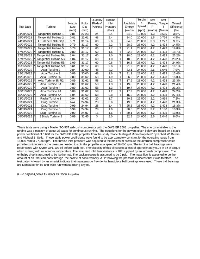

                              #648111
                              Turbine Guy
                                @turbineguy
                                I decided to revise the spreadsheet that I use to compare the performance of the turbines before adding the test results for 3 Blade Turbine 3. I made the spread sheet in two pages. The first page is what I have been using with the Imperial units. The second page converts the data on the first page to Metric units. This makes it relatively easy to show the test results in both units. I hope this makes it easier for those that prefer the Metric units to read the results. The following are the test sheets adding the performance of 3 Blade Turbine 3 in Metric and Imperial units. I think 3 Blade Turbine 3 did surprisingly well considering the problems I discussed in the last two posts.

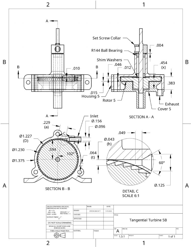

                                    #652993
                                    Turbine Guy
                                      @turbineguy
                                      I ran Tangential Turbine 5C on steam from my Stuart Twin Drum boiler a few times and each time the maximum pressure got lower. I assumed there was leakage around the nozzle insert, so I removed it. The nozzle bore in the insert had increased above the 0.024” (0.61mm) size it had in the first tests. This was probably due to my passing the drill through the insert bore before each test to make sure it was clean. Apparently I opened the insert up a little each time I cleaned the nozzle. With the insert removed, the turbine was changed back to Tangential Turbine 5B as shown in the following drawing. I ran Tangential Turbine 5B on air with the GWS EP 2508 propeller to see how its performance compared with the test shown in the 10/06/2023 post. It only required 12 psig (0.8 Bar) to turn the propeller 28,000 rpm instead of the 14 psig (1.0 Bar) required in the test shown in the 10/06/2023 post. This was closer to the best performance I was able to obtain with Axial Turbine 4A. The advantages this test of Tangential Turbine 5B had over the previous tests was the ball bearings had been run longer, the air temperature was 10 F higher, and the nozzle bore size had increased to 0.043” (1.09mm).
