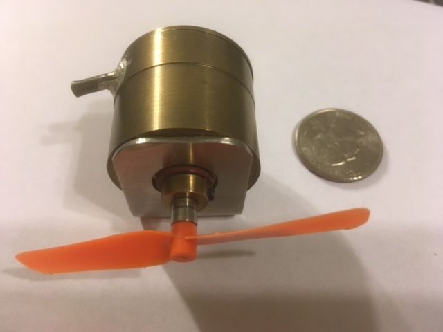

Following up on the post of 27/2/2019, the test that I ran using my airbrush compressor to run the turbine had the following parameters. The air flow was 1.74 lbm/hr, the inlet pressure was 24 psig, and the exhaust pressure was assumed to be approximately 0 psig. The turbine had an EP2508 propeller attached as shown in the picture below. The maximum speed obtained in this test was 17,012 rpm. For the EP2508 propeller I was using, the power required to turn at that speed is approximately 1.92 watts based on an online calculator. This matched with the amount of power used by an electric motor that ran the same propeller at approximately the same speed and the motor efficiency was given for that speed. I thought the simplest way to improve the performance was to increase the speed. I first looked at finding a smaller propeller with given performance data. I could only find a couple of propellers that gave the power required to turn at given speeds and they were too small. I then looked at using a speed reducer. I calculated that if I used the existing turbine and the EP2508 propeller combined with a 2.5:1 ratio speed reducer I would be able to spin the propeller at about 21,600 rpm. The corresponding power required by the propeller at this speed would be approximately 3.96 watts. For this propeller speed, the turbine speed would be 54,000 rpm. The only speed reducers I could find used spur gears and were intended to have input speeds of around 20,000 rpm. The dental turbines that run at speeds in the 200,000 rpm range use friction drive speed reducers. Making a friction drive speed reducer could be an option since power increase would be substantial.

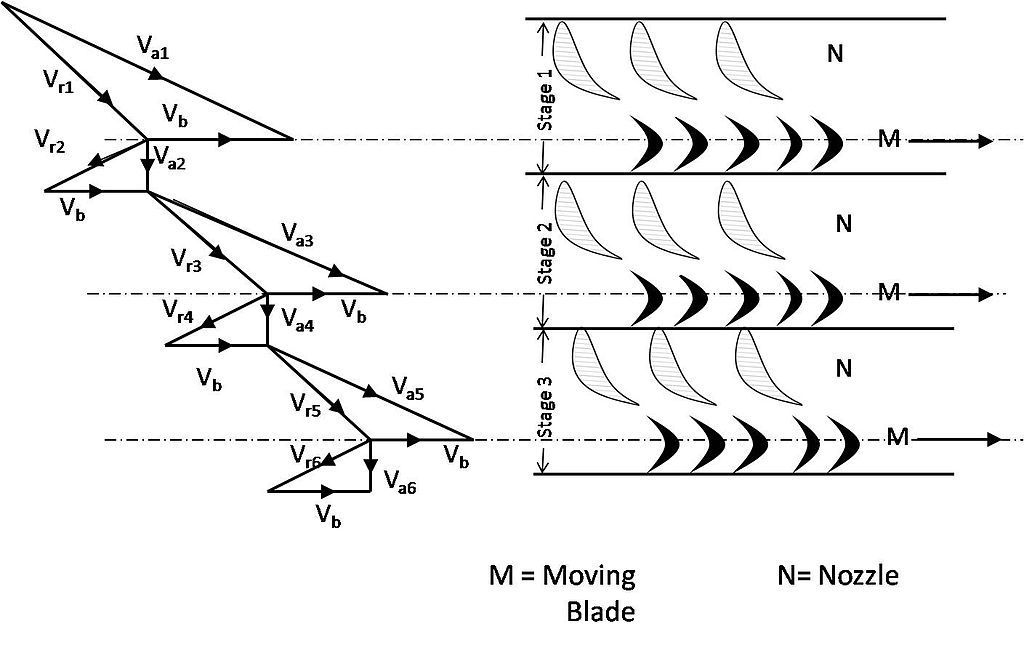

Another way to improve the performance is using velocity staging. The information I found for a Terry turbine that I added in the post of 18/2/2019 showed that turbine had an efficiency of approximately 48% using 4 velocity stages. The Terry turbine’s tangential flow makes velocity staging relatively easy. The reversing chamber is the most complicated part. The flow exiting the rotor blades flows into similar blades in the reversing chamber. The blades in the reversing chamber need to reverse the flow direction and the flow exiting the reversing chamber needs to flow into the next pair of blades in the rotor. Reversing and advancing the flow correctly is the most difficult part. I noticed in pictures of Terry turbine reversing chambers the blade spacing appeared to be about equal to the length of admission of the nozzle. Also the blade spacing in the reversing chamber and the rotor appeared to be about the same. I failed in my attempts to accomplish this with the ideal blade width of 3.25 times the nozzle diameter recommended by Dr. Balje. I scaled one of the pictures I have for a Terry turbine reversing chamber and the blade width appeared to be about 6 times the nozzle diameter. Increasing the blade width allowed me to come up with the design shown in the drawing below. Increasing the blade width increases the length of travel of the flow and consequently reduces the rotor velocity coefficient. Based on the efficiency of the example Terry turbine, the loss for increasing the blade width must not be too high. Because the spouting velocity of the nozzle using my airbrush compressor is about half the spouting velocity of the example Terry turbine, I decided to use two velocity stages. My preliminary analysis of this design indicates the two velocity stages will be about right and I should be able get over 4 watts of power using the EP2508 propeller. I will get into more details on this model in my next post.

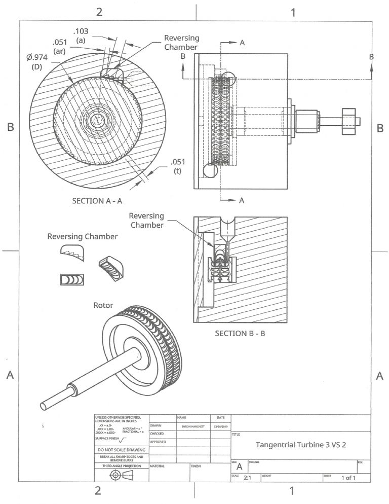

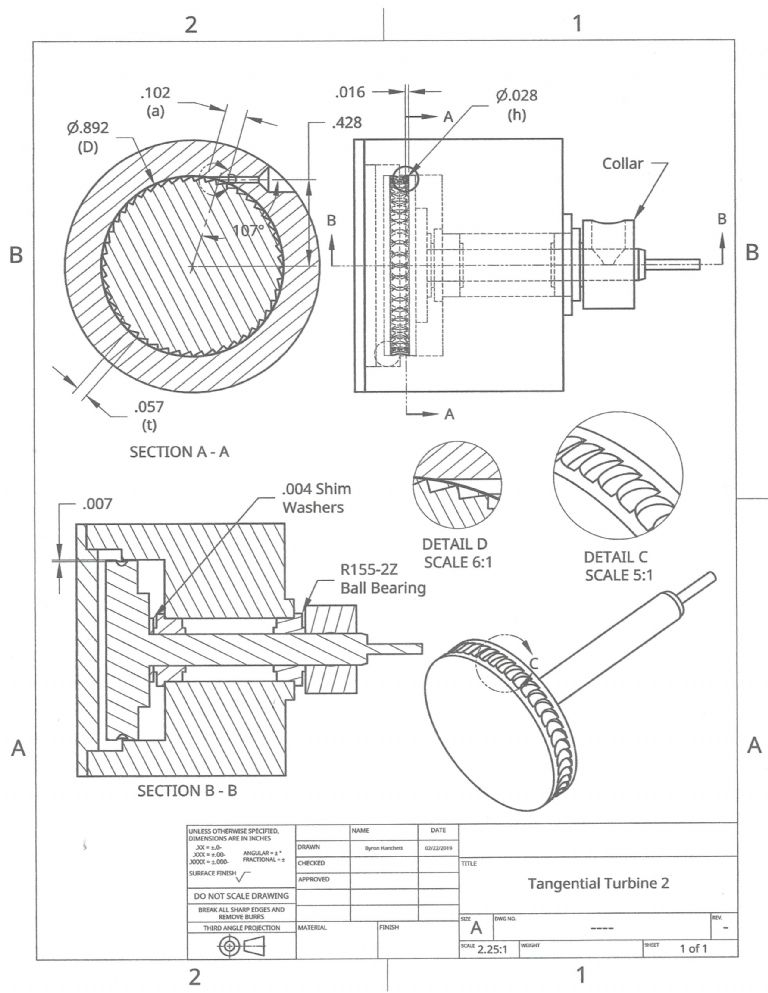

The attached drawing is a revised version of the drawing sent in the last post. To try to optimize the flow paths, I increased the number of blades in the rotor and will need to cut the blades in two steps instead of one. Increasing the number of blades required the keyseat cutter to be different for the reversing chamber and the rotor. Both keyseat cutters are 3/16 in. diameter but the width (H) of the rotor cutter is 0.20 in. and the width (Hr) of the reversing chamber cutter is 0.30 in. Cutting the blades in two steps instead of one reduced the blade blockage length (T) to 0.007 in. The previous version had a blockage length of 0.042 in. Using two different keyseat cutters and doubling the number of steps to cut the blades increases the cost and machining time considerably, but I think is worthwhile. The blade pitch (t), the nozzle admission length (an), and the reversing chamber admission length (ar) are 0.076 in., 0.76 in., and 0.83 in respectively. Having them close to the same value helps the filling of the blades. My calculations estimated that I could get over 4 watts with this configuration based on the values of rotor velocity coefficients Dr. Balje found in the testing of Terry turbine rotors. Since the blades of the reversing chamber are similar to the blades of the rotor, I calculated the reversing chamber velocity coefficients in a similar way.
My airbrush compressor has an output of approximately 1.74 lb/hr of air at a pressure of 24 psig. Assuming close to zero back pressure the amount of energy is approximately 18 watts. With this energy input, a turbine speed of 22,000 rpm, and using the abbreviations in the attached velocity diagram, the calculated velocities for the Terry turbine 4 R are:
Stage 1, Va1= 1,271 ft/sec, Vb= 86 ft/sec, Vr1= 1,197 ft/sec, Vr2= 546 ft/sec, and Va2= 474 ft/sec. The first stage torque is estimated to be 0.16 in-oz.
Stage 2, Va3= 491 ft/sec, Vb= 86 ft/sec, Vr3= 402 ft/sec, Vr4= 362 ft/sec, and Va4= 291 ft/sec. The second stage torque is estimated to be 0.07 in-oz.
Stage 3, Va5= 326 ft/sec, Vb= 86 ft/sec, Vr5= 233 ft/sec, Vr6= 210 ft/sec, and Va6= 142 ft/sec. The third stage torque is estimated to be 0.04 in-oz.
The velocity drop is so much higher in the first stage since the approaching blades are empty and some of the air from the nozzle suddenly expands without doing any work. Also, when blades are in a position where part of the channel is on the nozzle side and part of the channel is under the next nozzle, the air impacts air moving at a lower velocity. Since the velocity of the air exiting the last stage is not much higher than the blade speed, there is not enough energy left for another stage.

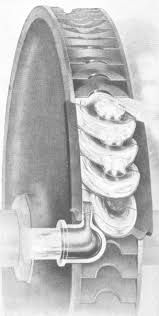

I was not aware of the Terry turbine (having been brought up in a company that made big steam turbines with proper fir tree root blades), but the concept looks very good for miniature builds. I cannot quite see how the Terry velocity staging works (despite studying your drawings and the Terry illustration), so more clarity on the casing return passages would help.
It seems to me the fundamental problem in model turbines is that we are dealing with tiny steam flows. Hence, disk friction losses in the turbine are going to be relatively huge. Therefore, whatever means we can use to reduce running speed will all be to the good. I am sure I had an efficiency estimation chart at one time, which showed that as the turbine type number reduces then the efficiency also heads south – due to the disk friction losses.
One method of reducing running speed (and increasing type number) that I saw in an ME, probably from the '50s comprised a steam ejector working into an axial flow turbine. I rather discounted the idea at the time as ejectors are notoriously inefficient. HOWEVER, with further thought it is the momentum input to a turbine that matters and ejectors are very good at changing momentum from a very fast small jet to a slower big jet with THE SAME MOMENTUM. Given that turbocharger rotors can be readily found in scrapyards, I wonder if an ejector / radial inflow turbine combination would give good results.

I may have confused you by using the velocity diagram of an 3 velocity stage axial impulse turbine. I used that diagram for showing the change in velocity as the flow goes through 3 stages. The axial turbine would actually have 3 rows of stationary nozzles and 3 rows of blades on the rotor and the flow would go as shown on the diagram. The principle is the same for the Terry turbine but it only requires 1 row of blades on the rotor and 1 row of stationary blades that act as nozzles in the reversing chamber. The flow issuing from the nozzle passes through the first set of rotor blades and into the first set of blades in the reversing chamber. The flow entering in the first set of blades in the reversing chamber is turned 180 degrees and advanced to where it will enter the next set of blades on the rotor. The flow in the Terry turbine is cork screw like shown below.
The disk friction is high for turbines but much less of a factor for models with their small rotor diameters. The rotational loss is proportional to the cube of the rotor diameter (D^3) so becomes more of a problem as the diameter is increased. The loss in efficiency of the small turbines is primarily caused by not being able to run at higher speeds. Dental drill turbines operate at speeds well over 200,000 rpm.

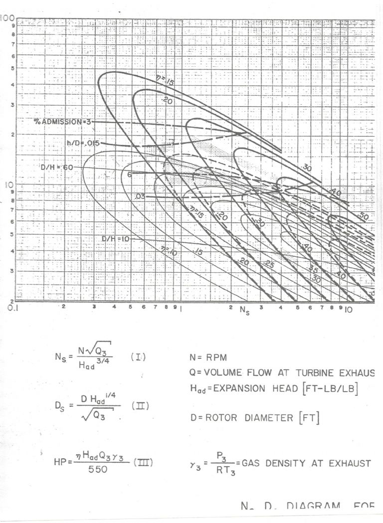

I finally have enough information to give an indication of how effective using an ejector could be for small turbines. A Penberthy GL ½ A ejector has the following performance.
Air inlet pressure of 0 psig
Air inlet temperature of 70 F
Steam pressure of 80 psig,
Steam temperature of 324 F
Steam enthalpy of 1186 btu/lb
Steam consumption of 8.3 lb/hr
Amount of air pumped = 1.77 SCFM
Mass flow of air is 8.0 lb/hr
Discharge pressure is 6 psig,
Discharge temperature is 290 F
Discharge specific volume is 21 ft^3/lb
Discharge enthalpy at 6 psig is 1186 btu/lb
Discharge enthalpy at 0 psig is 1154 btu/lb
Discharge mass flow is 16.3 lb/hr.
Discharge isentropic enthalpy drop to a pressure of 0 psig of 32 btu/lb.
Steam enthalpy at 0 psig is 1047 btu/lb
Steam isentropic enthalpy drop to a pressure of 0 psig is 139 btu/lb.
Steam specific volume at 0 psig of 24 ft^3/lb
With this information I can use the following chart to estimate the performance with and without the ejector. This chart estimates the maximum performance for the given specific speed Ns and specific diameter Ds. It is intended to be used by first deciding the speed you would like to run and then calculating the specific speed Ns. You then use Ns to find the Ds that gives the best efficiency. You can then find the optimum rotor diameter from the Ds. I am using a turbine speed of 10,000 rpm for this comparison.
For the ejector, Q3 = 0.095 ft^3/sec, Had = 24,896 ft-lb/lb, and Ns = 1.56
From the chart for Ns = 1.56 the maximum efficiency is approximately 34% with Ds =18
For Ds = 18, the rotor diameter is 5.30 in. The power is 0.070 hp.
Without the ejector, Q3 = 0.055 ft^3/sec, Had = 108,142 ft-lb/lb, and Ns = 0.39
From the chart for Ns = 0.39 the maximum efficiency is approximately 17% with Ds =40
For Ds = 40, the rotor diameter is 6.21 in. The power is 0.076 hp.
Using the ejector, the efficiency of the turbine is double that of the turbine without the ejector. The ejector definitely improves the transfer of energy in the turbine. However, the discharge mixture from the ejector has so much less energy that the power ends up almost the same.
The heavy solid lines in the chart of the preceding post are for axial turbines. The dashed lines are for Terry turbines. The thin solid lines are for Drag turbines. The drag turbines are like turbine pumps. The blades circulate the flow in a way that increases the drag force on the rotor. The units for the volume flow are ft*3/sec and for the gas density lb/ft^3.

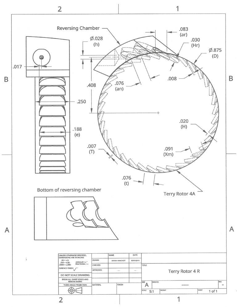

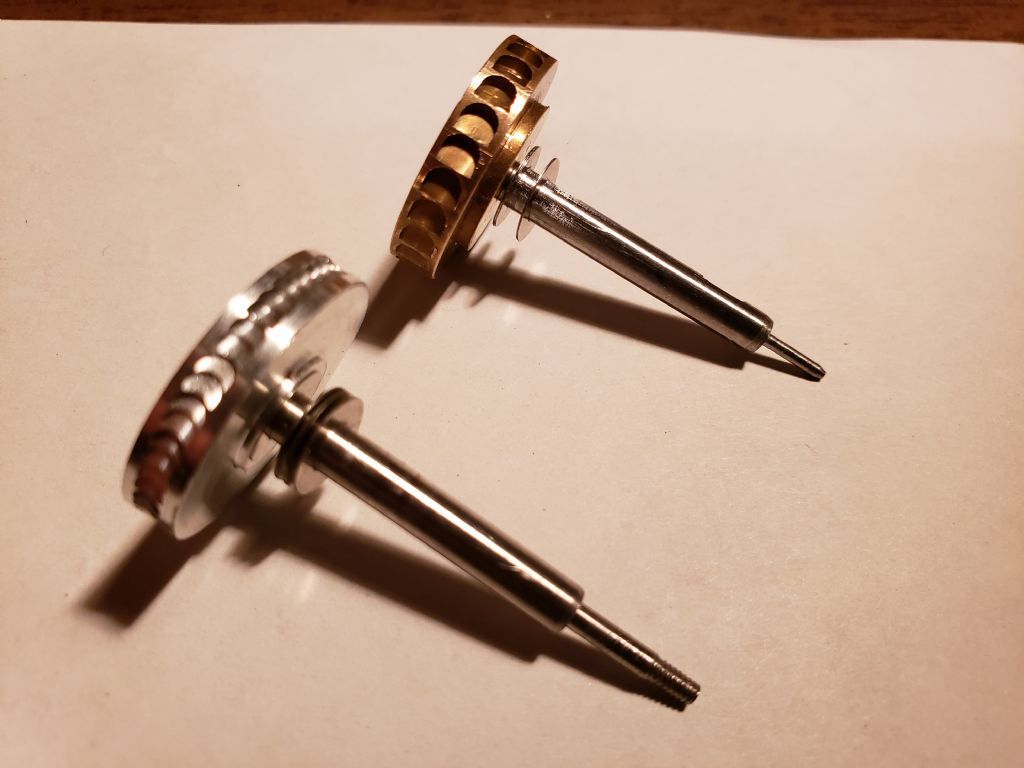

In the post of 08/03/2019 I showed a revised rotor and stated that it could get a rotor velocity coefficient of up to 1.64 times that of my existing turbine rotor. I built this rotor almost as shown on the drawing attached to the 08/03/2019 post. The following photo shows the new rotor (aluminum) next to the original rotor (brass) I tested this rotor with the same air pressure and flow used in the test of my original rotor that had a maximum speed of 17,000 rpm. The maximum speed with the new rotor was 18,250 rpm. The required power of the EP2508 propeller used in these tests is approximately 1.9 watts at 17,000 rpm and 2.4 watts at 18,250 rpm. The average rotor velocity coefficients for these output powers are 0.34 for 1.9 watts and 0.53 for 2.4 watts. The increase in rotor velocity coefficient with the new rotor is 1.56 times. I didn't quite get the maximum I thought was possible, but this is a very significant increase. The original rotor has 24 pockets and the new rotor has 48 pockets. In Dr. Balje's study of high energy level, low output turbines the highest average rotor velocity coefficient for a Terry turbine with a single nozzle and 45 blades was 0.53 The open pockets appear to be as efficient as the Terry turbine blades.
Based on the success of the new rotor that verified the importance of using as many blades or pockets as practical, I’m going to try velocity staging next. I looked at making a Terry turbine with a reversing chamber as shown on the drawing of the 04/03/2019 post. I was able to come up with ways to machine the blades but since the performance of the open pockets appeared to be about the same as with blades, I’m looking at other possibilities. I compared the estimated performance of the Terry turbine with an open pocket design that used two rows of blades on the rotor and an open pocket reversing chamber as shown on the following drawing. Since a new housing is needed, I increased the number of pockets from 48 to 60. I also made the ratio’s of the nozzle admission length (a), reversing chamber admission length (ar), and the rotor pitch length (t) approximately even multiples (a/t = 0.103/.051= 2.02 and ar/t = 0.051/0.051 = 1). With these improvements to the open pocket design, the estimated maximum power was about the same as for the Terry design. The wider blades required for the corkscrew type of flow of the Terry turbine resulted in about 2.5 times the flow length of the open pocket design per stage. Both types allow the flow to expand as it travels, so the length of travel is very important. Dr. Balje’s methods of estimating performance take this into account and were what I used to in my comparison.
I was wondering how you were going to machine the reversing chamber around the whole internal circumference: I had forgotten that you only need a short length. A very elegant design! I hope that it runs well.
