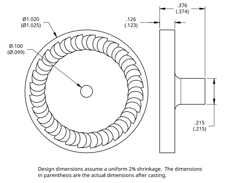

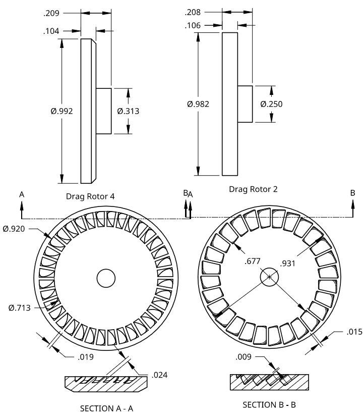

          My Drag Rotor 4 casting finally arrived. The following picture shows a front view of it. The drawing below shows the design dimensions based on 2% shrinkage with the actual measured dimension show in parenthesis. The actual dimensions were very close to the design values again. The larger diameters had the maximum deviation. The 2% shrinkage appears to be a good assumption for these types and sizes of bronze castings from Shapeways. I will start the machining of Drag Rotor 4 on Monday. I have already finished the machining of the rotor shaft. I plan on lining up the casting in the 4 jaw chuck and then reaming the shaft bore with the reamer held in the collet holder using a very accurate collet. I will then remove the casting from the 4 jaw chuck and shrink it onto the rotor shaft. All of the remaining machining will be done with the rotor shrunk on the rotor shaft and the rotor shaft held in the very accurate collet and collet chuck mounted on the lathe head stock. This should ensure that the faces of the rotor are as perpendicular to the rotor shaft axis and as parallel with each other as I can make them. If anyone has a better way to ensure the highest accuracy, I would appreciate them giving it.
          Drag Rotor 4 Cast 2Drag Rotor 4 Cast 1

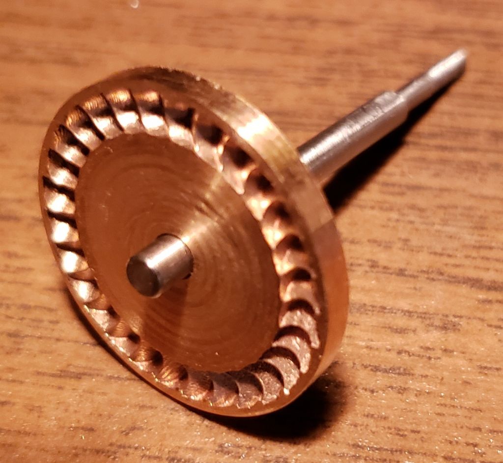

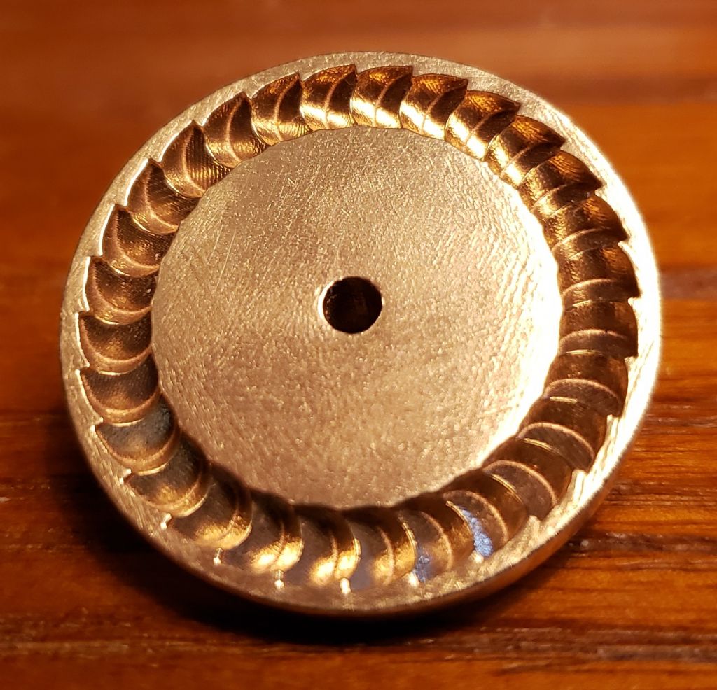

            I finished the machining on Drag Rotor 4 using the methods mentioned in the last post. The following picture shows the new rotor. I tried my first tests with Drag Turbine 4 but could not get a pressure above 2.5 psig even with the face of the rotor pressed against the face of the cover plate. I tried Drag Rotor 3 and the pressures was much lower than I was getting before. I checked for external leaks and couldn’t find any. I plugged the line going to the turbine inlet and turned the airbrush compressor on and the pressure immediately went up to the set pressure of 30 psig and stopped. I turned off the airbrush compressor and the pressure didn’t drop after several minutes. This confirmed that there was no leakage in the lines going to the turbine. I tried blocking the exhaust tube and the pressure only went up slightly. The one positive thing of this test was that the pressure didn’t change with the position of the rotor. I will give an update when I find what the problem is.
            Drag Rotor 4

                I eliminated the binding problem on Drag Turbine 4 but the power is considerably lower than I get with Drag Turbine 3. I thought it was due to leakage but when I press the face of Drag Rotor 4 against the face of the cover plate the pressure only goes up slightly. The maximum pressure when running for Drag Turbine 3 is 4.0 psig and for Drag Turbine 4 is only 2.0 psig. The following drawing shows the existing dimensions of Drag Rotor 2 and Drag Rotor 4. I’m not sure if the reduction in channel size caused by the extra blades and thicker blades prevents the flow from circulating properly. The thicker blades are required to meet Shapeways minimum thickness requirements. The final dimensions of Drag Rotor 4 show the results of taking more off the face of the rotor to try to minimize leakage. Removing more from the face only increased the running pressure slightly, from about 1.5 to 2.0 psig.

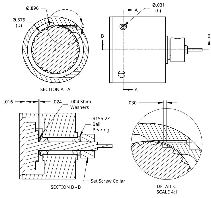

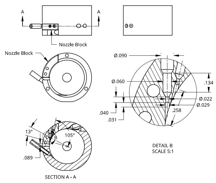

                      I couldn’t come up with a design for the Nozzle Block Castings that Shapeways felt confident they could cast and would be easy for me to use. I thought about leaving a free space above the rotor for the gas to expand into as it goes supersonic. I reduced the clearance between the rotor OD and the housing to help reduce the blowby for the tangential turbines. This was one of the improvements I thought I made when I increased the rotor size from Rotor 1 to Rotor 2 in my first turbine. The following drawing shows the relatively large clearance I had in Tangential Turbine 1. With this clearance, the dimension 0.030 shown in Detail C is the shortest distance the gas would be able to travel after leaving the nozzle before contacting the rotor. This distance is close to what was used to space the rotor from the nozzle plate on Axial Turbine 2 for running on steam. Adding this space made quite an improvement in performance running on steam. To see if the extra clearance was a benefit running on steam for tangential turbines, I thought I would compare the performance of Tangential Turbine 1 that has this clearance with the performance of Tangential Turbine 2 that has very little clearance.
                      The maximum power for tests running on air with the GWS EP 2508 propeller taken from the table shown on the 10/10/2020 Post are 1.2 watts for Turbine 1 and 1.4 watts for Turbine 2. The maximum power for Turbine 2 running on steam at 25 psig pressure with the GWS EP 2508 propeller described in the 29/05/2020 Post is 0.9 watts for Turbine 2. The maximum power for Turbine 1 running on steam at 25 psig pressure with the GWS EP 2508 propeller in a test I ran yesterday is 1.5 watts. Turbine 2 lost 0.5 watts running on steam whereas Turbine 1 gained 0.3 watts running on steam. Turbine 1 was the first of my tangential turbines to actually gain in power running on steam at 25 psig at the low output of my smallest boiler.
                      Turbine 1 Drawing 2

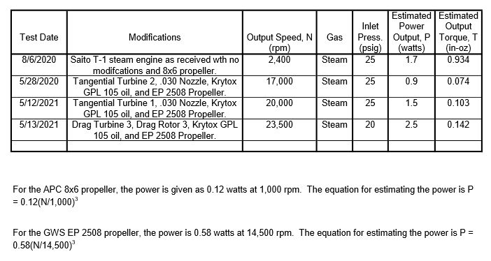

                        I ran Drag Turbine 3 on steam from my Stuart 504 boiler with the GWS EP 2.5×0.8 propeller. I used two wick burners from my Stuart Twin Drum boiler for heat so that the energy input would be high enough to maintain a pressure of 20 psig. The pressure stayed approximately constant at around 20 psig for the entire run. The total time of the run was 8 minutes and 53 seconds to empty the boiler that had a carefully measured 3/4 cup of water added. The mass flow was approximately 2.64 lb/hr. The enthalpy drop for 20 psig saturated steam and atmospheric exhaust is approximately 63 btu/lb. Since I used the valve on the boiler to keep the pressure at 20 psig, the pressure at the turbine was less and so also the available energy. With this mass flow and enthalpy drop, the available energy to the turbine was less than 49 watts. The speed of the turbine remained constant at about 23,000 rpm for most of the run. The power required for the propeller running at 23,000 rpm is approximately 2.5 watts. I ran the turbine on air shortly after the run with steam to blow out any condensed moisture. The maximum speed running on air was approximately 15,500 rpm with a corresponding power of about 0.7 watts. The power running on air was lower than shown on the table of the 09/04/2021 post because of the Krytox GPL 105 oil I use when running on steam. This oil has very high viscosity at room temperature but is resistant to steam and works well at the higher temperatures. Unlike my impulse turbines, the drag turbine performed better at low pressures with steam than with air taking more advantage of the increased energy available. I updated the following chart adding the performance of Tangential Turbine 1 and Drag Turbine 3 running on steam. This did confirm that the drag turbine becomes more competitive with the tangential impulse turbines at low pressure and energy levels when there is sufficient mass flow.
                        Steam Tests 2

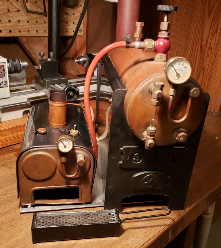

                                  I ran Tangential Turbine 1 on steam from my Stuart 504 boiler with the GWS EP 2.5×0.8 propeller. I used one wick burner from my Stuart Twin Drum boiler for heat. The single wick burner was able to supply enough heat to the Twin Drum boiler to hold a pressure of around 25 psig with a 0.029” nozzle throat diameter. When I opened up the nozzles of my turbines, the pressure could never reach the 25 psig with the single wick burner. The pressure was so low with the larger nozzles I thought that the pressure gage had quit working. I tested the pressure gage and found that it was okay. Using the single wick burner with the Stuart 504 boiler is not as efficient as with the smaller Twin Drum boiler because the larger boiler has so much more mass to heat up and so much more area to lose heat. The following picture shows the boilers side by side and the wick burner I used. I ran this test with the Stuart 504 boiler because it has a valve to control the discharge. I used the boiler valve to find the boiler pressure that gave the turbine its maximum speed. The pressure stayed approximately constant at around 35 psig for a maximum speed of approximately 18,000 rpm. The power required for the propeller running at 18,000 rpm is approximately 1.1 watts. The speed and power dropped off for any pressure above or below 35 psig. The throttle valve will be necessary for running any model that can pull the steam out of the boiler too easily. Throttling the steam allows the boiler to add more energy by working at a higher pressure. The steam downstream of the valve is at a lower pressure but dryer. The dryer steam partially offsets the loss in available energy to the turbine after throttling. Even with the extra losses using the larger boiler with only one wick burner, Tangential Turbine 1 was able to put out almost as much power with steam than with air using my airbrush compressor (1.1 watts vs 1.2 watts).
                                  Stuart Boilers

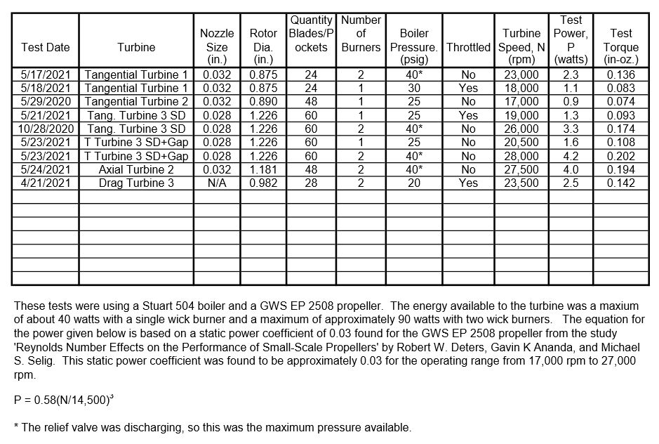

                                            After running the last few tests, I was curious how the torque in the table shown below (copied from the post of 30/04/2020) could be so large. I quit testing the turbines on steam at the higher pressures using the GWS EP 2508 propeller because I thought with this much torque, the speed would get too high. I ran the following test with Axial Turbine 2 using the GWS EP 2508 propeller, the Stuart 504 boiler, two burners, the same bearings of the last few tests, and with the Krytox GPL 105 oil. The maximum speed obtained was 27,500 rpm at a pressure of approximately 40 psig. The throttle valve was fully open and the boiler relief valve was continuously releasing a small amount of steam. The amount of steam released in this test was quite a bit less than the test in the last post. The nozzle in Axial Turbine 2 is larger than the nozzle in Tangential Turbine 3 SD (0.032” vs 0.030&quot so this test had more mass flow than the last test. The power required by the propeller at a speed of 27,500 rpm is approximately 4.0 watts and the corresponding torque is 0.194 in-oz. This power and torque appears to be correct since they are close to the power and torque of some of Werner Jeggli’s test results of this rotor. Werner has a much better testing setup as explained in the 10/09/2020 Post. I ran a second test with everything the same except using the APC 4×3.3 EP propeller. The maximum speed obtained was 5,500 rpm. The power required by this propeller at a speed of 5,500 rpm is 1.0 watts and the corresponding torque is 0.252 in-oz. These values of power and torque indicate the test results in the following table are not correct. I was having trouble getting good readings of speed when running on steam with my first propeller tachometer and changed to a type that is less effected by the steam blowing around the propeller. I will correct this table to show the latest test results.
                                            Turbine Test Results 9

                                              Because I have shown tests performed with my biggest boiler (Stuart 504) and smallest boiler (Stuart Twin Drum), the test results are a little misleading. All the tests with the Stuart Twin Drum boiler were made without a throttle valve on the boiler. As I have recently found, a throttle valve is needed in some cases to get the best performance. Since I am now doing all my testing on steam with the Stuart 504 boiler but sometimes using just one burner to simulate power from a small boiler, I will show the number of burners used and if the flow was throttled. I also checked the nozzle size used for the last few tests and show them in the new table shown below.
                                              Turbine Test Results 14

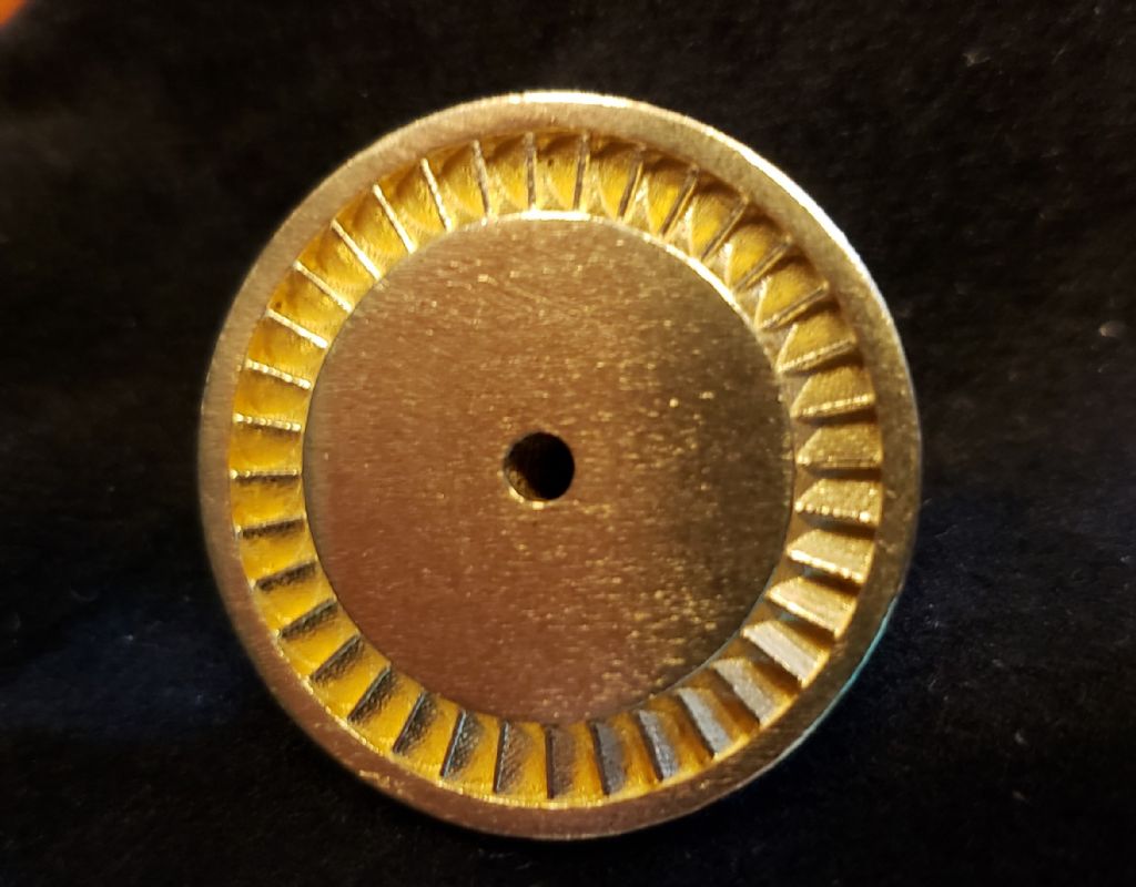

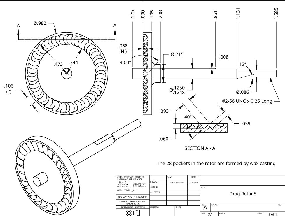

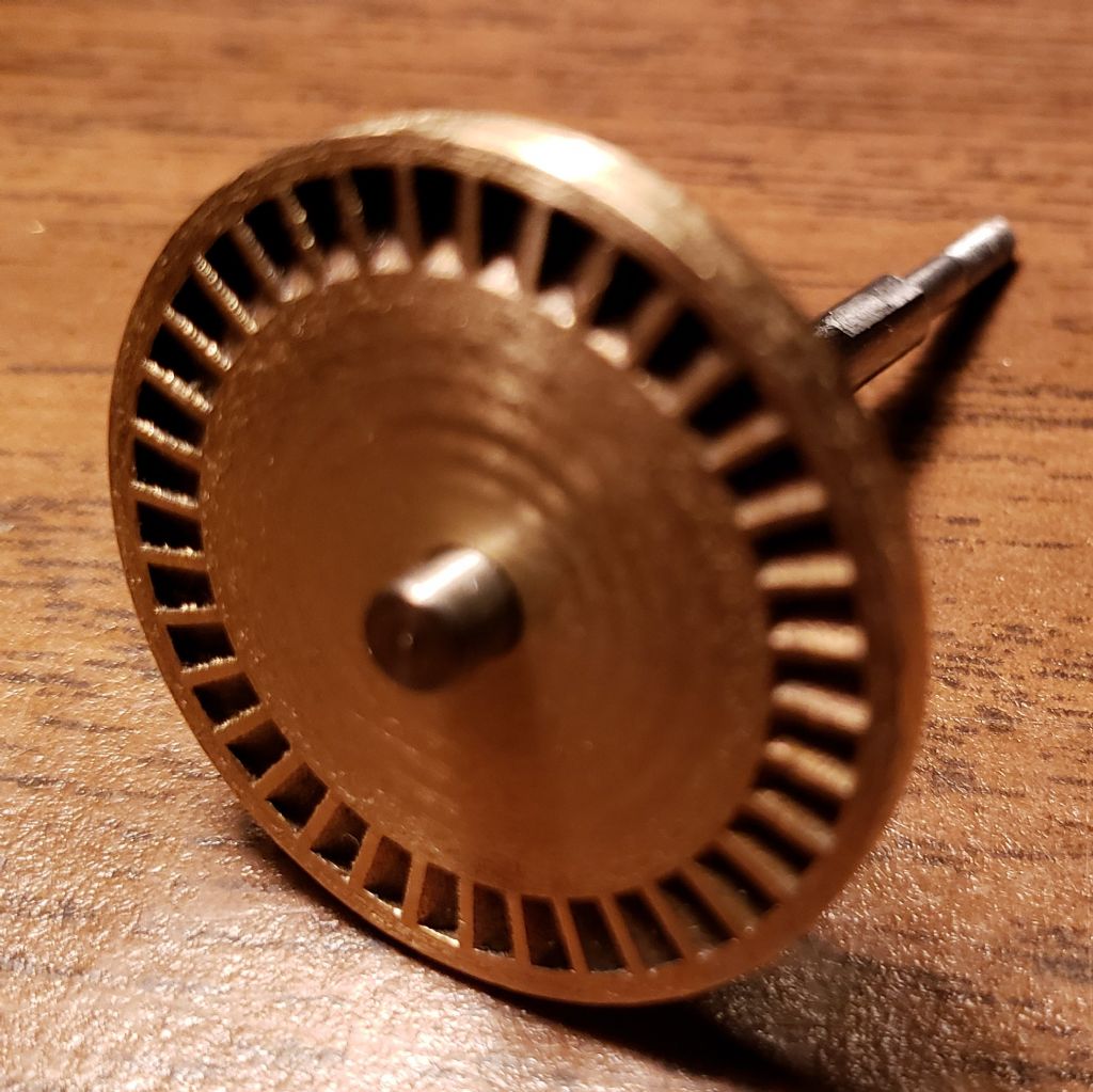

                                                I received the casting of Drag Rotor 5 described in the 16/05/2021 post from Shapeways. The following photo shows the face of the rotor. I hope you can see from the photo that Shapeways was able to make the open pockets very close to what was in the step file I sent them. The edges are sharp and the surfaces pretty smooth. To use the overlapping pockets in a drag turbine, I need to force the gas in the direction it flows down the channel. The overlapping of the pockets results in the center of the pocket having a clearance from the face of the rotor. This clearance will increase the leakage unless the gas has to reverse its direction to move toward the exhaust port. I will show in the next post the cover plate I designed to force the flow to move in the right direction. This is something I think will increase the performance with the other drag rotors.
                                                Drag Rotor 5 Cast 1

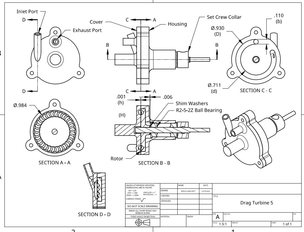

                                                  The following drawing of Drag Turbine 5 shows the new Cover 5 described in the last post. Sections C-C and D-D show the converging nozzle that has been added to the inlet and the direction of the flow. This and Drag Rotor 5 are significant enough changes to be treated as a new turbine. I am hoping that starting the flow in the correct direction will decrease the leakage and help get the corkscrew type of flow started. I also believe that there will be additional torque added by the impact of the high velocity inlet flow contacting the rotor pockets. I expect that there will be an optimum throat diameter of the inlet nozzle for each gas supply source (boiler or air compressor). I also think that Cover 5 will increase the performance when used with my other drag rotors. I have ordered the casting for Cover 5 from Shapeways and it has been accepted for production and given an expected time for delivery of the end of this month.

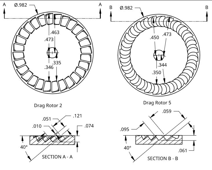

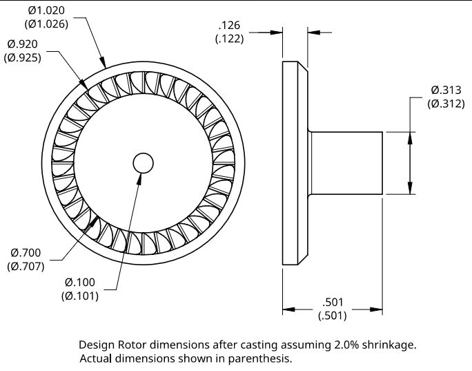

                                                    I measured the actual dimensions of Drag Rotor 5 Cast and added them in parenthesis to the following drawing of the design dimensions assuming 2% shrinkage. The assumed shrinkage appears to be about right for this size and shape. I finished the machining of Drag Rotor 5 and show a photo and a drawing showing the finished dimensions in the next post.
                                                    Drag Rotor 5 Cast 2
