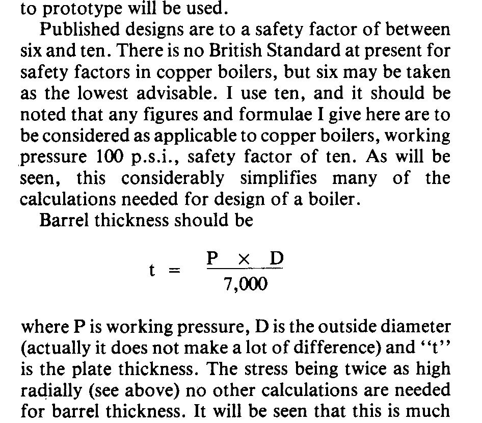

                                                    This bit from Keith Wilson's description of his Bulldog/Dukedog boiler may be of interest (ME 16/5/80)
                                                    A subsequent letter suggested the value of 5000 be substituted for the 7000 above.
                                                    I wonder if the relative safety of model boiler designs is down to the high factor of safety, rather than detailed design.
