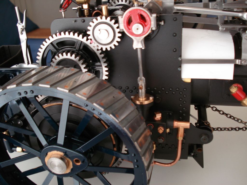

      Thank you Steve, Having been a bit apprehensive about painting this, it's coming together better than I had anticipated.
      Just about finished the front end now, except for fitting the chimney and one stud/nut to replace the c/sunk screw on the top slidebar. The hand wheel for the blower valve was all drilled and filed by eye, so not perfect.-

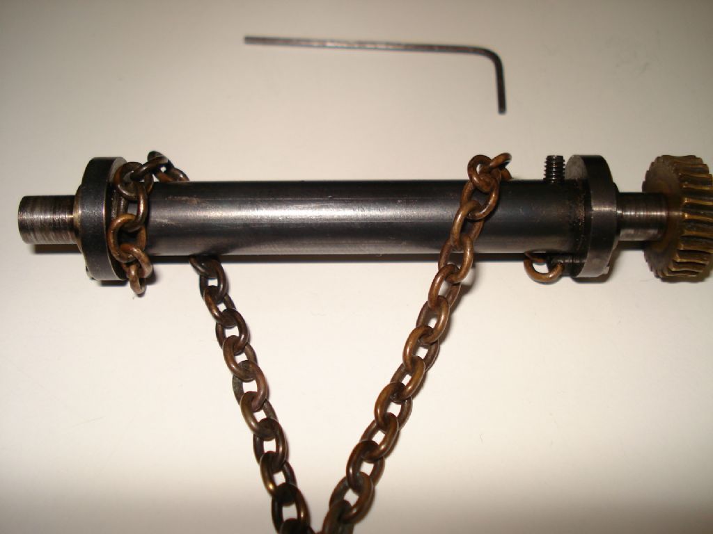

      I made some changes to the design of the chain drum to reflect more full size practice which is now fitted. This drum is flanged each end and the chain bolts pass through these, rather than the drum itself. The worm wheel fixture is secured by a separate grub screw. finish is just oil blackening-

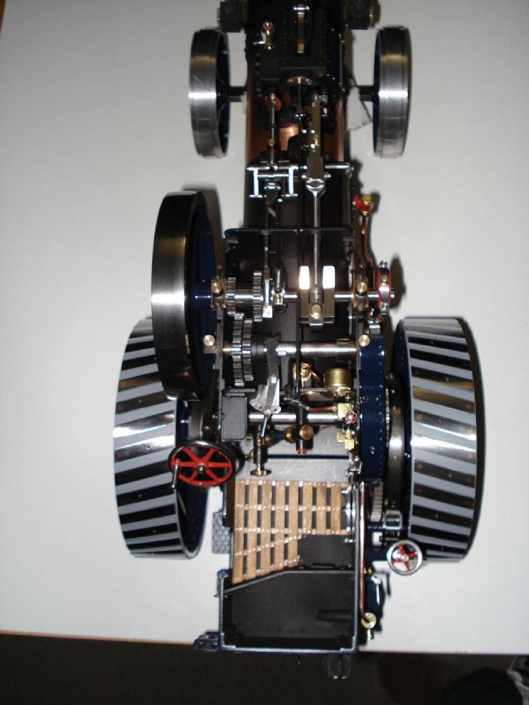

      The redesigned feed pump is now fitted and tucks away nicely behind the rear wheel to disguise the out of scale size. I have to sort a tiny high spot on 2 teeth on the 2nd and 3rd shaft gears(spotted in red). only an issue of slight resistance when they merge, so I can't leave it-
      Getting there.

            Thanks Jon & Phil. Rather a long pause with progress report, had 86 days of hell with replacement windows and scaffolding.

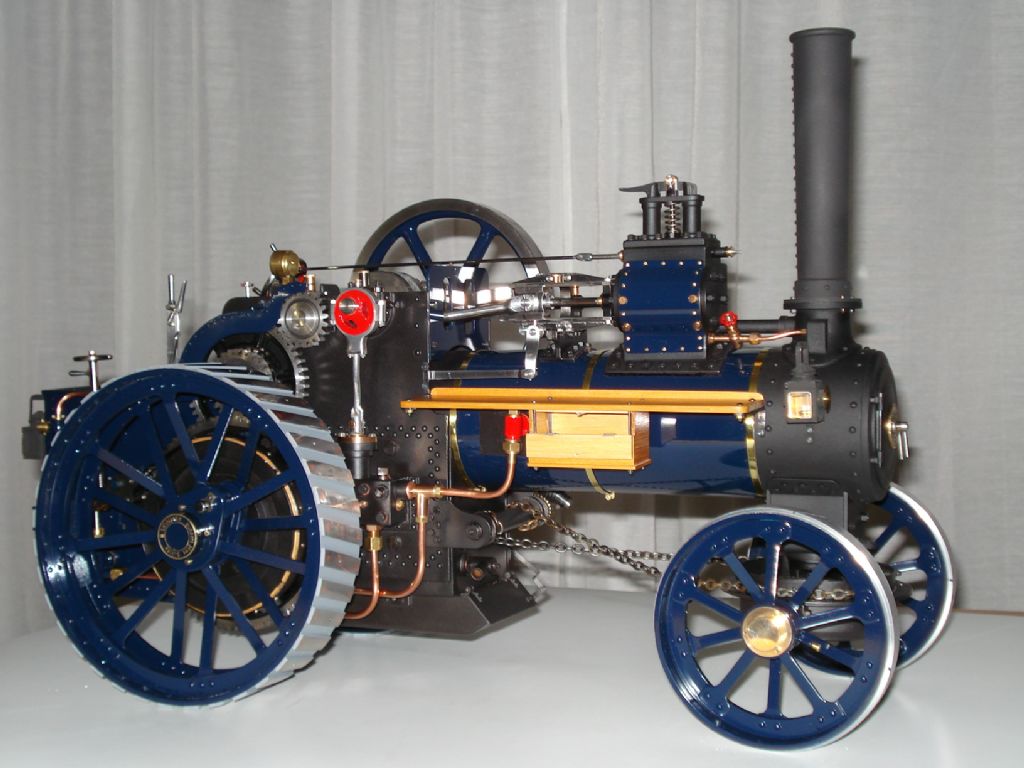

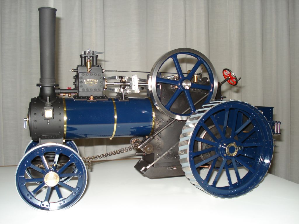

            Spent 2 days last week masking and painting the rim sides and strakes to finish the rim faces-
            Didn't want to paint the strakes, looks a bit tidier.

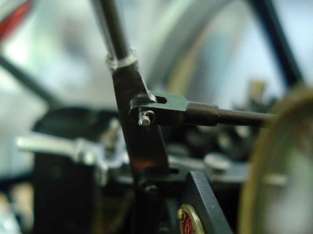

            I managed to make the Regulator Reach Rod dead straight and able to make/fit a crutch fork on the spectacle plate to support it.
            Still doing odd parts, but nearly there with main assembly after painting. Oil blackened the steering worm gear to blend in. No fancy lining etc, I want it basic and plain like a general purpose should be-
            Not fussed with trying to equalise the band spacing on the barrel. Minor failure with the cladding, have a short gap of 0.4mm at the front of the cylinder pad and the L/h cladding sheet somehow?-
            Need to dull the front wheel faces off and various retaining clips & pins to make next.
            Regards

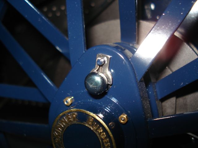

                    It's been a while since my last effort with the race to finish this. Thanks to Joseph, Jeff and Jon for their compliments.

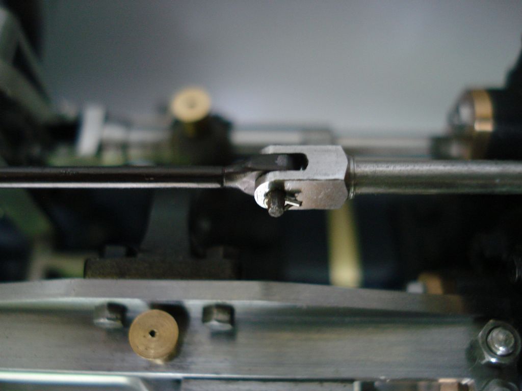

                    Thanks to medication, I can manage short periods working on smaller detail again, so pressed on with finshing the pins and clips. Had to come up with a method to cross drill 3/64th (1.2mm) pins (rivets) with a nbr 78 (0.4mm) hole for the 14 thou stainless wire clips (0.35mm). Worked fine using WM16 Mill and Peatol/Taig and a jig.
                    3 different widths for the cross hole point, one for the damper flap/rod and one each end of the regulator reach rod.
                    Reg rod ends-
                    Also finished the drive pin retainers and clips giving a more detailed finish to the rear hub layout-
                    Regards
