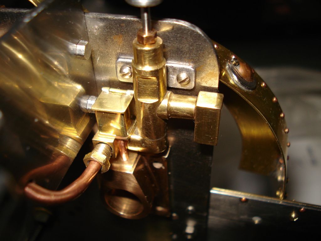

                Would you be able to post me a picture of how you did the blower valve setup into the chimney saddle ?
                Thanks in advance.

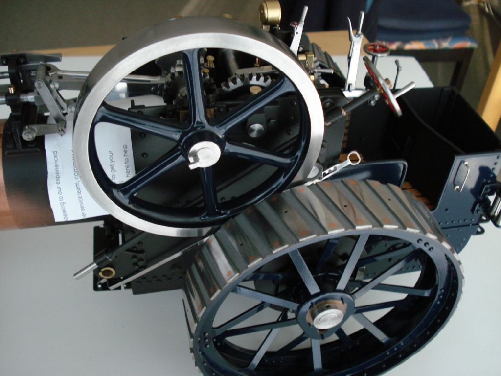

                        Long time, no post!. Well I've had other things on the go and this part of the build makes me go even slower. What with checking, prepping and making bits as I go along, the job of degreasing and etch priming took me ages, as I have to paint outside. It's either the wrong wind direction, temperature, or humidity.
                        I'm now assembling and top coat painting a few bits at a time, being cautious to get the sequence right to account for all my changes. The pump that I redesigned for an alternative mounting tested fine and have played with piercing the eccentric sheave to look like a casting (lots of knob twiddling on the rotary table in the mill) –
                        Detail on the motion work finished, but I will probably treat the bright steel parts and dull them off a bit. Having dulled off the pump eccentric strap and rod, I like the look of it and rids the model of the non scale shiny mirror finished steel I initially put on all the bright bits.
                        I trialled dulling off the steel rim faces on the W & S Water Cart using sulphuric acid and it worked well, so will use that process on the rest.
                        Among loads of tiny bit manufacturing, I recently spent an evening making up a number plaque for the rear plate. It's only 8mm between fixing centres and the numbers are made from 0.025" tinned copper wire and laid into a bed of solder. The numbers represent the boiller's build/tested month and year. Plate is ready to fit-
                        Tender has had it's first top coat, along with a few other bits today, so I'm finally making good progress.

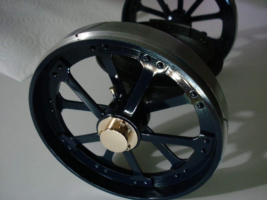

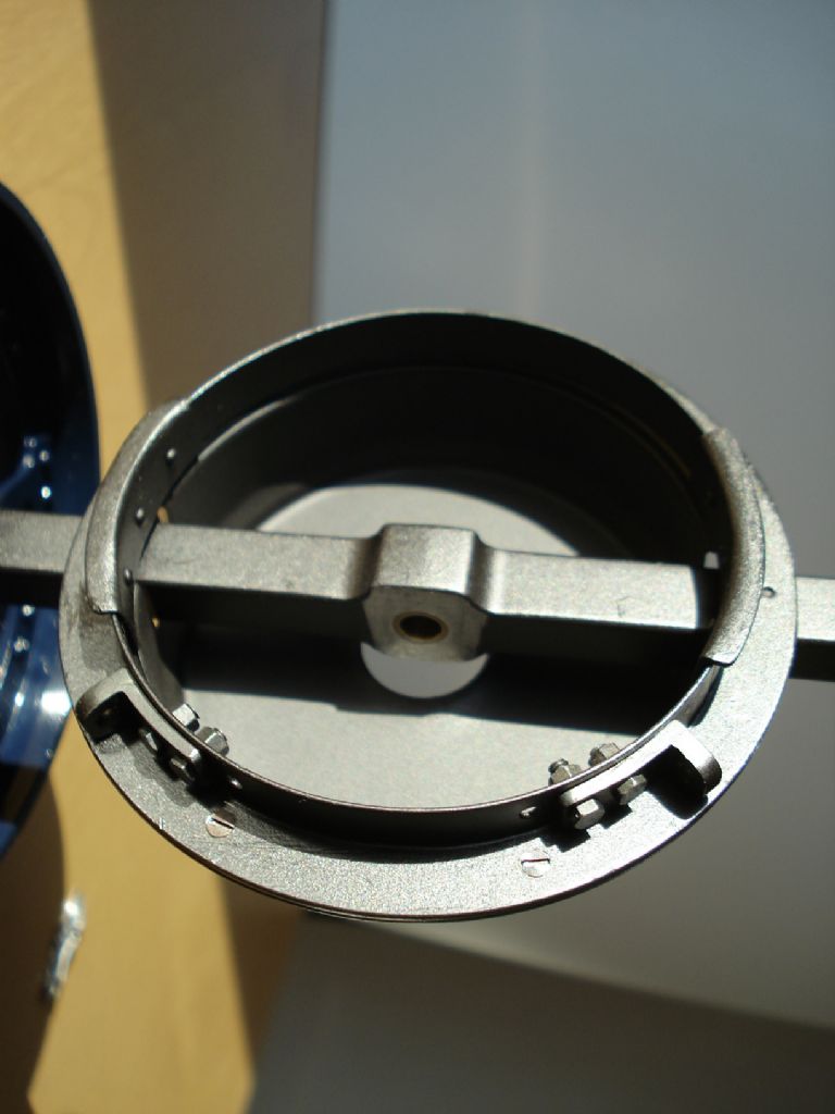

                                    I have finished the front wheels now. Altered the size of the hub caps (reduced) and changed the oiler style-
                                    I decided to stick with a change I considered for the axle and have now finished the Spud ring and pan-
                                    This was straight forward fabrication using visual scale from full size engines. The only problem was finding a way to produce the pan and flange. I found the answer in an old Duraglit tin and used the lid.

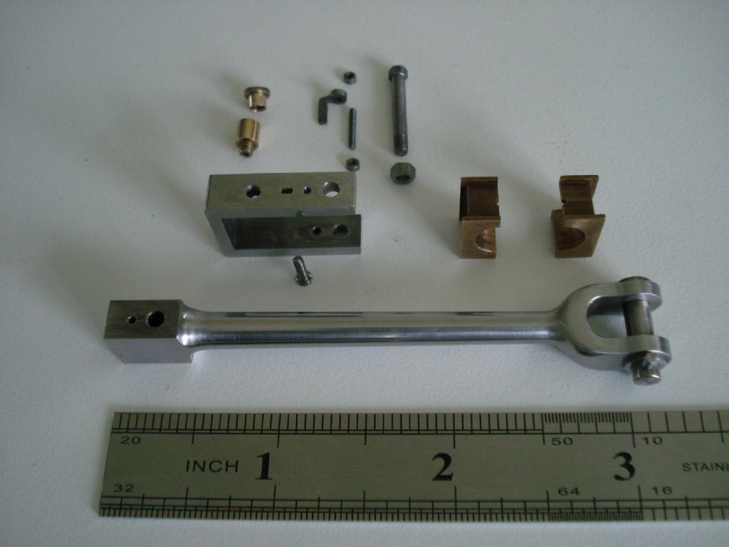

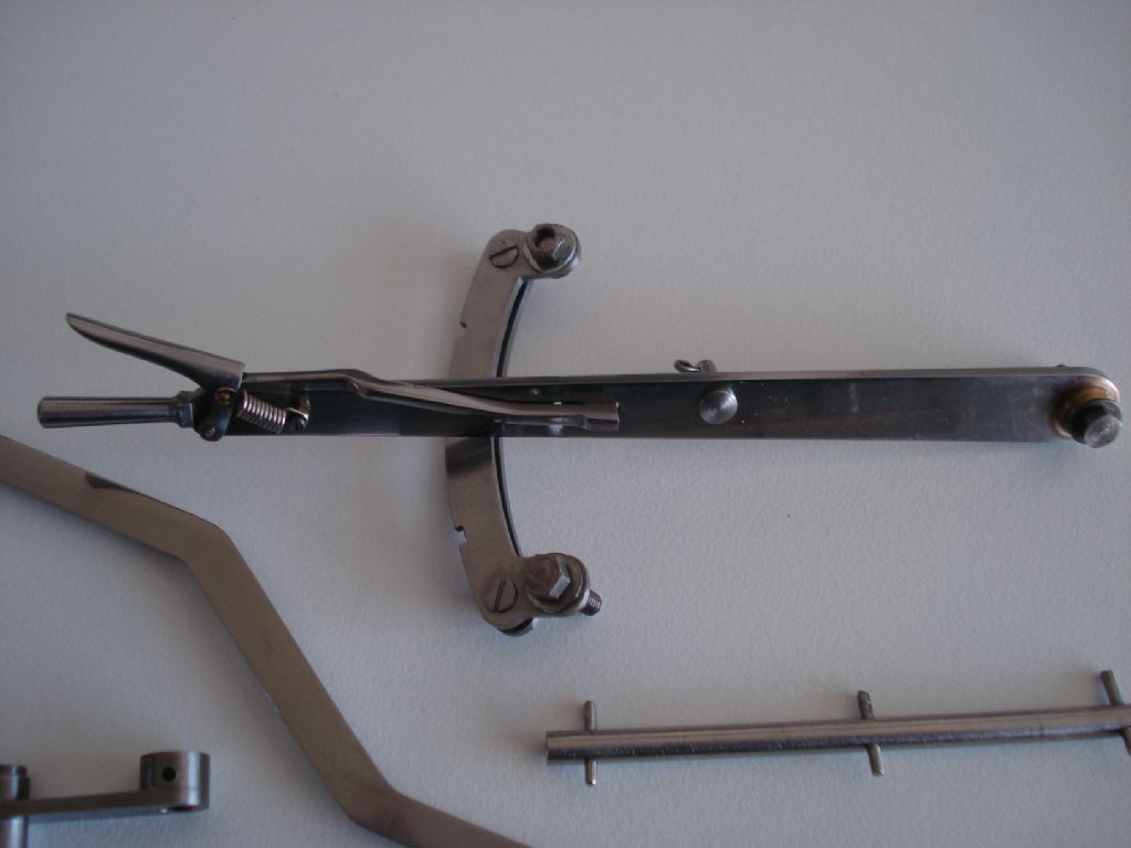

                                    Redesigned reversing lever and motion work pieces have all been fettled now, so ready for assembly-1e1cb4f5-6df8-4c0b-91e0-c0089ff88bae.jpeg
                                    Layout of the con rod parts following closer full sized design-

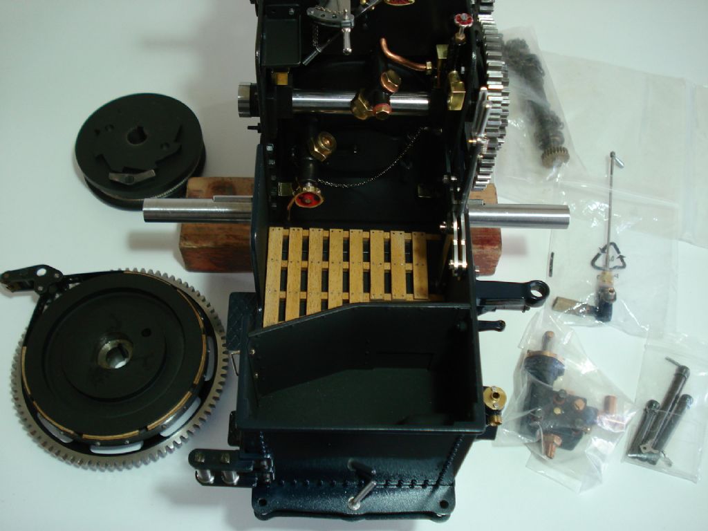

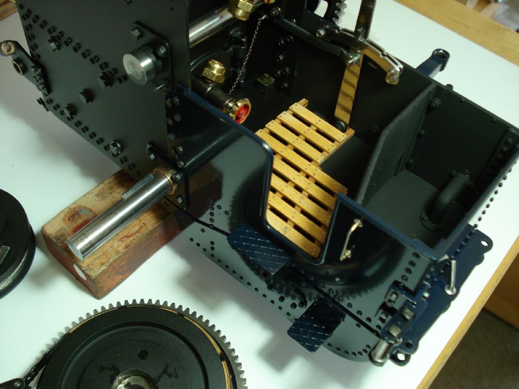

                                      Productive weekend with some assembly work. Fittings on the Backhead area installed. Additional floor plate extends to a closer point to the backhead. Oil boxes have filter screens inside –
                                      Rather tricky to assemble and fit the tender what with the additions and changes, but went ok with just a few touch up areas to the black paint. Altered bolting pattern between tender/hornplates and I produced a raised chequer pattern, rather than cut it into the steps-
                                      Tender was made with 20swg steel sheet (from a 1970s fridge freezer back plate) riveted to 5/16" brass angle. The tank is lined with brass sheet and a stainless floor plate. Rivet are 3/64".
                                      Also managed some more painting of parts today, so for me it was productive for a change.

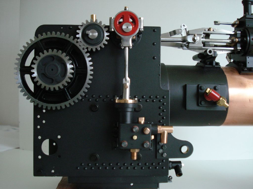

                                        Well, nearly 2 months of frustrating delays to the painting/assembly due to unfavourable weather conditions.
                                        Finally able to set up yesterday and apply the penultimate coat of semi matt black over hot bits at the front end. The chimney saddle and exhaust pipe were painted separately as it is bolted on. This enabled me to apply a consolidation coat over all the Cylinder block joints, stud heads and nuts without access issues, having satisfied myself with the valve timing setting etc (he says with fingers crossed).
                                        Assembly began today of the respective front end parts, some of which are embellished with a bit more detail like the flanged and bolted exhaust at the cylinder end-
                                        Bolt heads to paint, followed by a final black spray touch in around the saddle/smokebox joint. A Clean up of the raised lettering to do.
                                        I settled for a cylindrical locknut on the valve rod with 2 flats on it, which to me anyway, looks less bulky or obvious than a 5 ba nut. The extended regulator rod and gland at the front of the cylinder is dummy of course. I found that there was so much spare metal on the casting, that I decided to turn and file this bit up to give it some detail. Yet to make 2 14ba studs and nuts for it yet (before I put the chimney on) –
                                        I did manage at least to get the flywheel painted last month and really pleased with the finish. Gib key lightly fitted as it has to come off again –
                                        Boiler barrel cladding (nickel silver) has had the top coat flatted down and ready for clear coat, along with the rear hubcaps. So hopefully more progress soon.

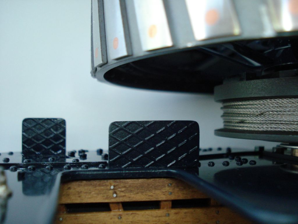

                                                  How did you make the proper chequer-plate profile?

                                                    Posted by Nigel Graham 2 on 31/05/2021 21:02:02:
                                                    Magnificent! Thank you for showing us.
                                                    Thanks Nigel, appreciated. I took the process a stage further and made an embossing block from gauge plate.
                                                    Put the diamond hatching in with a slitting saw with 0.025" blade and about as deep. I then used that to press the pattern into well annealed brass sheet pieces by hitting it with a 1.1/2lb hammer on a block of railway track (my anvil, as I didn't have a press then). After the first impression hit, the cuts line up with the impression to get a 'register' for the next hit (again annealed). Had to put a screwdriver slot in the side to prise the plates apart, as the fit is very close. 3 hits and they were of good impression. I also tinned the top of the hatching so that I might wear the paint away a bit and it will show as looking like steel, rather than brass.
                                                    I still have the block I made over 30 years ago, as I might need it again-
                                                    This is the best shot I can get with my old camera to give a better view of the step(s) –
                                                    Thanks again. Regards.
