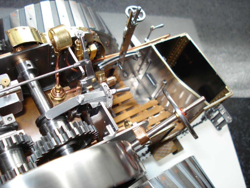

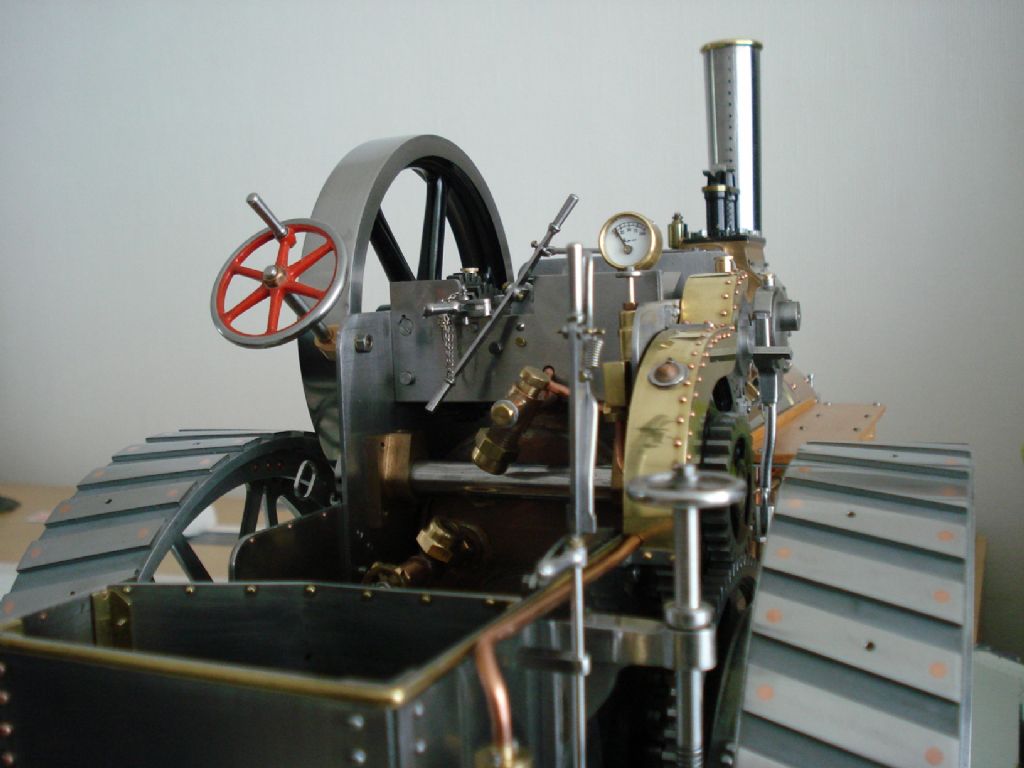

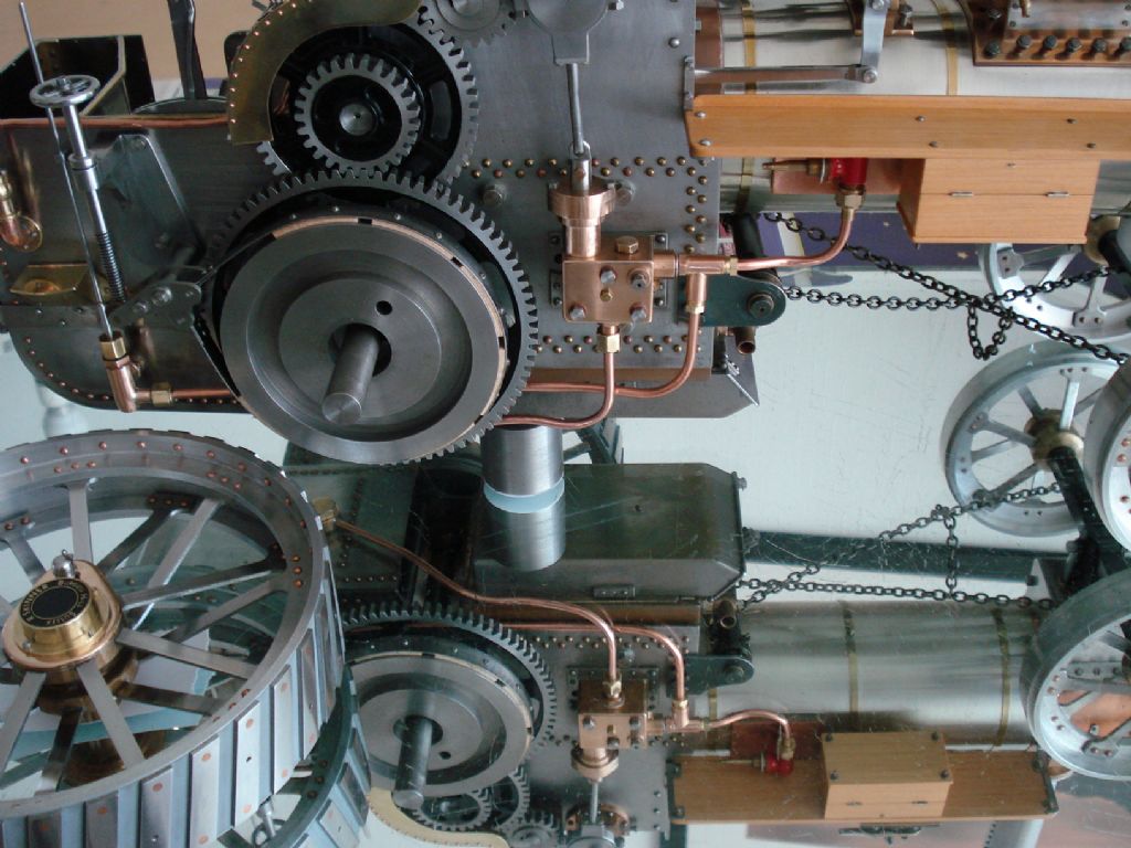

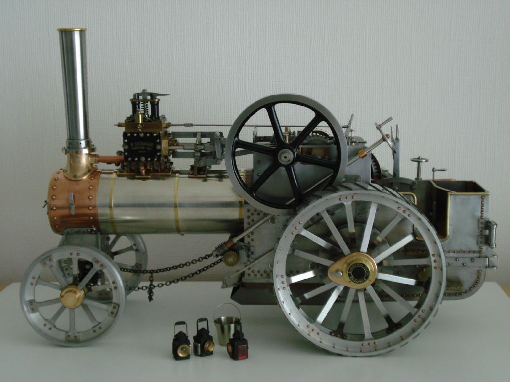

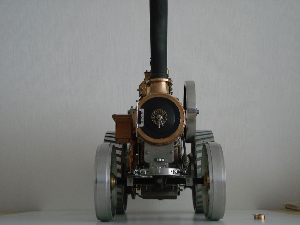

      Returned to this first ever project after 25 years, as I now have time to finish it with the intention of firing it up later this year before prepping for paint.
      Made a lot of extra work for myself with several changes to Mr Mason's excellent design and increased the level of detail. I worked to his drawings for the rear wheels showing 36 Strakes, instead of his written description of 35.
      Main 'working' changes were the Con Rod, Motion Bracket/Ass'y, and Reverse Lever/Rod layout. Geometry is as per original design.
      3rd and Final Gears have additional machining. Scrapped the Brass Tender in favour of Brass lined straight backed Steel design of the 1890's.
      I won't list all of the changes, as those who are building, or have built this Model will see for themselves in the pics.
      Nearly at the point where I will start dismantling it to finish, make and fit some other parts ready for the final assembly
      One thing I have to do at some point is to test the 'Scaled Down' Water Lifter to check the Nozzle angles etc are correct while off the Engine.

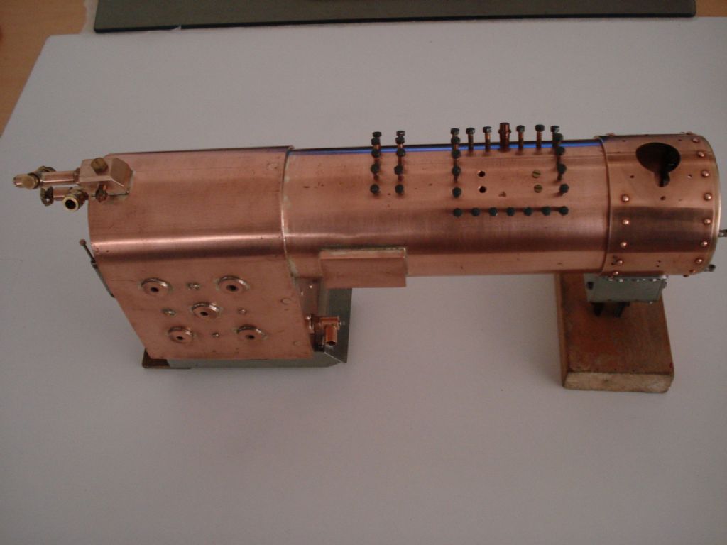

      The Boiler is not my own work. I purchased it in 1986 (Morewood's) and has the 5 bolt fixing into oversized Stays.
      I did not have the skills or equipment to make my own at the time. So I have respect for those who have made, or are making their own.
      Regards

          Beautiful workmanship.
          I have to wonder HOW anyone could make a 35-spoke wheel with staggered spokes…
          #245008
            Gorgeous!
            #245010
              Great work, and excellent photos yes
              #245019
                Strakes Neil, not spokes.
                That is a very nice engine indeed, motion has the look of a Fowler about it and the hornplate mounted pump is a good idea. As you say to those that know the the model the more you look the more details you seesmiley
                Will you paint and steam it or keep it in the bright state and dirt free?

                  Posted by JasonB on 01/07/2016 20:22:52:
                  Thanks All, sorry about the pics with the lack of Depth of Field Focus in macro as my digital camera is 12 years old. Hope it inspires some to enhance basic designs. I love detail and precision.
                  Yes Jason, I will paint it…….. reluctantly!. It will be tested on air initially, thoroughly checked and steamed.
                  I will then clean and prep it for painting. Spooky you mention Fowler!, as years ago I took pics of several at shows for reference and back in 87, I purchased the Etch Primer, Matt Black and Fowler Prussian Blue Gloss Enamels along with Brushing, Airbrush and Etch Thinners from Precision Paints as they were then.
                  I had wrapped them up unopened and sealed them in a large Coffee tin for storage for when ready to paint…… I opened the tin last week blushand all still very good. Hope my Airbrushing skills return easily.
                  I have a question if someone can advise.
                  The Boiler has a Manufacturer's Certificate and the numbers are correct.
                  Am I right in saying I will have to have it checked and re-certified for use when I have finished it?. I would prefer it to be compliant if I have to sell it.
                  Thanks. Regards.     (edited for spelling)
                  Edited By Richard S2 on 01/07/2016 23:34:06

                    Hi Richard,
                    Minnie was discussed in somewhat forthright terms (my own fault) on the modeleng proboards forum recently.
                    I do not want to detract from the superb job you have done, but I would be somewhat hesitent to expect too much in the way of performance if built to the drawings.
                    You will need a new club hydraulic boiler test but to 1.5 times working pressure as opposed to 2 times working pressure. A club steam test pressure test will also be required to working pressure. The original 2 times working pressure hydraulic certificate from the commercial builder should still be valid and accepted by your club. If not then you have to go through the procedure from the start and with the club boiler inspector excercising his discretion. Obviously you have to be a member of a club.
                    Cheers,
                    Julian

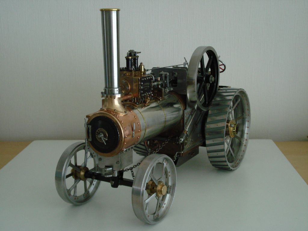

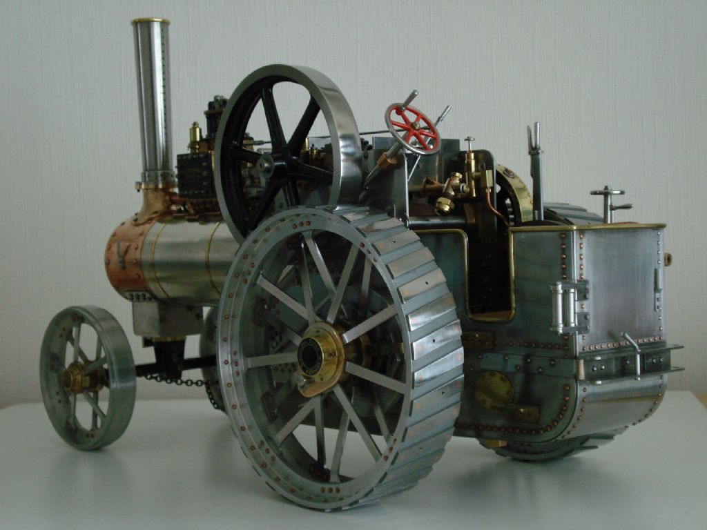

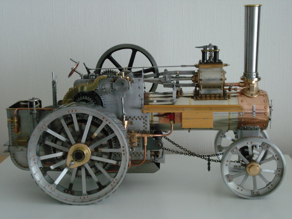

                      I had a chance to take some more full view images of it's current state in natural available light-
                      Regards

                        Thanks for sharing those pics of the complete model – very, very nice. That really is an inspiration for my build – whenever I get it started frown

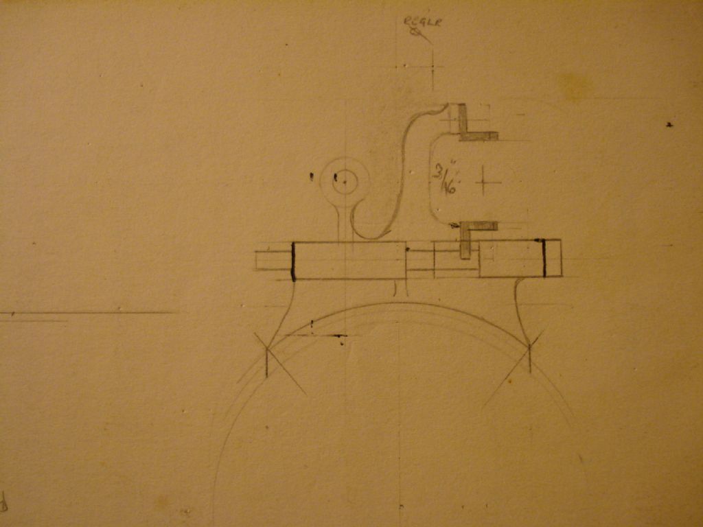

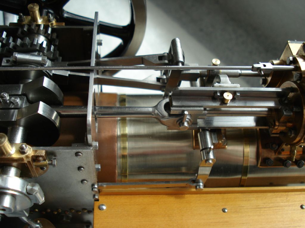

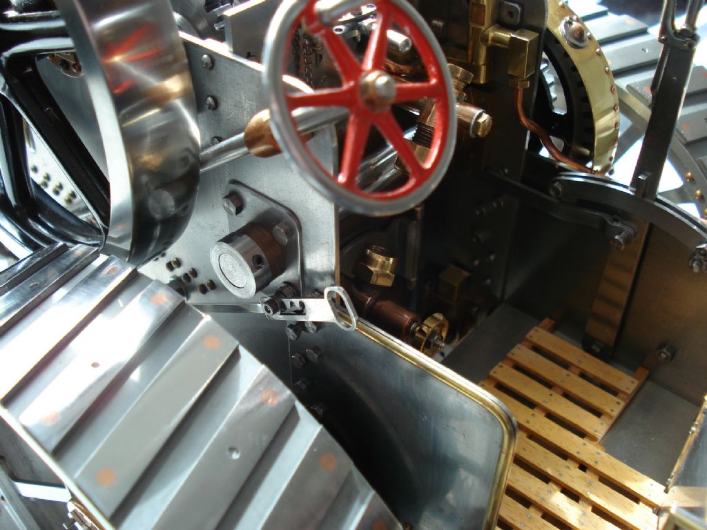

                                Wow! Makes me think about giving up! Well done Richard! Did you make drawings for the motion changes or just used photo research? Could you post a picture of the left side motion works? Considering your changes to my model
                                #256304
                                Richard S2
                                  @richards2
                                  Posted by David Bothwell 1 on 11/09/2016 15:41:56:

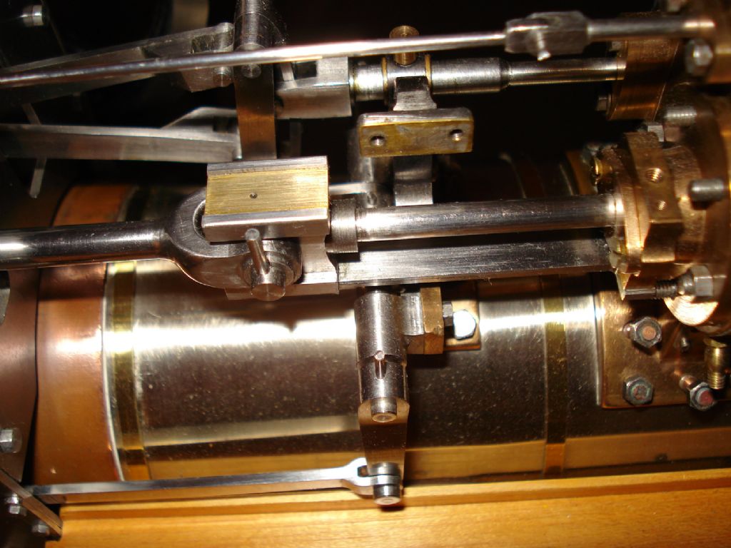

                                  Hi David, Sorry for the delay in response, busy restoring a 1970s American Mower Deck.
                                  I did make some rough feint drawings on slightly better material than a Fag Packet!.
                                  I will try and take a pic of them and the left side as you requested as asap.
                                  I used all of the dimensions of the original drawings to place the Shaft centres of my Cylinder in position on my boiler onto paper drawn in 2 dimensions:- end-on and side view. I then drew in the new Motion Bracket to fit the original Bracket Saddle with a few mods to fit them together.
                                  The challenge for me. being a 'Newbie Dabbler' at the time, was to consider order of machining etc and assembly, so I often visualised it in my head and noted the procedures down as a check list.
                                  I think I had to apply a 0.002" shim to the lower Slide Bar Pad face to cure misalignment when the bolt was fitted.
                                  Slide Bars machined from 1/2" x 1/2" x 1/8" BMS. The Motion Bracket was cut from 3/16" BMS Plate and the 2 Pads pinned and Hard Soldered.
                                  Regards

                                        No problem David, I've managed to produce reasonable images that may help you with your plan as requested.
                                        Please note that I did all this work about 27 years ago, so even I would have to think how I went about some procedures, Hope the rough drawings make sense.
                                        Couple of things to note are that the Weighshaft has to partly pass through the lower Guide Bar and Pad. The Weighshaft bearing tube has to be cut away in that area also-
                                        And the pics, sorry about it being a bit dusty-
                                        One thing to bear in mind is that my Motion Bracket Saddle Casting was machined to account for this modification, so I left as much 'Meat' on it as possible initially..
                                        Hope these help.

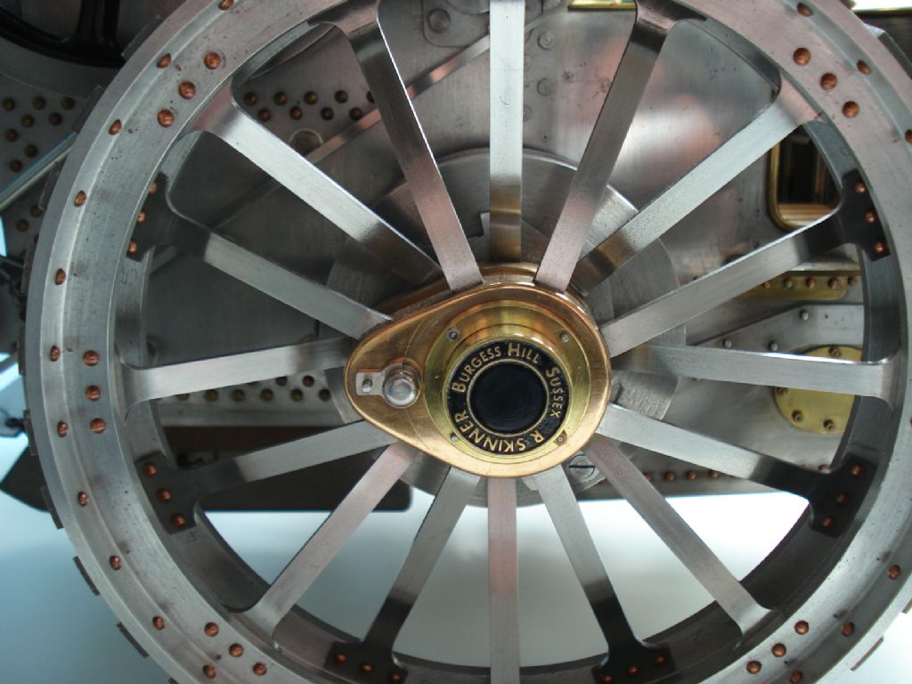

                                            Could i ask how you did the lettering on the wheel hubs ?
                                            I have been looking at doing something similar, a friend of mine suggested using an acid etch.
                                            Thanks in advance,
                                            Brian
                                            #266056
                                            Richard S2
                                              @richards2

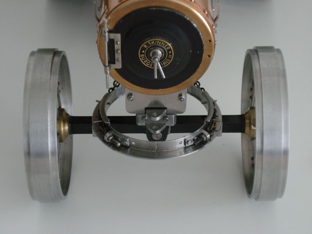

                                              Hi Brian, Good to see you making progress on yours.
                                              Yes of course, happy to explain what I did.
                                              My intention was to produce the same result as proper 'cast-in' lettered castings as on the full size, but with simulated maker info, so I put my name and location on (before they split Sussex into East and West).
                                              My inspiration for this was when I was at the 1986 ME Exhibition, I found a Stand (Model Shop) with a range of Etched Brass Lettering Sheets. I found one that contained just the right sizes made by –dsc01640.jpg
                                              The smallest size is 1.5mm and the biggest is 4mm. I used 1.5, 2 and 3mm letters. Even 30 years ago, I had to use a Jeweller's Loupe to see while I carefully cut them from the Sprues/Sheet .
                                              Firstly, I cleaned the reverse of the sheet area with White Wine Vinegar to de-grease and then 'Tinned' the required letters using Solder Paste before cutting off.
                                              Having measured the thickness of the Etched Letters, I made Hub Covers and Smoke Box Door Plate with recesses a tad less than the tinned letters (few thousandth of an inch). I also lightly 'Tinned' these recesses where I wanted the lettering.
                                              Placed the Lettering as required with tiny dabs of Flux. then laid a piece of thin, flat, heavily tarnished copper to keep the letters in place while I applied the heat to re-melt the 'Tinning'.
                                              To give you an idea of the 'Tinning' thickness, is to tin a piece of brass and lightly wipe off the excess, leaving a shiny smooth surface. Too much, and the letter centres and edges will flood when joining and leave no space for paint depth..
                                              All worked first time and just needed a scrub to remove the Flux residues. Applied a thin coat of enamel paint and left to harden for a week.
                                              Finally cleaned back the paint to the Brass lettering and raised boundary lines using P600 wet or Dry and Washing liquid on a piece of glass, followed by a polish.. Solder paste is/was 188c with Active Flux.
                                              As luck will have it, I searched for Scale Link and still exists in it's next generation guise, but not located in Middlesex anymore. Here is a link if you want the same sort of lettering which is about half way down the page-
                                              -Link-
                                              The Valve Chest Cover Plate Letters are 3mm , 2mm and 1.5mm . I have more to do on that and find a way to make a Number Plate showing my Boiler Number, similar to the Allchin Number Plate. Problem is, these sheets don't include numbers, so I'll have to mess with them.
                                              Hope this helps.
                                              Regards

                                                  My Boiler (commercially built) was tested hydraulically to 120psi and shows the operating/working pressure of 60psi as shown on the Certificate.
                                                  The design states 50 psi as Working Pressure.
                                                  As I have messed with the design and reduced the Size of the Cylinder Bolts, but increased the number, I have ensured I have increased, or matched the Core Area Total of the Bolts for the Cyl-Boiler fixing and Chest Covers when compared with the original design..
                                                  The holding down bolts (studs) are Phosphor Bronze (PB102/CW451K) machined from Drawn Rod.
                                                  I wish to check that my choice of fixings and the quantity are capable of withstanding the apparent extra pressure my boiler is quoted to withstand.
                                                  Can anyone offer me the Safe Tensile Strength of this PB (assuming it is in the fully, lowest annealed state)?.
                                                  The figures from the PB Specs online vary considerably and seem very high, compared to the example Mr J. Haining used in one of his books where he only uses 3000lbs psi as a SAFE figure for Steel !.
                                                  I hope to obtain an Operating Certificate at some point, and as Mr J Atkins kindly gave me the procedure, I need to be happy it will withstand constant pressure of 90psi (1.5 times Work'g Press) when ready.
                                                  Thanks in advance.
