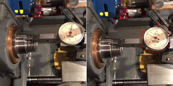

      Recently I noticed that the chuck seemed to be running out of true. I whipped it off and made a measurement with the DTI on the mandrel nose, in the photographs. Due to work commitments I’d not run the lathe for a year or so and during that time I’d changed the motor as the original stopped working. The motor was changed and nothing other than an oil and dust has been done. The lathe is located in my workshop/basement and is not subject to any great changes in temp’ or humidity.

      As for the photographs, these two images show the run-out of the mandrel nose. I have disengaged the cone-pulley to bull-wheel so the headstock mandrel can run free on it’s bearings. It has a smooth rotation and has no discernible play. The movement of the needle is approx. 5.5 thou’ and I’m presuming this is out of tolerances?

                I cannot see how a spindle running in a plain bronze bearing can run this amount of true,unless the bearing is slack and while rotating the spindle there is an uneven "pull "'on the spindle,I would check the thrust bearings at he other end of the spindle it may be these that are rumbling and if they are very worn or damaged ,that end of the spindle may be running well out of true and causing the spindle to run out of true by a lot smaller amount in the front bearing.

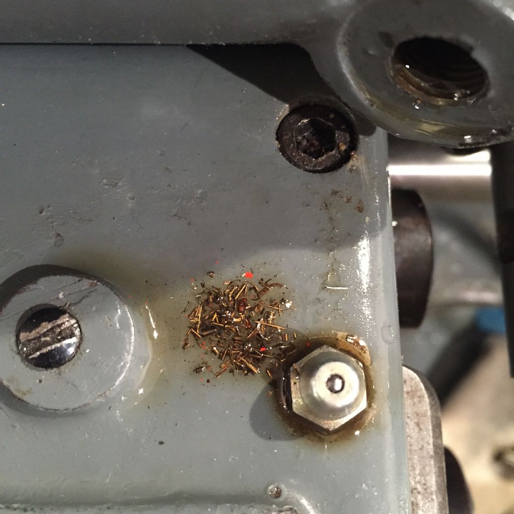

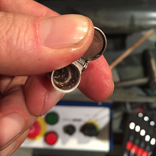

                  ml7rheadstock-03.jpgHi, I checked the oil cup by removing it. Plenty of oil dribbled out of the chamber and collected in a pool on the swarf-tray. Along with it also came swarf? which I presume is from the bearing?? Not sure what to make of it really!!! Is this normal?
                  I also checked the run-out on the rear of the mandrel and it's showing lest than two thou' of run-out unloaded.

                      That swarf does look like bronze, but how can it get up into the oil cup if there is a wick in the way.  Maybe check that there is a wick.   If the bearing was run dry then a bit of trapped turning swarf could scrape the bearing.

                        I have never seen the oiling cup end of the front bearing open before but I would expect to find the end of the oiling wick at that point. It is spring loaded to help keep it up in contact with the bronze bearing and if the spindle has been taken out in its time before the lathe came to you, it might have been removed entirely. Myford sell the replacements.
                        I am though sure it should not be possible to get bronze swarf out of the oiler, the wick alone fills the oiling passage, so I fear damage has occurred and is on-going. You also have far more free play than you should.

                                I can only assume the wick feed in the questioners ML7R has been removed, there is no way bronze could find its way from the bearing into the oil cup normally. One oddity I notice with my S7 is when I lift the sprung loaded top of the oil cup I can see the oil level suddenly start to fall. I can only assume that the spindle generates a vacuum when the top is in place and top cap must seal really well?

                                  "One oddity I notice with my S7 is when I lift the sprung loaded top of the oil cup I can see the oil level suddenly start to fall".
                                  Exactly the same thing happens on my S7. I am sure that John is correct , the rotation of the shaft creates a small change in pressure down the hole containing the wick and spring. I take this as a sign the lubrication system is working correctly as designed and the spindle adjustment at the front cone bearing is correct.
