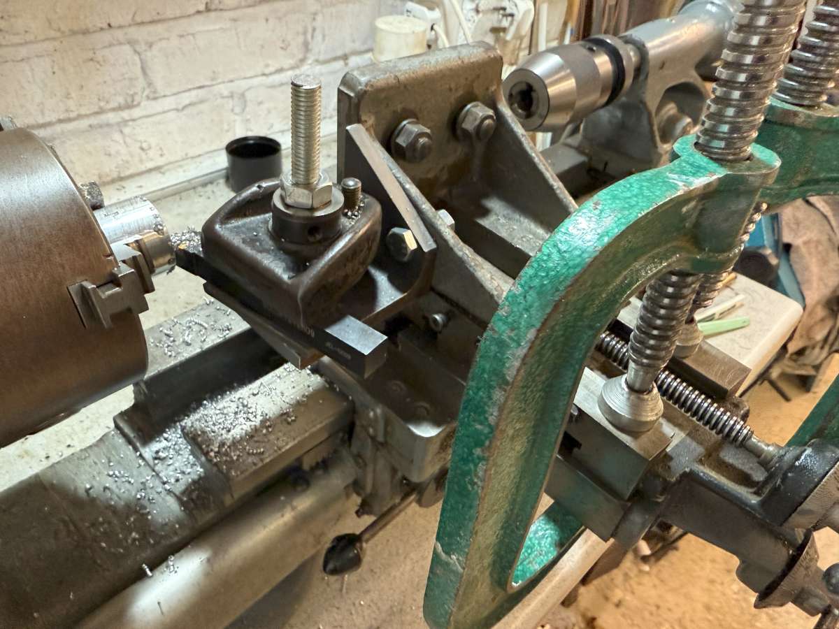

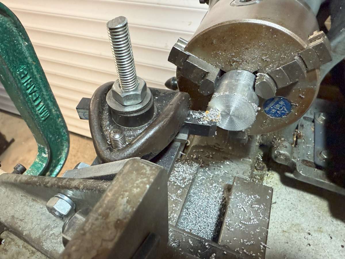

                                          #783236
                                          chrisdavenport
                                            @chrisdavenport
                                            Tried Andrew M’s solution using a vertical slide.  The only thing that needed to be made was a suitable attachment to hold the tool.  It then worked well.
