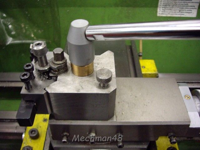

                                      mechman48
                                        @mechman48
                                        I have a Bison clone of the Dickson type tool post, this has an anti-rotation pin facility where the compound slide has a mating hole drilled in to approx' 5 mm depth, certainly prevents rotation chances. I have also turned the tool holder 90* & drilled another matching hole directly opposite for the same effect if I have two tools set up .. rarely.
                                        George.
                                        edited typo's.
                                        Edited By mechman48 on 11/11/2020 16:32:13
