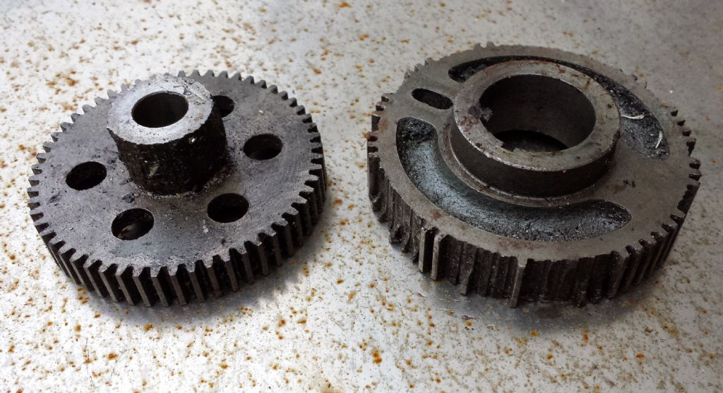

      After a considerable period of time in storage, I've been able to sort out enough space to retrieve my ML7. Had only just bought it when it had to be mothballed, so it has acquired a coat of brown in the meantime, annoyingly; most of it cleans off with WD40 & Scotchbrite at least.
      One thing I hadn't understood when I bought it was that the backgear is trashed – both the bullgear and the smaller gear of the cluster. I've taken the spindle out, but other than undoing grub screws (and in the case of the screw retaining the 25T gear at the rear of the spindle, destroyed it) I can't get much to move.
      I've seen that the 25T gear is press fit – but so far nothing I've tried has moved it. The pin beside the threaded collar should theoretically come out with pliers, but I haven't tried yet. Additionally, the screw retaining the backgear cluster appears to be blocked and I can't get a key into it. Can't quite see what's going on there, unfortunately.
      Any suggestions on removing the gear as well as extracting the backgear cluster, please?

                                    #176285
                                    Peter Bond
                                      @peterbond14804
                                      Finally got around to sorting the photo out –
                                      ML7 backgear & bullwheel
                                      If that doesn't count as vandalism, I need a new definition.
