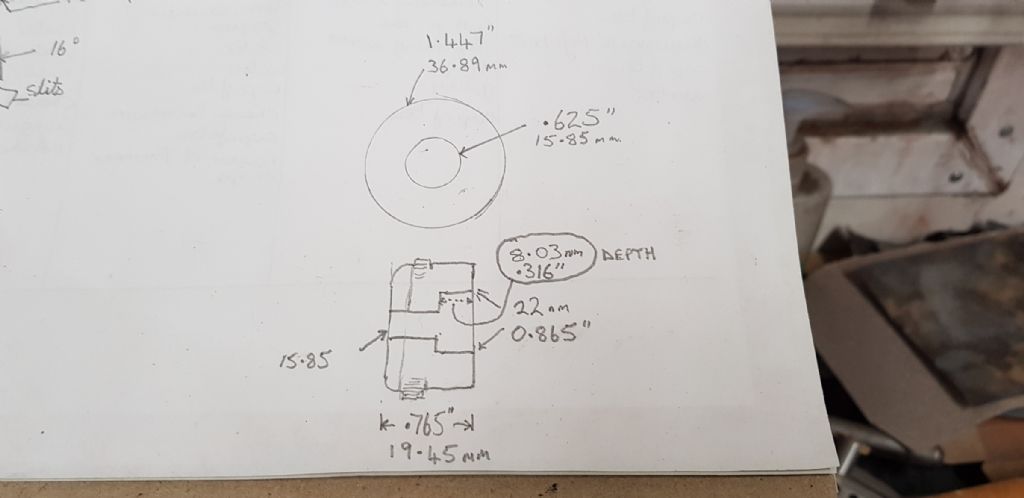

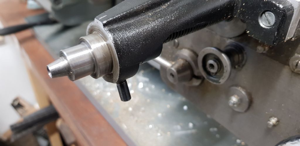

                                        #522790
                                        Steviegtr
                                          @steviegtr
                                          Some pictures for von dutch.
                                          This may help you if you decide to do the mods to yours. These are from my Super 7B.
                                          Steve.

                                          #522818
                                          von dutch
                                            @vondutch
                                            Stevegtr,that is superb,is that drawing the standard size of the super 7 dial,and photo of crosslide is standard super 7 as well ?,if so it looks like I could make a bush for the inside retap it for 5/16 thread on ml7,at brief glance?!

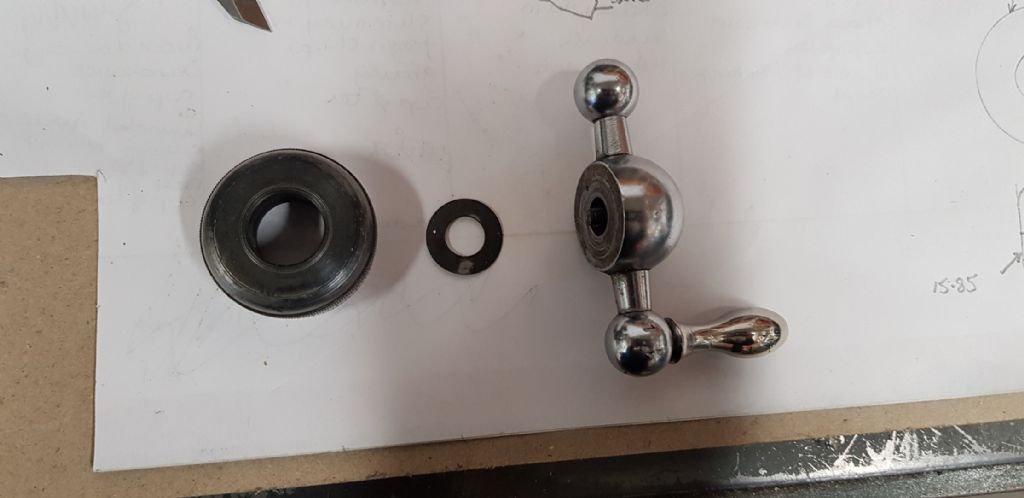

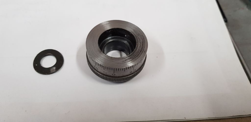

                                            #522834
                                            Steviegtr
                                              @steviegtr
                                              Posted by von dutch on 26/01/2021 17:19:34:
                                              Yes my crosslide is all standard Myford Super 7B. The sizes are all for the standard parts.
                                              The dial is only held in place by the winding handle, which presses against that spring washer. Nothing is threaded, it just sits in position. I am sure you can make some sort of adaptor. I am not sure what the Ml7 parts look like.
                                              Steve.
                                              #522840
                                              Mike Poole
                                                @mikepoole82104
                                                I think the end of the feedscrew is threaded 1/4”BSF, worth checking before tapping 5/16”
                                                Mike
