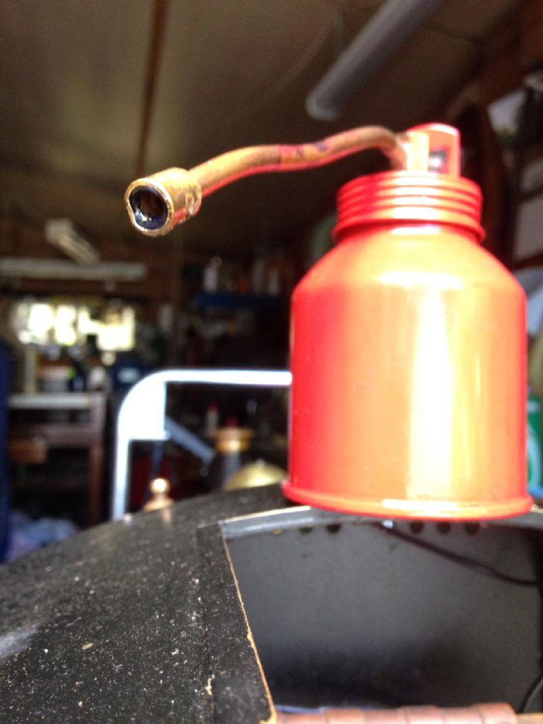

                          Simple oiler I made with o-ring that seals over standard Myford nipples. Works perfectly, cost almost nothing. myford oil can.jpg
                          #590434
                          Hopper
                            @hopper
                            Posted by Simon Collier on 18/03/2022 11:03:47:
                            … Works perfectly, cost almost nothing.
                            The ultimate combination. Well done!
