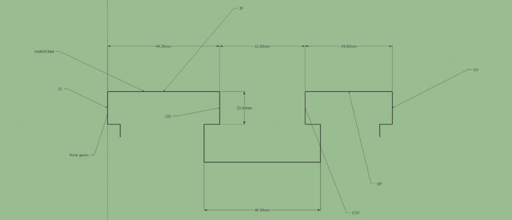

      I thought it was time I checked the wear on Mrs M turned 60 this year. She has been looked after no signs of abuse from former owners
      Ive looked at vids on the subject but they seem to avoid. skirt around the basics
      Short of taking the saddle off the old horsewoman, I am a little puzzled as to what is guiding the saddle, ie which 6 surfaces are the important ones
      given that we have
      outer vertical – OV
      outer flat – OF
      centre outer vertical – COV
      centre inner vertical – CIV
      inner flat – IF
      inner vertical – IV
      assume underside surfaces are for clamping only
      We have the adjustable wearplate in front ofr the saddle, but which is the opposing vertical surface CIV or OV?
      I assume the flat surfaces have no real effect other than to guide the tailstock and carry the weight of the saddle
      So maybe the COV is an unused surface that could be the original datum?
      Sounds too good to be true, but then a twisted bed will give you the tapers
      Would some generous member pls shine upon this mystery

            interessting to note that beds were gang milled on 4 verticals at once on a horizontal m/c leaving a "rough" surface – which worked and bedded in quickly.
            here a sketch of the ML7 bed for clarity. My naive query has opened up an ulcer it seems
            So the question remains, if OV and IV are the guiding surfaces with the gib strip on IV, which of the remaining sheer faces CIV and COV could be used as a datum – assuming they are unused and so unworn?

              CIV and COV guide the tailstock and stop it twisting horizontally. Likely to be the least worn particularly towards the headstock as the tailstock seldom goes there
              #554956
              Mark Rand
                @markrand96270
                At 60 years old, she shouldl be narrow guide. In that case, the rear vertical is unused and can be used as a datum.

                  well these are interesting observations from JB and MR. this will need some practical tests with my dti
                  so by the narrow guide we mean CIV and IV with the back OV being unused
                  So if I changed the bearing from CIV to OV then I would have a brand new surface thats too good to be true?
                  as you can see i am very wary of being misled by choosing the wrong surfaces
