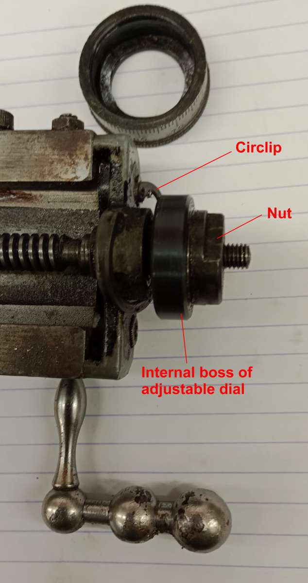

      After a poor session in the workshop it got worse when I decided to rectify the adjustable dial on my cross-slide. This was a late-ish prduct from Myford (not RDG) and is drilled slightly off-centre – useable but annoying. So I thought I would retify it and have dissappeared into a spiral because after removing the circlip, it would not come apart. And of course, I can no longer replace the circlip. Big un-smiley and it makesthe lathe difficult to use.
      Cananyone tell me how this comes apart please? If there were instructions they have long gone.

        Not sure but, are the nut and boss one piece held by a radial grubscrew and copper pad? With similar arrangements it helps to remove the bracket from the top-slide body so you can grip the feed screw to undo the bits on the outer end. On reassembly the bracket screws are tightened last, after you have screwed the feed screw right in.

          Not sure what is drilled off centre but im with Charles the part with the flat on it is in one piece and removal by his method is the way to go. As an aside why is it so tight!!

            Manual can be downloaded here with exploded diagram in section C – I suspect undo the two cap heads holding the end plate on then clamp feed screw in soft jaws and undo nut. I don’t have one though so proceed at your own risk!

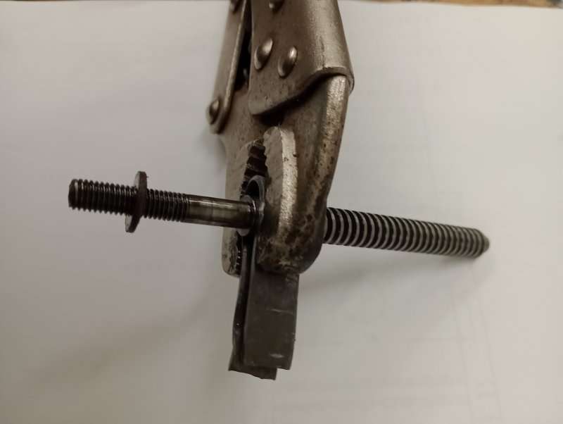

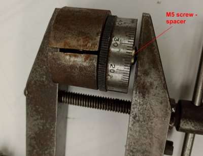

              Thank you to you helpful persons. I bit the bullet and used the mole-grips with some lead strip (protecting the thread) to get the nut/boss off. Then used the tool makers clamp compressing the parts as shown to put the dial back together.
