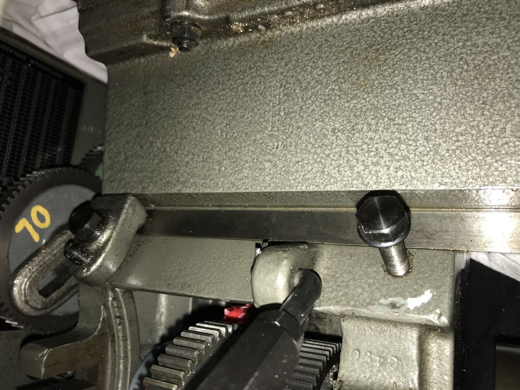

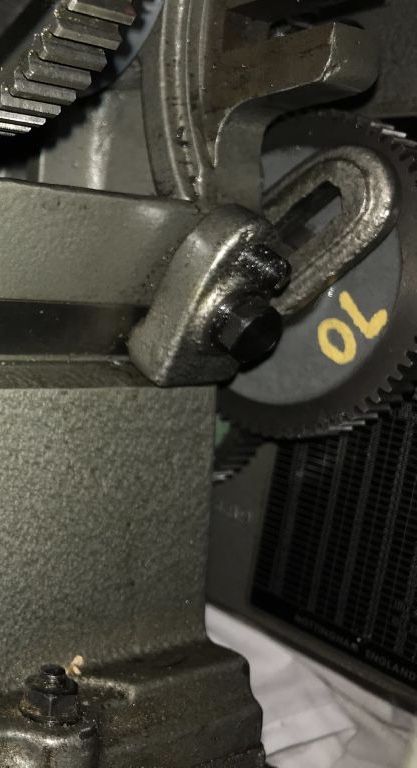

      Hello,
      I have a problem with a missing part. After choosing a ML10 as my first lathe i decided to go and buy one, i found one i was happy with and purchased it.
      After weeks of it sitting i finally got around to having a play, and then i immediately noticed the headstock was loose, and to my annoyance one of the headstock mounts (not sure if thats the correct name) was missing with the bolt rattling around in its hole. I had a very good look around the lathe when i went to buy it, but I did not even think to check if all the mounts were in the correct places.
      Why anyone would remove a mount and not replace it is beyond me, but not the point – dose anyone know where i could buy a set of these?
      I have scoured ebay and the lathe spare part stores including myford, to no luck.
      Thanks for any advice or help

            Just thought, by "mount" do you mean a ring dowel which surrounds the clamping bolt?
            If all else fails, carefully measuring the two holes in the Headstock and bed will provide dimensions to which you can make a ring dowel, if that is what you need. The OD is the important dimension, the bolt can be in a clearance hole through the ring dowel..

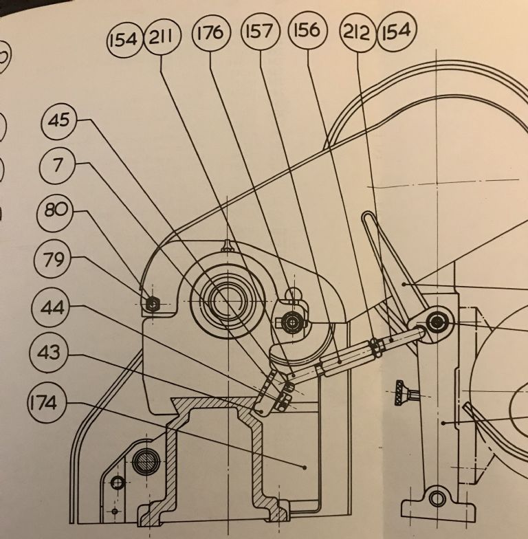

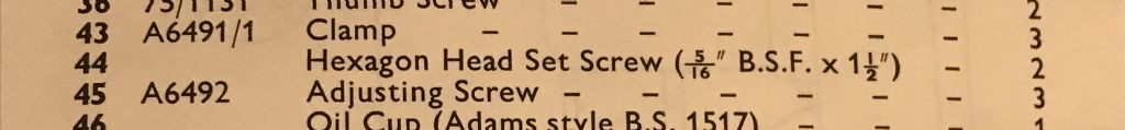

                Hi Ethan,
                Just eyeballed drawing 11690 that I have for my ML10 and it sounds like you'll need item 43 (clamp) Part number A6491/1 plus item 45 ( adjusting screw ) Part number A6492. The bolt you seem to have been left with is item 44 and is 5/16th BSF x 1.5" long.
                Probably best to email Myford, as it may be something they'll have kicking about, but not advertized as so rarely requested…..I guess. But if not, it's simple enough to make….you just have to make sure there's no debris under the front bevel of the bed, which is the clamping reference face. And of course do the checks noted by Howard. I'll try and add a picture of the drawing section…..when I work out how.
                Regards, Allan

                              Thanks gents for the help, much appreciated. Alignment is a job im equally excited for and nervous for, im consuming as much data as i can.

                                Just had conformation the old owner dose not have the clamp, so i will need to find a replacement.
