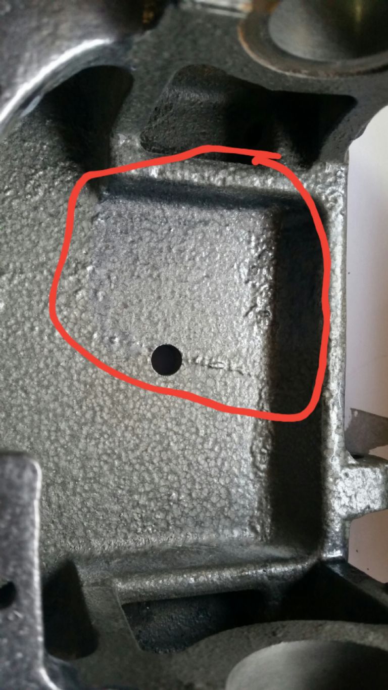

                              I've just bitten the bullet and ordered some of the Dark Grey Coo-Var Hammercote. Next day service saw it arrive today and I'm quite pleased with the match. Please see the photo of my headstock casting below. I thought it best to paint a bit in a not too visible location to try it out. The red circled area is the new paint and if anything is a little darker than the original but that could be that the original paint has lightened up a bit over the years.

                                      Posted by Dave Springate on 19/02/2019 15:30:25:
                                      Hi,
                                      well done – That looks like a good match to me – with a couple of years exposure to suds, oil and sunlight I suspect the new paint will 'yellow down ' to an almost exact match. To do better I suspect you will need to repaint the whole thing.
