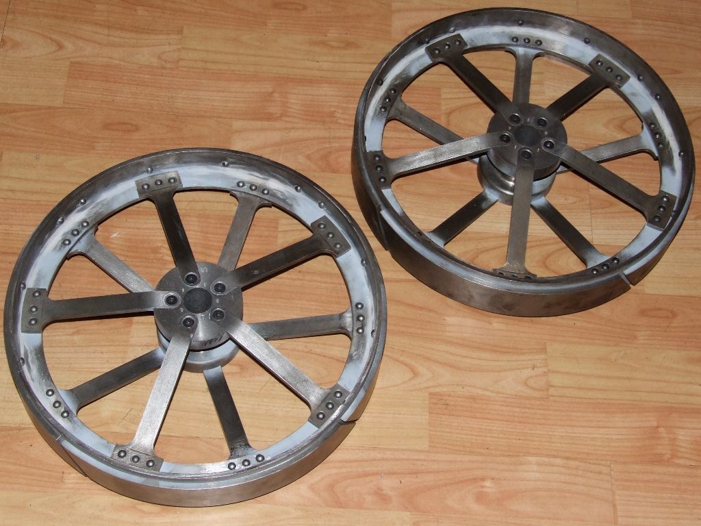

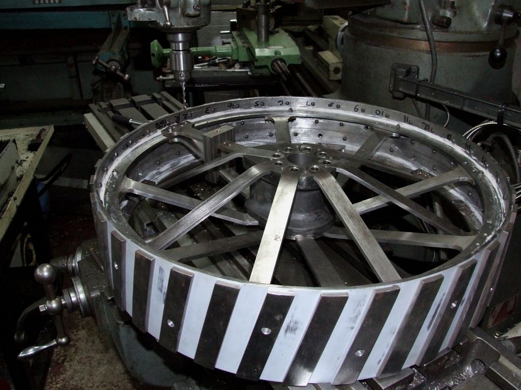

                                      I designed and built my own bending rolls to form the rims, and the plan had been to add a couple of grooves to roll flat bar the 'wrong' way for the T-rings:
                                      For reasons I can't remember I decided against this and bought laser cut quadrants for the T-rings. These quadrants were then arc welded together to form rings. Once rolled the rims were arc welded, and then the T-rings welded in place. I used a fixture to ensure that the T-rings were welded in the correct place, completed T-ring in the background:
                                      The T-rings were an easy push fit in the front rims after welding so my calculations were correct. On the back wheels I had to remove about 15 thou from the rings as I had forgotten that the hot rolled steel used for the rear rims is not accurately sized.
                                      It was a lot of work welding the quadrants together, and the laser cut quadrants were not cheap, so in retrospect it might have been easier to roll the rings as initially planned.

                                        The originals would have been rolled from "T" section but I have only seen this done on one model.
                                        Most are done like Andrew shows with a hoop rolled as one or sometimes two which are trimmed to avoid an unrolled end and then welded. Smaller engines can have the webs cut as "washers" but it is less wasteful of material on larger engines is part circles are nested closer together.
                                        One other option is to mill some through slots into the rim material before rolling and then cut your webs with matching tabs to go into these. You then puddle weld them from the outside which puts less heat into the assembly and you don't risk getting a concave face to the rim. Again not seen this done very often.

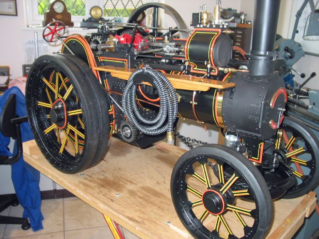

                                                  You may find a few more of the 3" parts that could be tight on the Myford such as brake drum, winding drum, 3rd shaft gear and the cylinder will also be quite a lump so allow for more parts needing larger machines plus the long term how will you transport the engine and some form of driving cart.
                                                  If Fred on TT chips in he made a very nice 3" on a myford and warco mill and borrowed a friends machines for the larger items
                                                  Edited By JasonB on 24/11/2022 10:11:24

                                                    Posted by William Ayerst on 24/11/2022 08:08:47:
