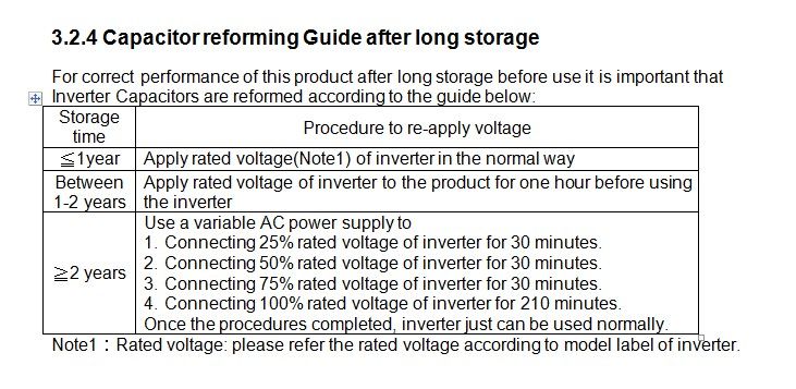

                    peak4
                      @peak4
                      Regardless of whether it will work or not, when was it last powered up?
                      As Neil mentioned, there is always the possibility of magic smoke escaping.
                      This was the advice I received from one particular manufacturer's tech helpdesk.
                      Access to a variac is useful, but it needn't be big enough to supply the inverter under full load, as this is just about applying an increasing supply voltage to re-form the capacitors.
                      I made the enquiry originally having released some magic smoke
                      Hi
                      Please see below guide only may not be suitable for all inverters
                      your decision to try it
                      applying low voltage should not damage the unit if anything it will display low voltage.

                        I think advice on long term storage of a VFD will be found in reputable manufacturers literature. This came to our attention as our stores held extensive stocks of spare drives but as they are very reliable the turnover could be very slow. When I retired a plan to do a regular power up on drives in stock was being put together. The process you have described above was much like the recommended one for our drives. As we held spares for breakdowns it was critical that drives were ready to go, just install and load the parameter backup and go.
                        Mike

                            If a VFD hasn't been used for some time as has been mentioned the electrolytic capacitors may need reforming. However this can be done at a fairly low voltage, say 12v, rather than the full 440v.

                              2) My own VFD warns against not using it for a year or more – the capacitors do not like it.

                                Hi All, thanks for the various bits of information. I should have thought a bit more carefully about the operation of a VFD really, as it's fairly obvious that a single phase input could be rectified to DC, albeit with the potential to retain a few ripples.
                                I think I'll set it up to start gently and give the capacitors a chance to recover, though it's probably possible to replace these if absolutely necessary. I have a very large autotransformer that can be persuaded to give quite a range of voltages so I'll start small and work my way up. At the end of the day this was a freebie so it's not a calamity if it doesn't work, but it would be a real bonus if it does as it would mean i don't need to run an idler motor.

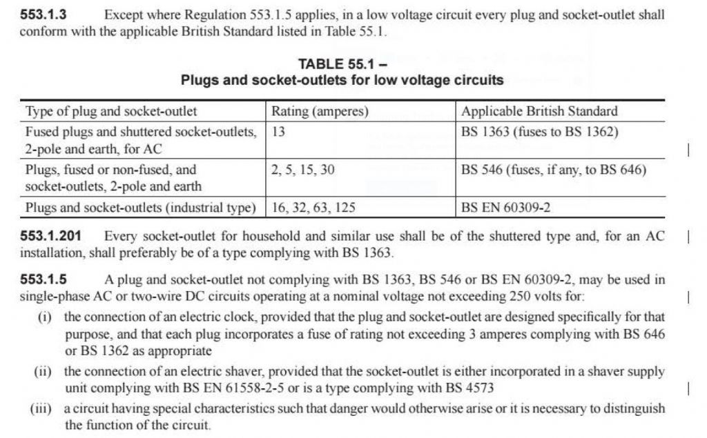

                                  Posted by Simon_F3 on 31/03/2023 09:45:09:
                                  For a power supply my electrician is about to hook up a 40A radial circuit from the RCD-enabled distribution board, which will do for checking this out.
                                  I trust that if a socket is to be provided, consideration has been given to compliance with 553.1.201 of BS 7671.
                                    Yes

                                            Posted by Chris Pearson 1 on 31/03/2023 11:44:28:
                                            I'm not actually sure what you're getting at here, from the relevant section of BS7671:2018:
                                            Operation of a VFD is not "household and similar use", so the paragraph is irrelevant and fitting a BS EN 60309-2 compliant "CEEform" interlocked switch-socket would represent a compliant approach, as per the wording of 553.1.3
