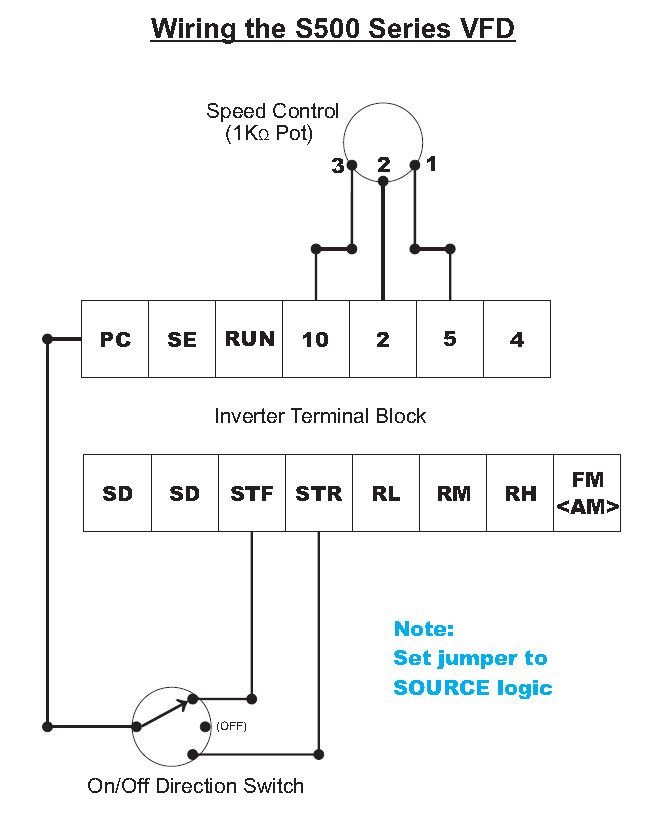

      I have a used Mitsubishi D720 inverter which is OK when operated from the front panel. With a remote control pad connected only the potentiometer works, the forward, reverse and jog functions are dead. I presume that some of my parameter settings are wrong. Can anyone help?

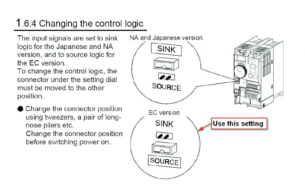

                    I'm using four 500 series Mitsubishi inverters in my workshop. Although yours is 700 series I don't think the wiring is completely different. Here's how I've wired mine up.
                    I hope it helps.

                    Gordon Smith 1
                      @gordonsmith1
                      That's solved it. Swopped the jumper, which strained my ageing eyesight, and the remote now functions correctly. Many thanks.
