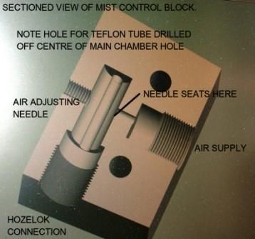

      Pic below sectioned view of the unit I use, all details in my Album.sectioned block.jpg

        Nick, I am saving up for a fog buster setup which does not cause misting (There's a couple of videos on youtube). But it is quite a big more expensive than the vertex setup so I'd be interested how you get on with the vertex set-up.
