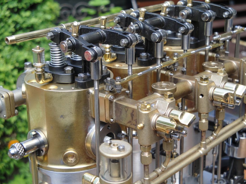

      I am currently constructing a 1910 Fairbanks-Morse RN engine from scratch. I make use of the plans of Pacific Model Design but I build in a smaller scale ( 1: 10 ) My engine is a 3 cylinder in line engine with a bore of 30mm and a stroke of 40mm and has valves in head. It has, like the prototype, 3 carburettors with 4 fuel needles each end low tension make and brake ignition.
      Fairbanks-Morse
      Old carburettors

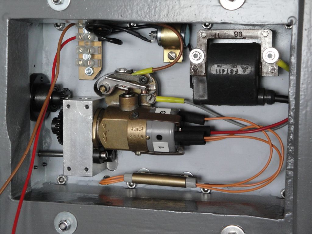

      When I was ready to test the engine it started almost immediately but it proved to bee impossible to get a proper carb. setting. It was also impossible to restart the engine when cooled down due sticky and malfunctioning igniters. Cleaning up the axels and contacts was the only way. I (temporary) changed the ignition to the proved high tension ignition system and used Rimfire plugs in the houses of the igniters, witch are dummies now. The breaker points and distributor are placed in the engine base and driven by a gear train from the crankshaft. These modifications cured the (re)start problems. Next I made a new intake manifold with only 1 carburettor and 1 throttle valve. The carburettor used is an auxiliary air valve type witch gave good service on my earlier Holt 75 engine.
      At last the engine came to life! Starting is excellent now and under load it runs beautiful at 500-600 rpm. But when I release the load it starts to misfire and sounds like a 3 cylinder 2 stroke running idle.
      Slowly making the mixture richer results in galloping and black smoke, while leaning out results in opening the throttle by the governor to maintain a constant speed. Only with a (partly) open throttle the engine runs ”decent” and sounds like an old fashioned caterpillar ( Beautiful ).
      Is there anybody out there to shine a light on my problem?

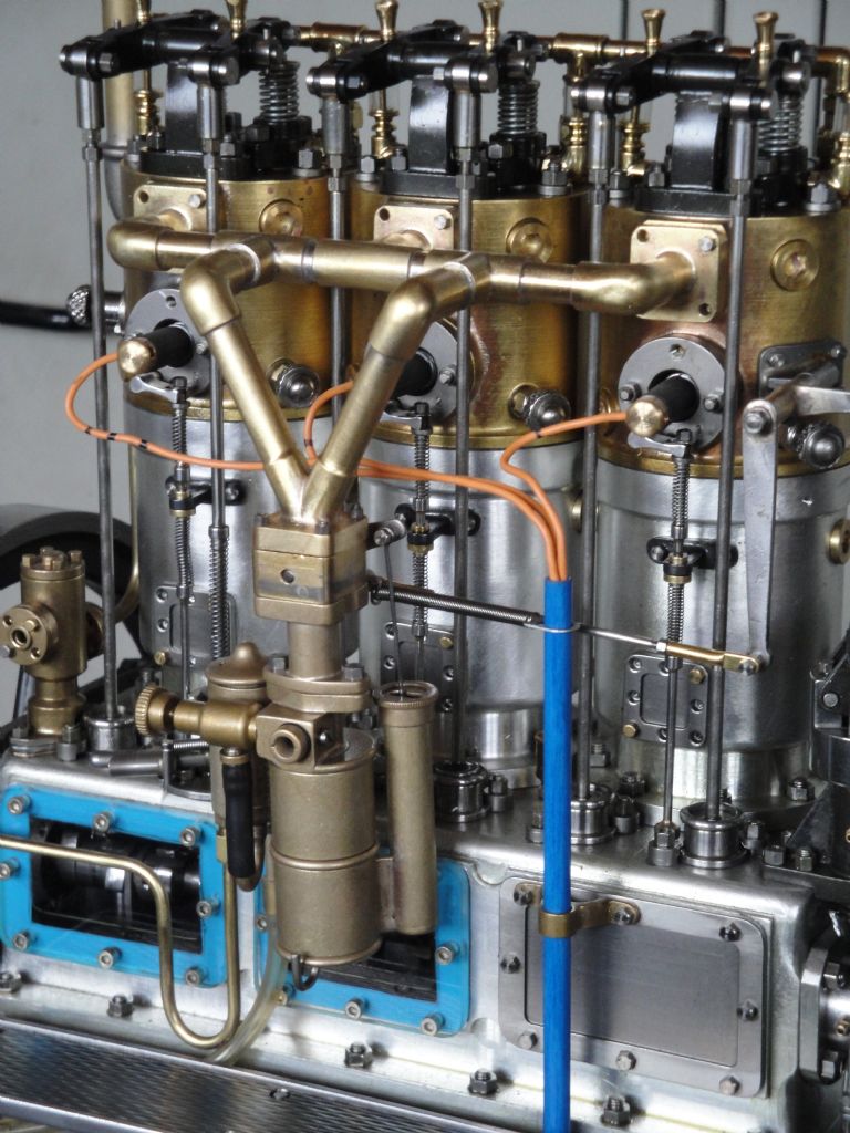

          New carburettor

                Making a guess here, but I don’t know what type of carburetter you have fitted.
                The problem could be something to do with the air flow through the carb.  Too small a venturi and the engine will get too little air, too big, and the airflow through the venturi will be too slow at idle to draw fuel and vaporize it properly.
                From the symptoms, the engine running acceptably at a mid range speed, could indicate the latter, with the airflow then moving quickly enough to get a good mixture.
                Is it possible to eliminate the fuel with the throttle closed and fit an auxiliary jet for idle?
                Ian

                    Problem solved!>>
                    The problem of my misfiring engine is solved last week !>>
                    Preparing my engine for a show I dropt one of the sparkplugs and found the gap totally closed. By opening up the gap again the ground electrode broke. I had no spare plug at hand so I decided to use the plug and tried to start the engine. Much to my relief it started at once and seems to run even better. I opened up the gaps of the other plugs to about 1.5 mm and the engine was reborn. Next day, on the show, the engine ran for 6 hours without any misfire.>>
                    Has anyone an explanation ?>>
                    The plugs I use are Rimfire plugs ¼ x 32 VR2L >>

                        I look at the carburreter induction tubes Johan, they are long and narrow. There is a chance that the petrol air mix is condensing in the tubes and not reaching the cylinders as vapour?
                        I would feel a carburreter at the same level as the cylinder head might be better with much shorter unduction.

                          Clive the problem was with the three carbs, see the second photo, I think tuning those would be harder than tuning a piano. The way motors were built, a three cylinder was virtually three single cylinder motors. Ian S C
