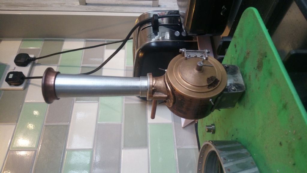

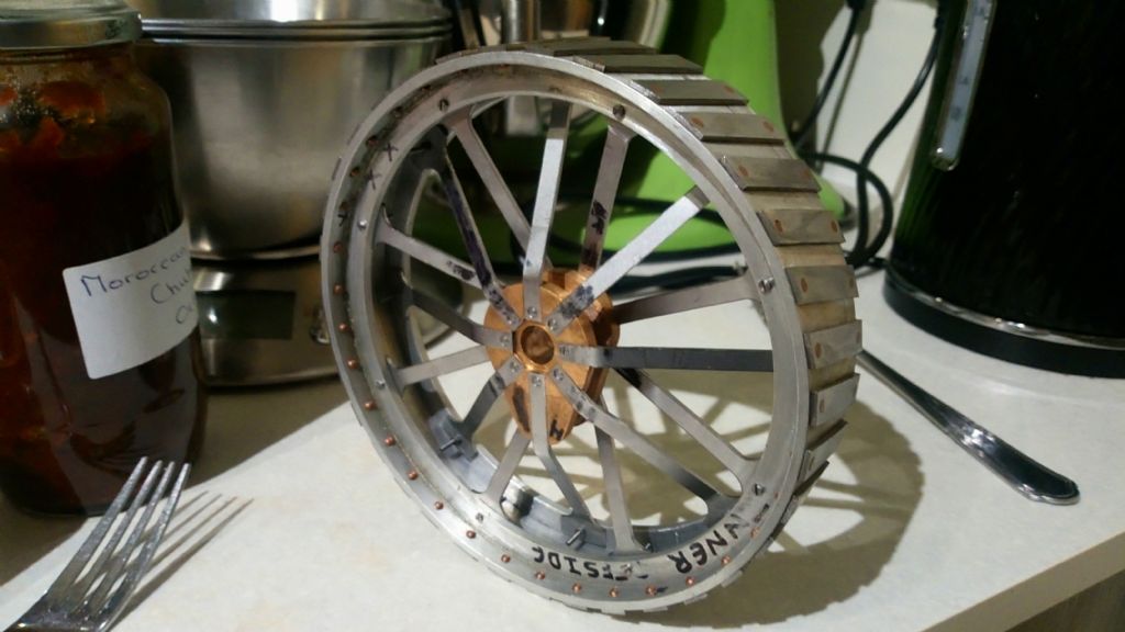

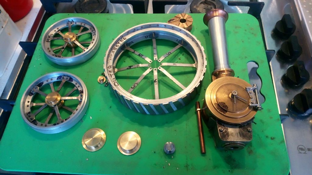

                  #576368
                  james huxstep
                    @jameshuxstep40895

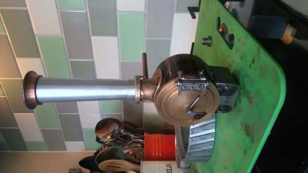

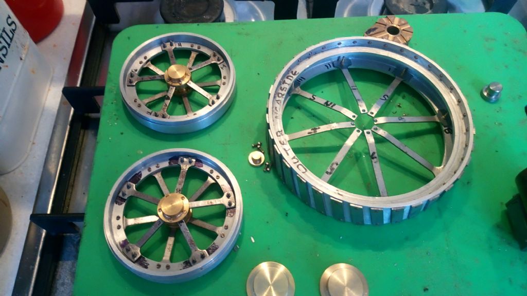

                    Hi all
                    Im stil going!
                    Front end done.
                    Front wheels done
                    Rear wheels almost done.
                    Boiler parts all formed and sent off to western steam to be brazed up. [i chickened out of doing it myself]
                    But im having an issue with the rear wheels rear hub castings. More on that in a minute. Time for some progress photos.

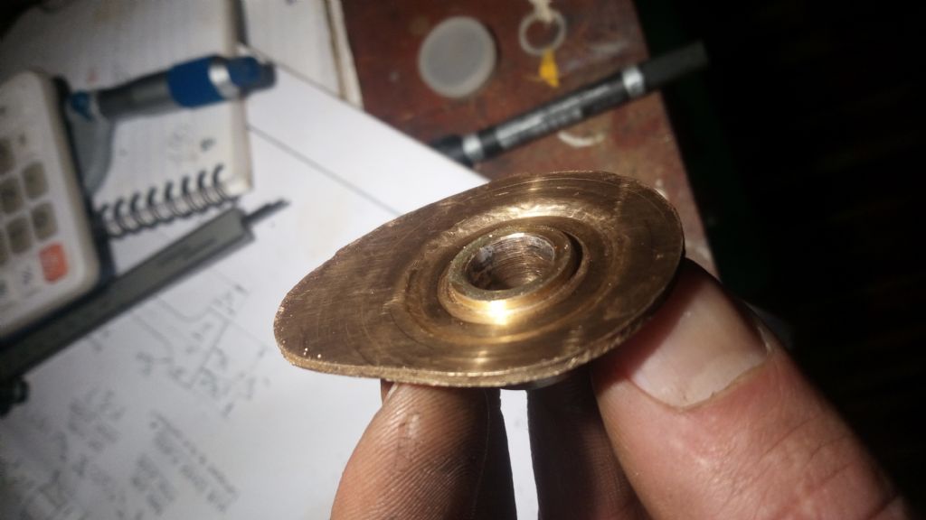

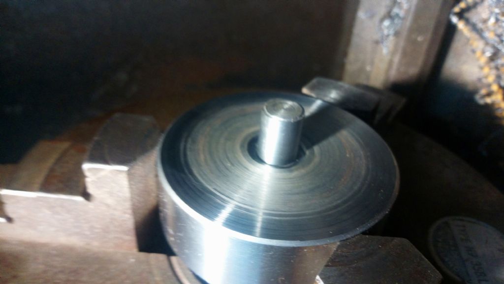

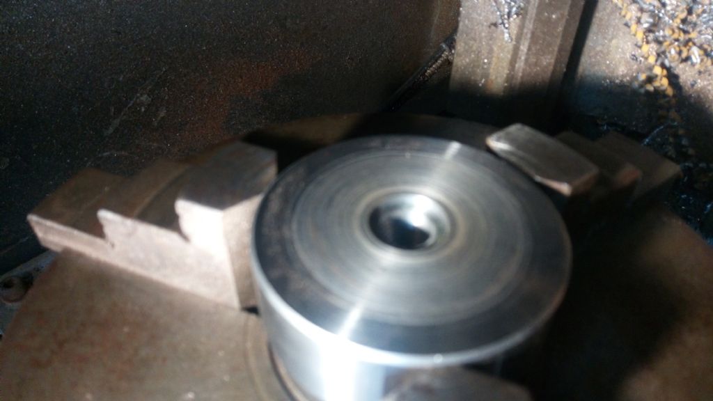

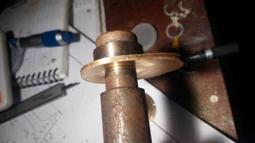

                                ok so onto the issue in hand………
                                Im trying to turn the phos brons rear hub castings but they seem to be flexing/bending/bell mouthing.
                                I first placed the casting in the three jaw chuck with the face that lays flat on the hub facing outwards, and machined that face and the 5/8" 1/16" deep recess that goes into the little pocket on the hub. all good. I then drilled and reamed it 7/16" also all good.
                                The problem was when i made an arbor 7/16" enabling to turn the casting round to machine the otherside. [See pic]
                                I made a good fitting arbor, loctite retaining compound all good. The problem arose when i started to machine the otherside of the 1/16" wide egg shaped face. It began to bend away from me instead of get cut by the tool. grrrrrrrr.
                                ok. fine. i get that. make a better arbor with support behind the thin web so it cant bend away from me.
                                So i made a two part arbor. essentially a large flat surface with a 5/8" recess to take the casting spigot with a hole tapped m12 to take the 7/16" arbor pin. Allowing the casting to lay flat against it so it would not flex.
                                This worked to a point. it then began to bell mouth on the under side thus loosing the nice flat mating surface and my 5/8"D spigot is now no longer protruding like it should..
                                What am i doing wrong? Im using carbide indexable tipped tooling. Loctite high strength retaining compound [allowing to dry for 10mins].
                                Thanks for any help
                                james

                                        #576408
                                        Clive Brown 1
                                          @clivebrown1
                                          I'd suspect that the tool is rubbing and not cutting well. What type of carbide tip are you using and is it in "as new" condition? It needs to be the ground and polished type suitable for aluminium, non-ferrous etc.
                                          A really well sharpened HSS tool might do better.
                                          #576411
                                            Gun Metal can be very soft and unless the tool is sharp will bend away from it, as clive says an insert for aluminium and non ferrous metals will be a lot better so depending on what shape you use thats TCGT, CCGT or DCGT, etc. If you can't get inserts this side of Xmas then sharp HSS will also do the job
                                            Take light cuts about 10thou (0.25mm) deep with a fine feed.
                                            #576443
                                            james huxstep
                                              @jameshuxstep40895
                                              ok i understand.
                                              The tools i used are of the usual carbide indexable tooling. The ones i use for steel etc, there is no special insert ive inserted for non ferrous metals. So thats good to know. Il grind up a hss tool tomorrow, i have ordered a pair of new castings.
                                              Thanks very much for your assistance as usual. Have a good christmas. And il keep you updated.
                                              thanks
                                              james

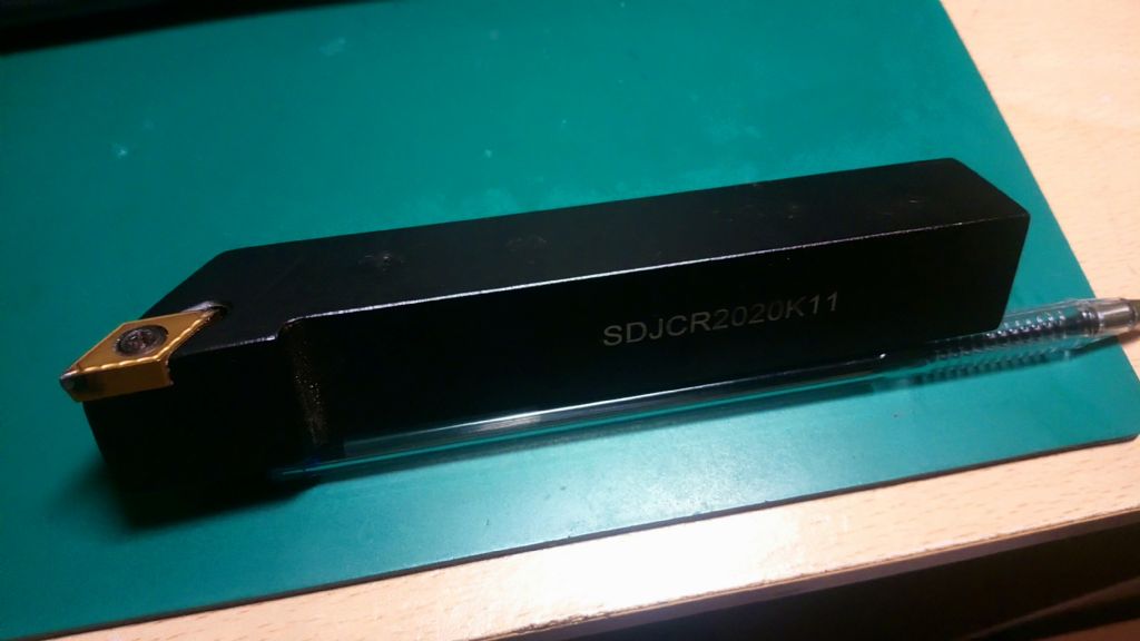

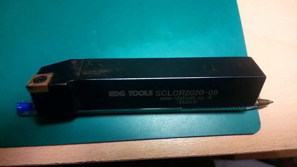

                                                  Ok thanks very much. ill grind up a hss version tomorrow. ill post a couple of pictures of the two usual carbide tools i use. i would like to get some non ferrous cutting tips for these for the future as my grinding skills are ok but not perfect.
                                                  It looks like out of jasons list, that the ally versions i need are DCGT and CCGT. Are the aluminum versions sharper on the tips than the DCMT/CCMT standard versions? Which is why they work on non ferrous metals?
                                                  thanks
                                                  james
