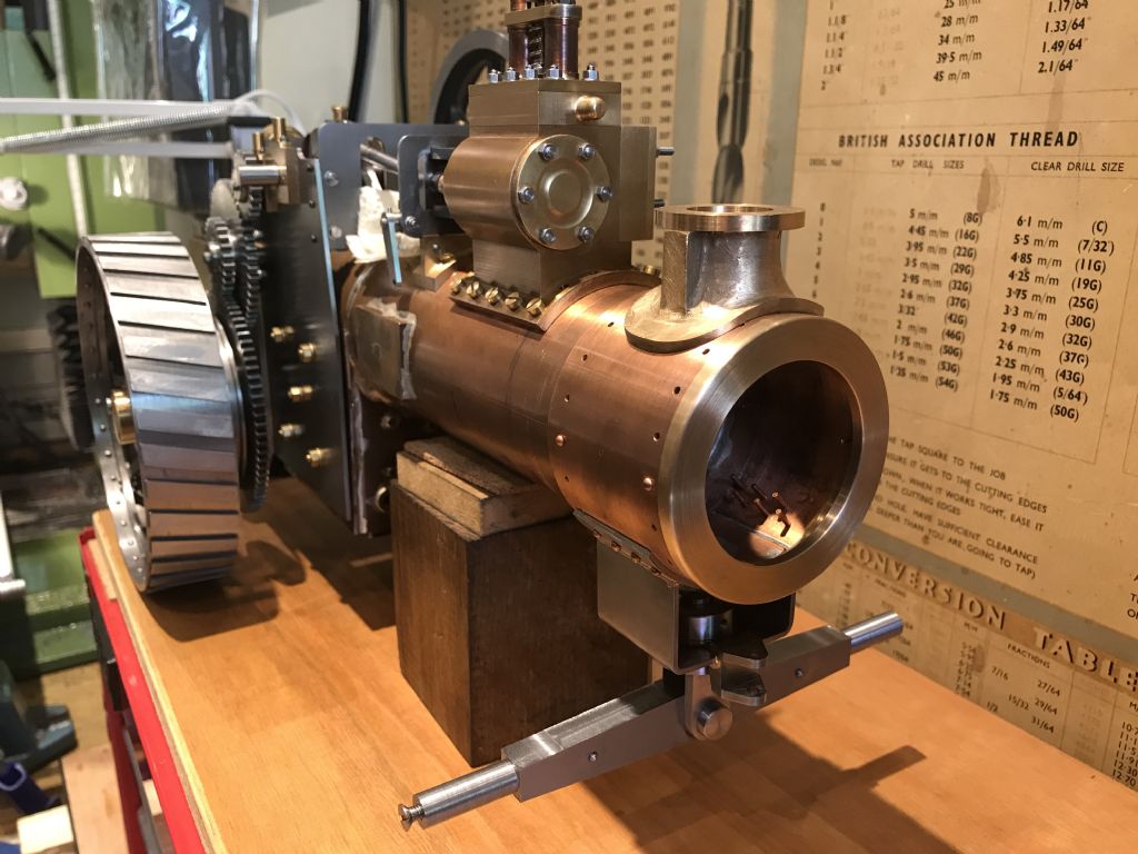

        Ive started on the front assembly, smokebox etc while i get brave enough to solder the boiler together.So far so good smokebox/ring/door chimney casting done and fitted and divided for the 1/16" rivets. Onto the steel section at bottom of smokebox which holds the front axle fork. Achieved a nice radius in the 1/16" steel to match smokebox od for the base of the box section under the smokebox. Onto the box section itself, made a nice radiused former to bend sheet mild steel over [compensated in width to bring the final width once formed to the 1" required]. Achieved a nice 90 degree bend in the sheet mild steel but not at the radius i filed, not far off but if i continued it would have made the component drastitically overwidth.
        Is this the minimum bend radius for 1/16" plate?
        Do i anneal the steel sheet? [ [i know this is not as easy to do as sheet copper or brass]
        Do i measure radius formed with a radius gauge and edit the former accordingly?
        thanks

                So what would you suggest for the axle fork box under the smokebox? Edit the radius for bigger on the former accordingly,or anneal the 1/16" steel to try and match the formers existing smaller radius?
                Thanks
                James
                #456474
                Brian Abbott
                  @brianabbott67793
                  Hi James.
                  I just bent the 1/16 plate in a vice between two blocks, then soldered to the curved section.
                  No real point annealing as it doesn't make a great any difference with mild steel.

                  #456479
                  james huxstep
                    @jameshuxstep40895
                    Very nice!
                    In the vice between two blocks of steel,or wood?
                    Thanks
                    James
                    #456481
                    Brian Abbott
                      @brianabbott67793
                      Two blocks of steel, just in the vice, I had to overhang the edge of the vice for the second bend.
                      Just file a radius on the block and tap it round.
                      #456494
                      james huxstep
                        @jameshuxstep40895
                        Cheers mate,I'll give that a try. I'll keep you posted
                        Thanks
                        James
                        #456646
                        james huxstep
                          @jameshuxstep40895
                          Well success!
                          Talk about making things harder than they need to be.A few encouragements with a rubber hammer using the steel in the vice plan, worked a trick.
                          Thanks for all your help guys!
                          james
                          #456659
                          Brian Abbott
                            @brianabbott67793
                            Sometimes we overthink these things.
                            Good luck with the build.

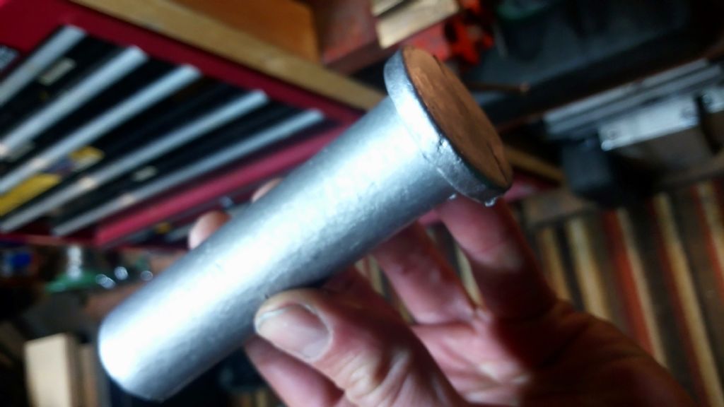

                                    Any ideas on how to turn the chimney casting? I get all the basic turning bits,its the whole centring it to run concentric with the inner bore. The book suggests making plugs for either end but my ally casting does not have any holes in either end.
                                    Also how's best to turn aluminum?
                                    Thanks
                                    James
                                    #460839
                                      The wooden plugs are only to fill the holes so you can mark out the ends. Post a photo of your casting and I'll suggest a way forward as you will have to bore it out from scratch.
                                      #460843

                                            I think I would start by lightly filing the top end to give a flat surface for marking out on, swing 4 arcs of approx half the diameter in from points around the edge and then place a punch mark where the middle is likely to be much like whats shown in this image
                                            Now holding the casting by the flange in the 4 jaw chuck get the bottom and top punch mark to run as true as possible then at a slow speed drill with a ctr drill. Bring up the tailstock for support and turn the top parallel section to 1 1/16" and lightly face the end as far in as you can reach without hitting the tailstock ctr.
                                            Reverse the casting around and now gripping by the top parallel section ctr drill the bottom end and again bring up the tailstock ctr for support. Face the end and then the outside of the flange followed by the 31/32" collar. Then taper turn the outside.
                                            Remove the tailstock and fit the fixed steady to run on the 31/32" diameter to support the casting while you drill it out to 3/4".
                                            Reverse the work once more so you are holding by the OD of the flange and set the fixed steady to run on the 1 1/16" top section. You can now bore out the inside to the correct taper.

                                              Thanks very much Jason,I'm half way through.so far so good.for the outside taper do I match the castings existing taper,or do I work it out from the drawings?
                                              Thanks again
                                              James
                                              #461190
                                                I'd work it out from the drawings and then see how that compared to the casting and adjust if you need to.
                                                #461935
                                                james huxstep
                                                  @jameshuxstep40895
                                                  ok, thanks jason, that went pretty well.There is a couple of small holes in the casting i found whilst machining but otherwise all good.
