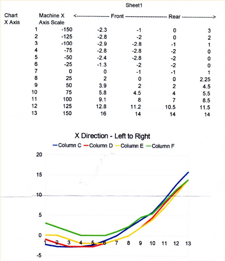

      I’d like some thoughts on a problem I think I have with my 2008 Warco MiniMill. In brief, I think I have a problem with flatness of the table and would welcome thoughts on how to prove it further and/or what to do to it. I have thoughts of my own which I will put in as I go through.
      At this point it is worth pointing out that I am well aware of the problems associated with Chinese machinery, but would like to improve it if possible.
      Above is a table of readings, and the resultant graphs. I have done this twice on two separate days and although the actual readings differ, probably due to different postioning of the dti, the graphs are for all practical purposes identical.
      Here is what I did.
      I mounted a plunger type dti with its spindle almost exactly under, and in line with the machine spindle. The head, and hence dti, were lowered onto the table to show about 2mm deflection. (I do not think that the actual deflection matters.)
      The table was then moved to one end of the X travel and readings on the dti then taken every 25mm for the full length of the available travel.
      The table was then moved in the Y direction to place the dti on another of the four ground rails making up the table top, and the measurement exercise repeated. Note that when moving the table in the Y direction, rather than move the actual milling head, I lifted the dti spindle by hand when crossing the slots in the table. I did this because I thought that moving the head would result in loss of vertical positioning and hence loss of measurement accuracy.
      In the data table above, column 1 refers to the X numbers on the graph. Column 2 is the actual measurement scale on the front of the X axis of the table. As you will see, this150mm – 0 – 150mm. Columns 3 to 6 are the readings taken on the dti and are effectively plus/minus zero, where zero was actually 2mm. (Hope that makes sense.) Finally column 3 is the rail nearest the operator/front whilst column 6 is the rail farthest away, ie nearest the machine vertical column.
      As you will notice, there is a large deflection at the right hand side and a much smaller one at the left hand side.
      Obviously, the question is where is the discrepancy?
      Is the table out of truth? As far as I can tell without an accurate known straight edge, it does appear to be.
      Is it possible that the table is designed to be concave to allow for bending when subjected to weight? But considering that the measurements were taken at a point where the table is fully supported underneath this does not seem realistic.
      Could it be that the actual dovetail slides are wrong? In this context, please note that David White some time ago bought an X-Y table and promptly used lapping powder to improve the slideways. It is my intention to do the same as some of the slideways frankly look to have been carved out with an angle grinder.
      It seems to me that what I need to do is to firstly make new gib strips as the originals have triangular depressions in them as caused by a drill bit which has not started to cut correctly. The new gib will be fitted with 4mm ball bearings on the end of the adjustment screws.
      Secondly, to lap the slides as per David White.
      Thirdly, to skip the top in situ using a high speed TCT cutter.
      Another comment is that I think the table also tilts in the Y or back to front direction, but that could be that the head requires shimming.
      Ok, comments please.

          I wonder if the table is tilting. Replacing the gib strip sounds a good idea. While you are at it look at the dovetail on the other side. It has been known for the “point” to be too sharp and not allow the proper surfaces to mate.

            For some months I also had a suspicion (like Yours) about my milling machine, an Optimum BF20.
            A few days ago, when working on a important part of my shaper I decided to use my recently made tram tool (yes, one that uses two DTI) to test it and also to tram my milling machine and finally know if it has a problem or not.
            So I trammed the milling machine and by the way, even knowing I can do the same without the tram tool, I could do a quicker operation with the new tool.
            At this point I must say I used to test the alignment of the table using an articulated arm to support the DTI with a magnetic base attached to the metal bench board underneath the milling machine. And I found that the side where the table stood up was the side opposite to that where the magnetic base of DTI support stand.
            After the tram of the milling head and not finding any reason to explain the difference of about 0.10mm I decided to use another support and magnetic base for the DTI, which being shorter, couldn’t be attached to the same board. Instead I had to fix it to the metal face of the column (which is rectangular) of the milling machine.
            Surprise, surprise…: the table was perfectly flat. The explanation I find is that the weight of the table when it is coming more to one side slightly distorts the board on the other side. Ant with it goes the DTI…
            Perhaps there is another explanation but by now I can’t find …

              All my measuring was from the mill spindle itself. I had wondered about trying it from the metal bench it sits on, but your report makes me think it is a bad idea.
              In respect of tramming, I only have a single dti, and yes I have seen the double dti tool and even considered making it. My tramming was done from the spindle itself, that is with an adaptor in a collet which in turn is tightened into the spindle. The dti is then fastened to the adaptor on a long arm so that I can swing it from side to side. The table testing was done using the same spindle adaptor, but with an attachment that allowed the dti spindle to be aligned with and under the machine spindle.
              Graham,
              Sorry for the misleading lack of info. It is the old thing, I know what I mean and I subconciously think you know what I mean as well. Anyway, the reading -2.3 actually means 0.023mm less than the zero (2mm) position. In effect, I use the 2mm loading on the dti as a pseudo zero and then measure + and – from that. So -2.3 is actually 2.00-0.023 = 1.977mm. A minus reading means then that the dti is reading less which means that that part of the table is lower than the zero or 2mm position, whilst a plus reading means that the dti is reading more which means that the table is higher than the pseudo zero point.
              The mill is the Warco MiniMill, which is an X2 clone. (Warco will hang me for saying that as it is actually made by Real Bull.) I do not have a known good 12″ steel rule: perhaps something for Harrogate. I do have issues with Rabone and Chesterman as I have one of their 6″/150mm rules which is noticeably out on the metric scale compared to another 5 cheap rules, and I find it rather difficult to believe that all 5 , or is it 6, rules are incorrect whilst the one Rabone & Chesterman is correct. Strangely, the imperial scales all agree. Rather than use Silver Steel, I did wonder about PGMS, or more likely, a length of gauge plate since that appears to be ground to specific limits. Another possibility may be to use three lengths of ms flat and grind one edge of each piece together using valve grinding paste in a similar fashion to making surface plates.
              I do not think that the gibs are slack, but then as I have no other engineering experience, I have nothing to compare against. To adjust them, I generally nip them up until I can no longer detect any sideways movement of the moving slide at either end of fixed slide, whilst ensuring that the slide can move easily without binding. I also use Rocol Slideway spray. Since I detect movement by feel, I suppose it is possible that they may be on the slack side.
              The reradings were taken with loose locks. Tomorrow I will repeat the tests but this time locking all slides for each test.

                I have a similar mill XJxx12 on the bench for conversion to CNC. This mill has had no serious use other than cutting a bit of delrin. I have repeated your X axis test and find that the table is within 0.005 mm +/- over the full 300mm traverse. The same result is obtained using either the rear edge of the table or the front edge. The gibs are adjusted on the light side and are as supplied. I have verified the tram for both X and Y and my sample is OK.
                May I suggest you start by verifying that the tilt adjustment on the mast is set correctly. The general shift in your graphs would indicate that the mast requires tramming. The Z – X plane is most readily adjusted via that big nut on the back of the machine having first removed the locating pin. Take care as the mast is heavy and can topple out of control. A rope to the ceiling is good if you can arrange such a thing in the interest of safety.
                I also suggest that the gibs are not the main contributor to your problem until you start to do some cutting.
                Correcting the tram with the curves you have plotted should end you up with something of the order of 0.02mm +/- on the X over the 300 mm travel and 0.01 or better over the shorter Y traverse.
                Tramming (adjusting the mast to be at right angles to the table) details for the X2 are available on the web. Ask if you can’t find them.
                Hope this helps – Regards Pat

                    I do not think poor tramming would influence these results. The only time the Z axis is moved during these tests is to bring the DTI in contact with the table so the Z axis not being perpendicular to the X and Y axis would not matter.
                    Les.

                      I still think Peter’s main problem is with tramming as the figures he has posted indicate he has a table that is higher at one end than the other. (There are also some other problems evidenced in the figures but the mast being out of square to the X axis is the worst.)
                      These mills have a mast that can be pivoted to achieve inclined machined surfaces. The figures and curves indicate the right hand end of the table is some 10 to 15 mm high. Tramming will correct this and from the curve shape he should then expect to find a traversing error of +/- 1mm or less. It is difficult to estimate this with out printing the curve but it should be of this order.
                      Try thinking of the machining a wedge on this mill and you will see what I am trying to describe. However I might be wrong but having seen this problem with the tilting mast mills before I might be jumping the gun as I hate the reduction in rigidity introduced by the mast pivot. The Warco / Red Bull has more metal and some better machining than some of the other X2 designs but it is still a weak point.
                      Hope this explains my reasoning – regards Pat

                        Sorry I now see what you are saying Les. Yes Les is right this is not a tramming issue.
                        Peter please ignore my posts about checking the tram. My error in getting my pet hate with the mast pivot as the cause of the tilt to the curves yo have plotted Peter.
                        The lack of squareness is with the motion of the X axis with respect to the table top not with respect to the mast.
                        The central casting of the crossed ways would be my hunch as to where the error is. Check that the dove tails are properly seated – clean and free from raised dings or crud. Someone else has pointed out the need for clearance at the base of the dove tail on the non gib side. The size of the discrepancy / foreign body you are looking for is the equivalent of about 3mm as seen at the cross slides I calculate form the apparent skew of the curves.

                          Tramming, or rather a slight lack of it, was how I originally came to the conclusion there was something wrong. I then set the tram to try to achieve a balance, although not too well perhaps.
                          This does suggest another avenue to explore, ie to reset the tram to balance the L-R using just one of the rails. (Incidently, what is the correct name for the rails?) Then repeating the tests.
                          Graham,
                          This machine has two handwheels on this slide, however I only ever use the right hand side one. Partly because I am mainly right handed, but also because it is more convenient as I can stand at that end.
                          All readings are taken the same way, although not necessarily in the same direction of travel. Reading 1 is when the table is at extreme right hand position. Reading 13 is taken when the table is at extreme left hand position. In other words, Reading 13 is taken when the right hand hand-wheel (and associated components) are almost hard up against the fixed portion of the slide.
                          Now then, the brain cells have started working. This means that the weight of the slide is concentrated on the left hand side of the base structure, and this in turn will cause a tilting effect with the LHS trying to move down, and the RHS thus trying to move up – which is exactly what the readings are saying. This could also be happening at the other extreme because the graphs are tending to show this. Which could possibly be slack gibs.
                          Hmm, lots more testing to do.

                                  Looked at the slides with the aid of a mirror and light. I did not want to dismantle without carrying out the test detailed below first. Noticed that one end of the gib was rubbing on the slide and has created a noticeable scratch on the surface. The other end was clear of the sliding surface.
                                  Mounted the magnetic dti holder on the bottom of the column, thus eliminating the column top and milling head, and set the dti approximately in line with the machine spindle. Repeated the tests. No real difference, ie still a large difference at the rhs.
                                  Then tried all the tests again but this time with both X & Y locked up tight for the measurement. Very slight difference as the X lock was activated, but overall no real difference.
                                  Removed the leadscrew and all its bits and pieces. Then tried pushing the table back and forth. Quite difficult to get started but then generally easy once moving. Checked for gib slackness with the table at each end of the travel. With the table to the right, there was no discernable slackness, whilst at the other end, there was a small amount of slack. A slight adjustment has eliminated most of the slack, and the table still moves back and forth under manual pressure.
                                  Also under this condition, although the dti was not moved (as far as I know), the actual readings were different, but the overall effect was the same of the rhs being high by about 0.25mm and as the graphs showed, the majority of the movement is at the rhs end, ie when the table is moving towards the left. To me, this indicates that there is some non-linearity somewhere.
                                  The slides and dovetail recesses all seem clean and oily – no bits sticking up. No dirt in the recesses.
                                  The Y slide is quite tight, however I will recheck this because there is the possibility that the handwheel adjustment may be overtight.
                                  I am now attempting to determine by means of an accurate straight edge whether or not the table and/or the dovetails are twisted or warped. This has been made more complicated by my discovery that one of my so-called surface plates, a granite table thingy bought following a recommendation on an early thread on this forum, is actually hollow. It does seem that my scratched glass plate may be flat and that an unused ruler out of a cheapish combination set (see thread elsewhere on this forum) may be ok to use as a straight edge. More experimenting tomorrow after cutting the grass!
                                  Someone asked how much use this machine has had. Answer is “not much”. It is nearly three years old, but spent most of months 2 to 13 out of action because I managed to break the plastic gears within the first month. And it becomes too darned cold in my garage in winter. Since the repair, all it has done is to trim up a pair of aluminium 3-way angle plates and some small bits of steel milling – nothing at all strenuous.
                                  Gib screws are flat ended. In an edition of MEW some time ago, there was a comment that a round end, eg ball bearing, was the best method to use. As it happens, I have a quantity of 4mm balls looking for a home and my intention is to make new gibs and make new screws complete with ball ends. However, to make new gibs requires me to create an angled surface, which requires something like a milling machine. Bit like the “There’s hole in my bucket” song. But now that I know I have problems, I can probably mill them using the better end of the table.
                                  Dovetail angle. Yet another problem to sort out. My initial measuring of the existing gibs suggests 62° which seems an odd sort of value. Now that I have removed the table, I can have a go at measuring the dovetails properly. Incidently, if the gibs are 62°, and the dovetails 60°, this would explain why the gib is cutting into the dovetail.

                                        I sent the table to Brian Caddy of Slideway Services for regrinding. I have today received notification that it is now ready to be returned, along with the comment that this was one of the worst tables that he has ever had to regrind.
                                        Which suggests that all my testing was absolutely spot on.
                                        So it’s now down to a major rebuild of the machine, scraping and lapping the badly ground slides and making and fitting new gibs. I have done one so far, and taken the opportunity to a) fit locating pins as suggested by “Former Member” and b) fitted 4mm balls between the adjustment screws and the gib strip itself. In order to ensure that the dimples were correctly located, the gib was clamped to the main slide, a screw inserted with a 4mm hole down the centre, and a 4mm drill inserted to create a dimple sufficiently deep to take the ball. This predrilled screw was made in the lathe so the hole should be concentric with the thread.
                                        Unfortunately, this has lead to another problem in that the gib strip has to be in place before the two parts of the slide can be mated and this leads to other re-assembly problems. I think I can get round it, but if not, then it means that the locating pins may have to be screw-in instead of push-fit.
                                        Ah well, it all adds to the fun!
