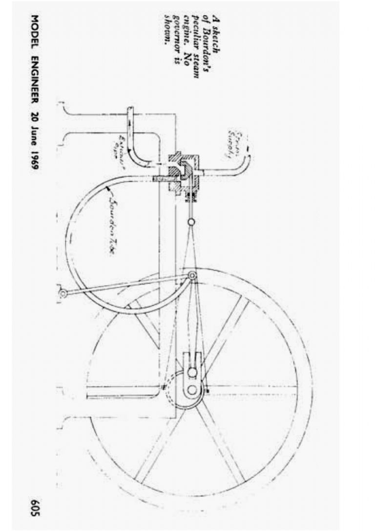

                            For anyone who wants to develop the Bourdon Engine design:
                            Here is a slightly tidier copy of the drawing in the PDF
                            Draughtsmen … Start your CAD packages

                                  There was a letter about an example of the above design in issue 3573 of 1977 and and up to date design in 4200 of 2003 by Colin Andrews.

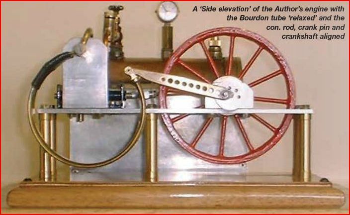

                                        From ME 4200
                                          Oh well … probably not worth bothering then.
                                          Edit: Just found this interesting variation on the theme:
                                          http://www.old-print.com/mas_assets/full2/J0261868/J0261868138.jpg
                                          Edit: I think Ian SC might have beaten me to it in a previous thread:
                                          http://www.model-engineer.co.uk/forums/postings.asp?th=101682&p=2
