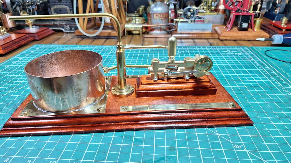

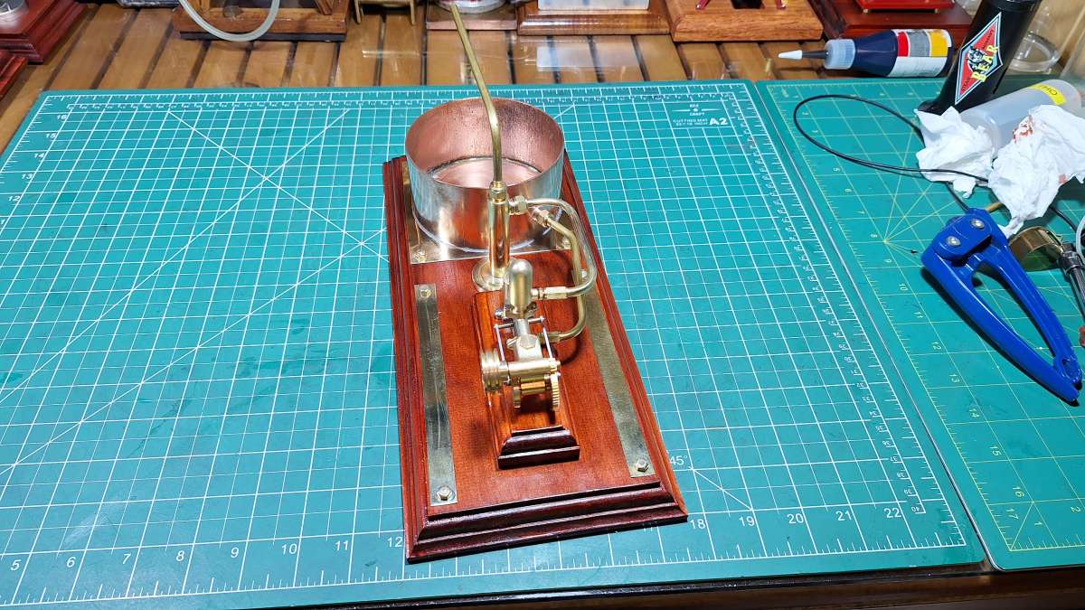

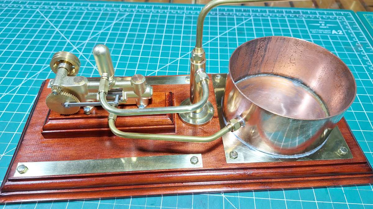

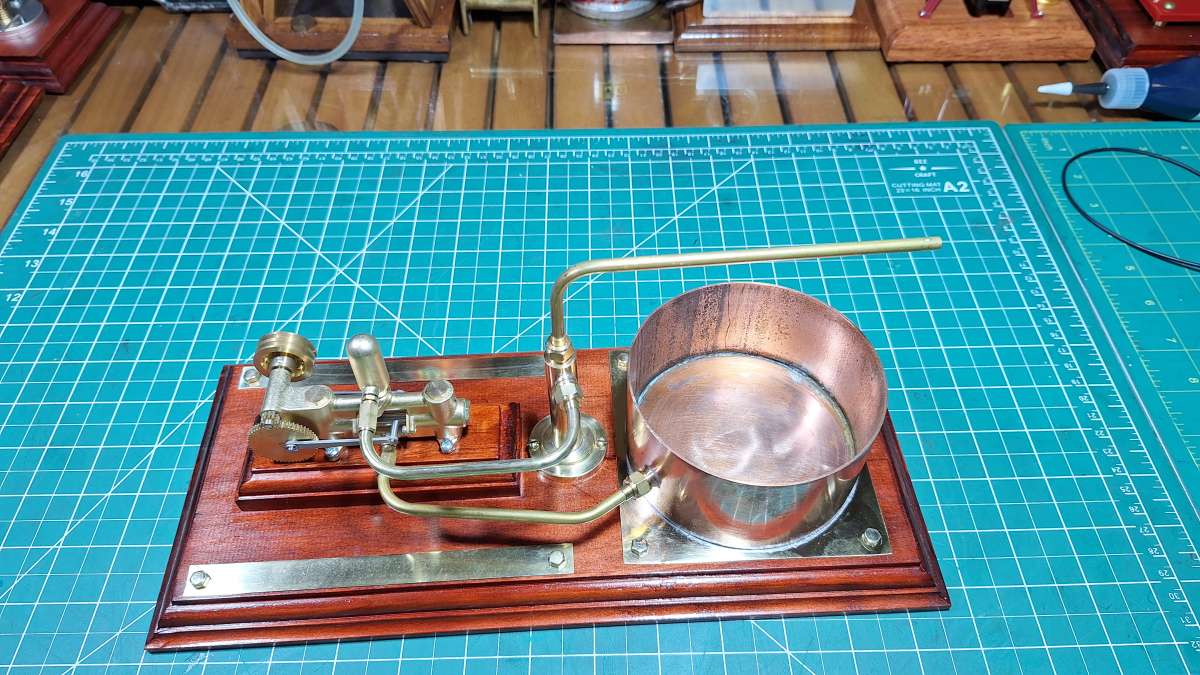

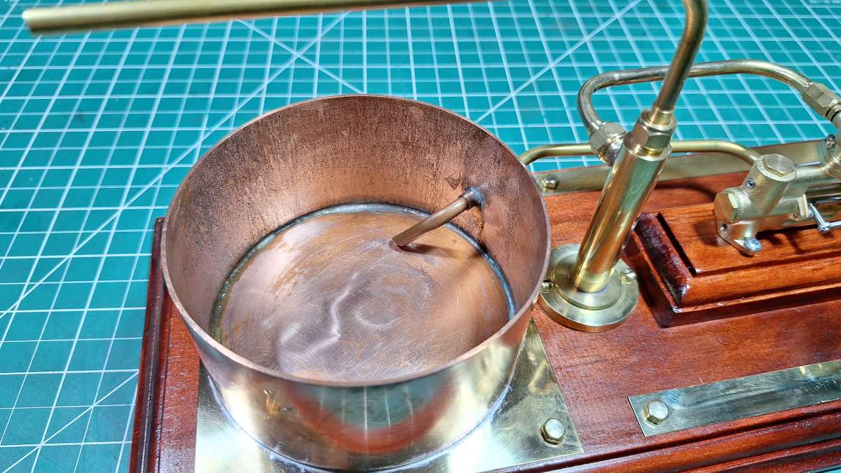

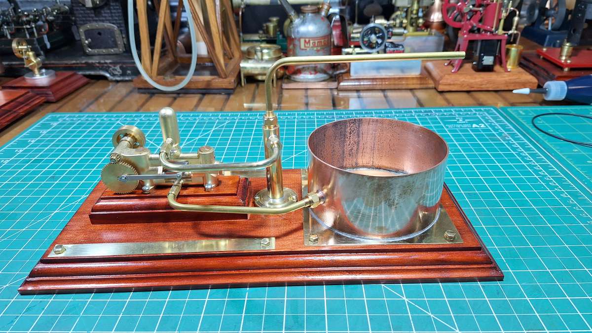

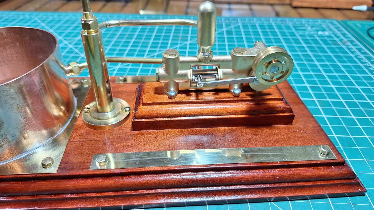

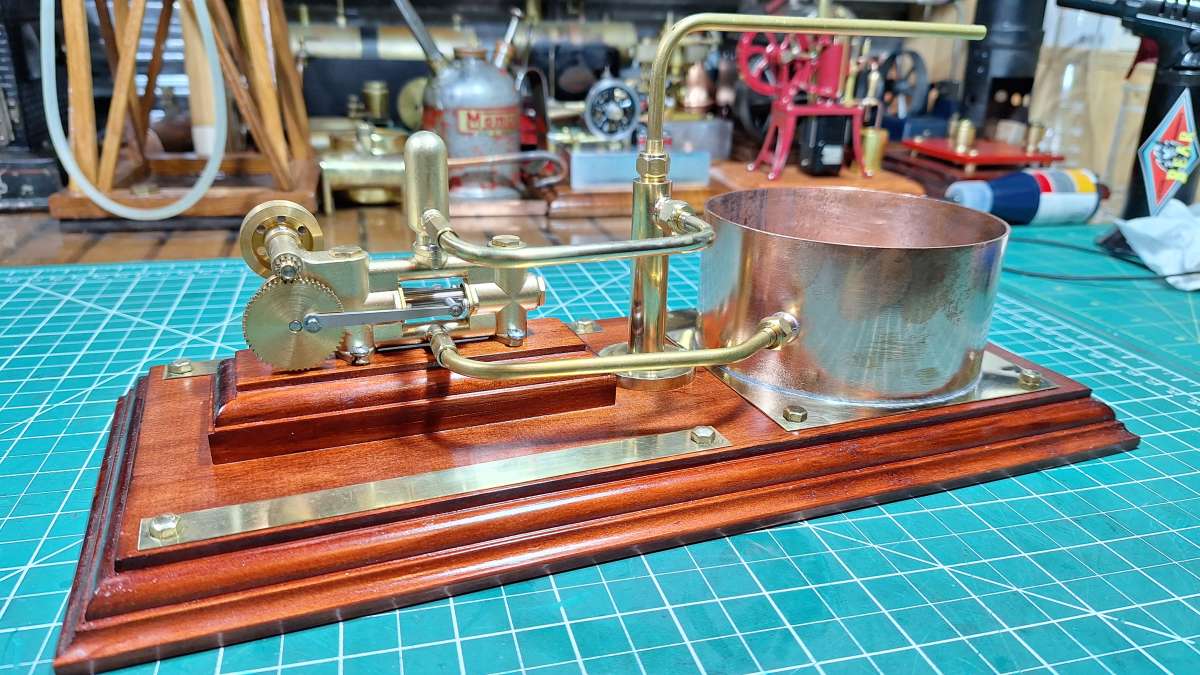

      have a lot of hours in this P71 pump from eBay, enjoyed every minute of making all the metal parts and woodworking.
      Only thing I haven’t done yet is bend and cut the return that will flow the water into the 4″ copper water trough as I’m still pondering a few ideas.
      I did toy with the idea of making a ‘shower rose’ but think because it won’t be pressurized it would still just dribble out in one stream.
      Anyone got any clever ideas before I cut and bend that brass pipe?

        Make a little bibcock tap rather than just have it come out of a pipe.

          For a reciprocating pump pressure is developed by any restriction in the outlet so if the showerhead holes are small enough the water should squirt. It should be quite easy to lash something up to test before committing your brass pipe.

            It has what looks like a pressure accumulator sticking up above the pump. To me the implication is that it is reasonable to have some restriction to flow and the accumulator will smooth the flow through that restriction. I would consider something like a miniature hose pipe nozzle that allows the flow to be a spray or a jet so you can experiment and see what works best.

                Restrict orifice and direct upwards for a fountain, or point sideways to drive a water-wheel*.   Find the size of the orifice by experimenting: it’s related to motor power and the receiver capacity, and it’s possible the latter is only ornamental.   Too small and the pump will stall; too big and the water won’t have any pressure behind it.  Try ⌀1.5mm and see how it goes.
