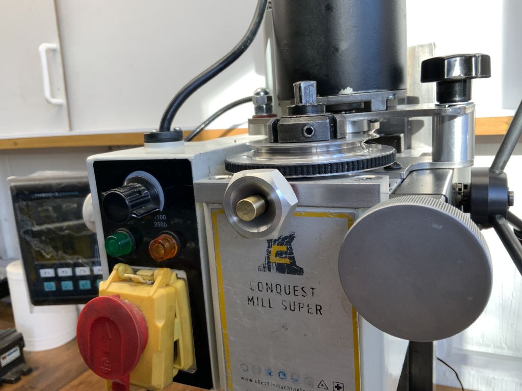

        Does anyone know anything about a Turkish supplier – http://www.mbbilici.com ? They advertise custom built belt drive kits for most mini-mills and the photographs of the parts look very good. Most of the other suppliers do not have kits available.

              Postscript – I bought the kit from Murat Bilgin BİLİCİ (mbbilici@mbbilici.com) in Turkey and I’m pleased with it. It arrived within a week, it fitted well and the machining is very good quality. The only issue I had was the design of the belt cover, it is adequate but could easily be improved, which I will do. Some photos attached without the cover for clarity.

              MikeK
                @mikek40713
                I have the Stirling Steele conversion kit (which I think was the original maker?) and the belt cover is a quickly-made bent piece of acrylic. Do post if you make a better one. Congrats on the belt drive, it's a wonderful upgrade.

                                        I don’t know the configuration of the Warco mills, the critical criteria are usually the diameters and keyway dimensions of the spindle and of the motor shaft. The maker of the kit I purchased does a kit for one Grizzly machine, he’s very helpful and modified his kit for my machine – no harm in contacting him: https://www.mbbilici.com/index.php?route=product/product&path=57&product_id=75
