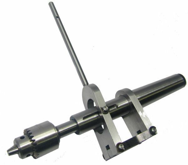

          Hopper
            @hopper
            And if you want more "feel" when drilling from the tailstock, make or buy a small lever-operated sensitive drilling attachment that plugs into the existing tailstock taper. There will be an article and drawings to make one come up in MEW at some point in the not too distant future.
