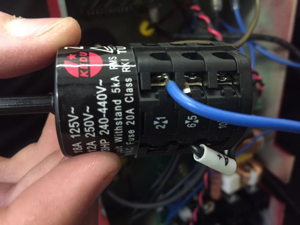

      However, and there's always one of those, now it's failed me. I have just replaced the spindle bearings on my Sieg C3 mini lathe. So the electronics box on the front had to be removed. Imagine my surprise when I realised that virtually ALL of the connections to the Forward/Off/Reverse switch, were not only loose, but in removing the box, had become disconnected. The F/O/R switch has something like 12 connections. I have had a good scratch around trying to find a wiring diagram that shows which wire goes to what numbered terminal. Some of the wiring diagrams show the non switch end of the wire, but no diagrams indicate which terminals they are supposed to connect to. Does anybody know of a wiring diagram which shows this level of detail??

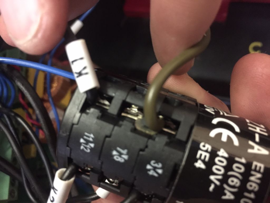

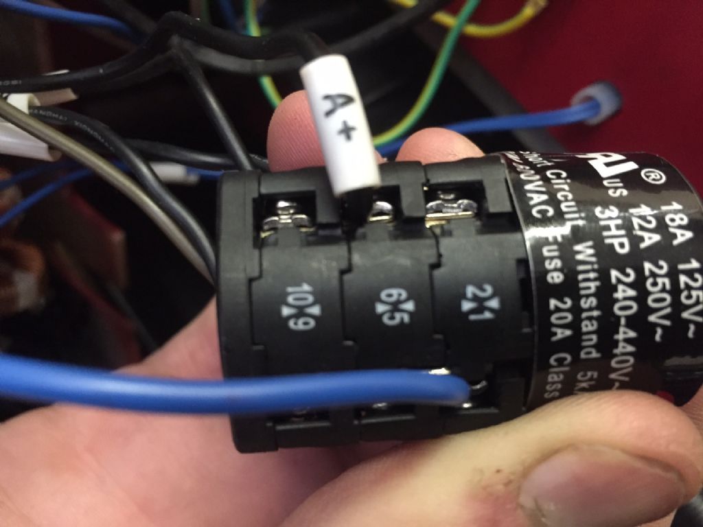

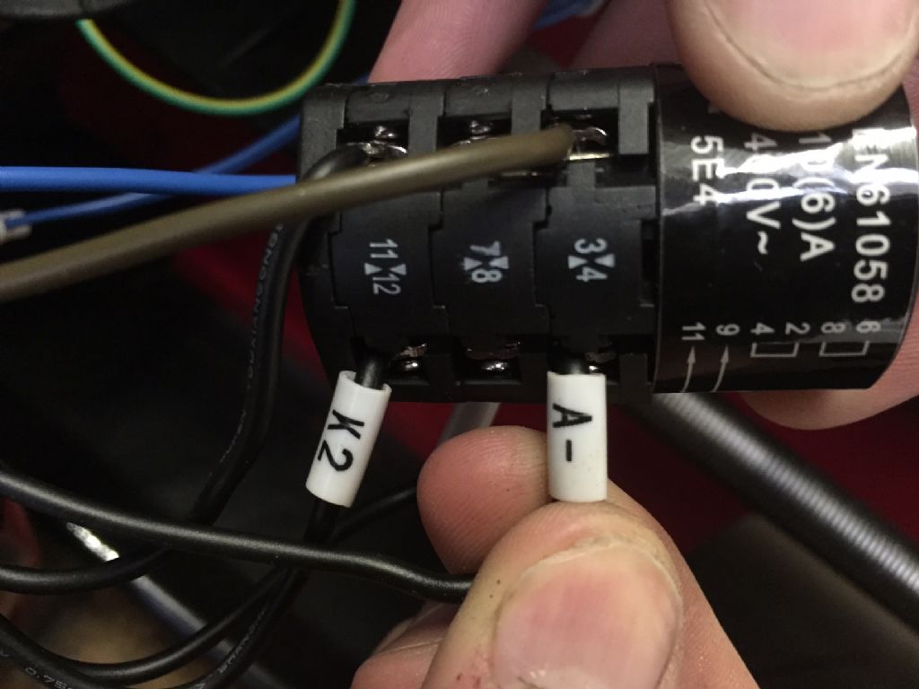

              Provided at least my presumption about the machine is correct, then here are some pictures below. I too am surprised that the wires just fell out. They are screw on terminals. There must have been a serious amount of vibration over time for this to happen. You better also check the other screw-on terminals too while you are at it.
              Ketan at ARC.

                  the wires K1 and K2 in Ketans photos are the interlock wires shown in the C3 manual
                  the problem with the motor an speed control board connections to the switch is not all connections are obvious
                  like the jumper between terminals 3 and 7
                  with some versions  rotary cam switches they have internal links so the two switches in each section are connected to form a SPDT switch
                  two of the SPDT elements will only need  two links as in the photo to control the motor direction

                      Thanks for the responses chaps. I'm in Australia. The machine is a Sieg C3, (180mm x 350mm, or 7" x 14" as the 'Mercans say). I've had it for about 10 years.
                      I had done several searches on the net, using things such as "Sieg C3 lathe wiring diagram". I found a fairly close one on the LMS site. In fact it's pictorially identical to the one in the manual I have, but most of the component and termination idents are different, both diagram to diagram, and either diagram to physical item!! Nowhere are the switch terminations identified!!
                      Thank you Ketan, that switch looks to be identical to the one that is on my machine. I will print this page and do some more re-assembly work. I usually do make a sketch, prior to disassembly, sadly in this case the disassembly work seems to have been semi automatic!! I'm not sure how it happened, the F/O/R switch is about the only part of the machine that has caused a problem. The original one failed after about two weeks (i.e.about 518 weeks ago), was promptly replaced by the supplier, and fitted by me. So the auto disassembly looks as if it's down to me!! I think I must have prepared a sketch to show the connections way back then. Sadly lost now.

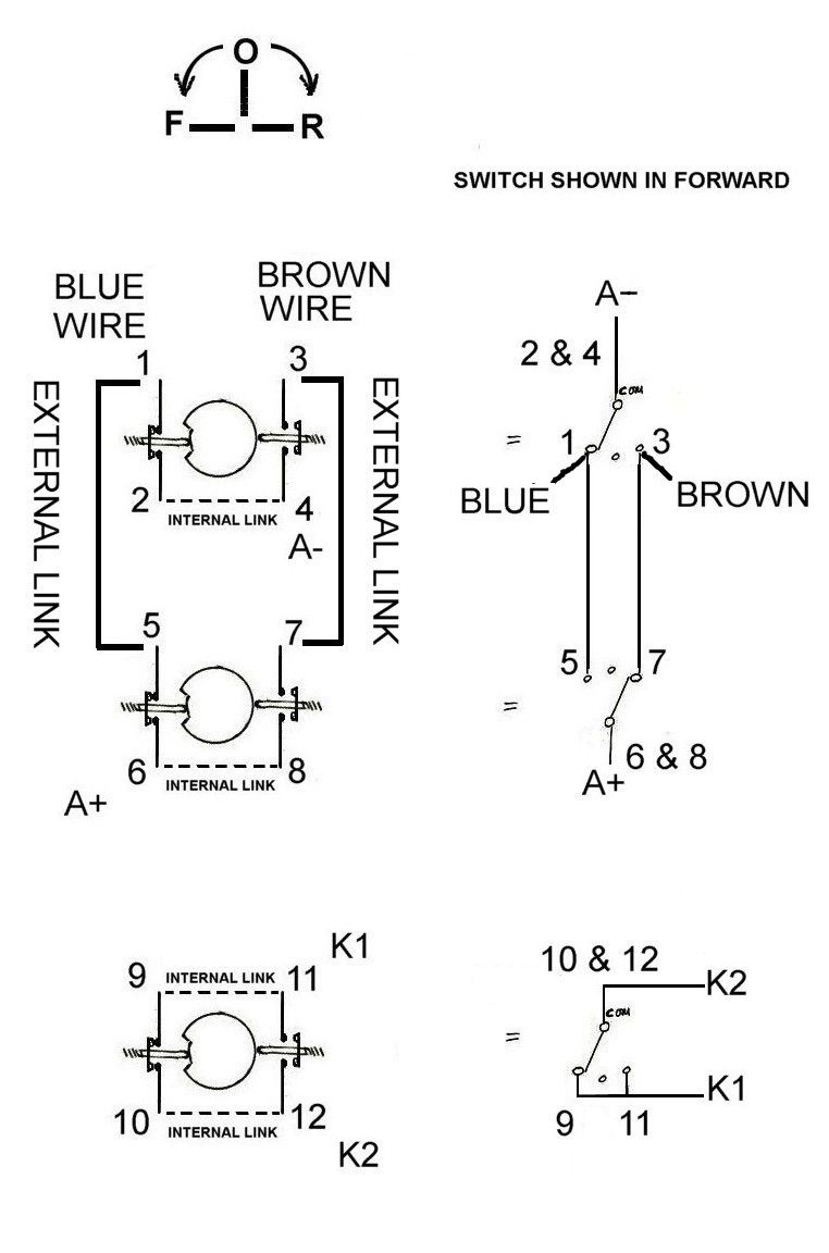

                        based on Ketan's photos of the switch
                        I've made a sketch of how I expect the switch contacts to interconnected
                        Edited By john swift 1 on 16/10/2015 01:03:19

                          Well there's good news and bad news. The good news is that I connected up the F/O/R switch i.a.w. Ketans photos, and it worked!!
                          Triffic
                          The bad news is that there is now an intermittent fault. Sometimes, well most times, it will not run "forward". After I've had a cup of coffee I shall go and recheck everything.

                          #208054
                          Bill Pudney
                            @billpudney37759
                            Now it all seems to be good. The intermittent fault seems to have been one of the spade connectors, that had to be "just so" to work. So it's up and running, at least it will be when the change gear bits have been reassembled.
